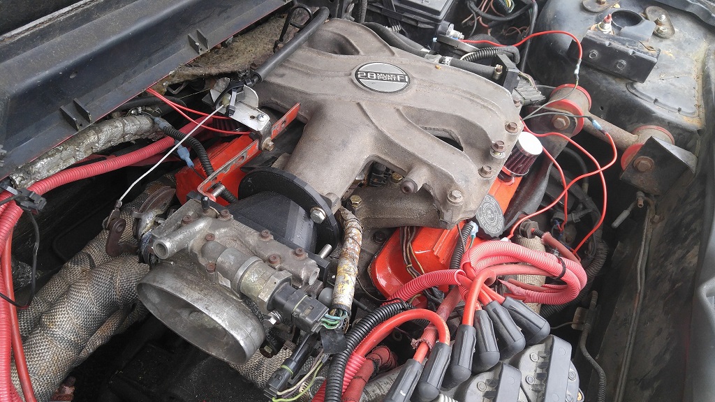

lou_dias
MAY 31, 06:08 PM
3D printed adapter...

Whats the diameter on the upper intake manifold inlet?

Just out of curiosity, why didn't you use a 60mm throttle body? Is there a particular reason for using the dual 42mm one instead?

| quote | Originally posted by La fiera: Whats the diameter on the upper intake manifold inlet? |
I had it bored to about 59.x mm
@Blacktree It's actually a dual 48mm. I got it cheap used some time ago and uses the same connectors at the Fiero harness. win-win
Blacktree
JUN 01, 09:20 AM
Makes sense. That's pretty much the same reason I went with the Buick GN throttle body. The bore is 59mm, and it uses OBD-1 electronics.
