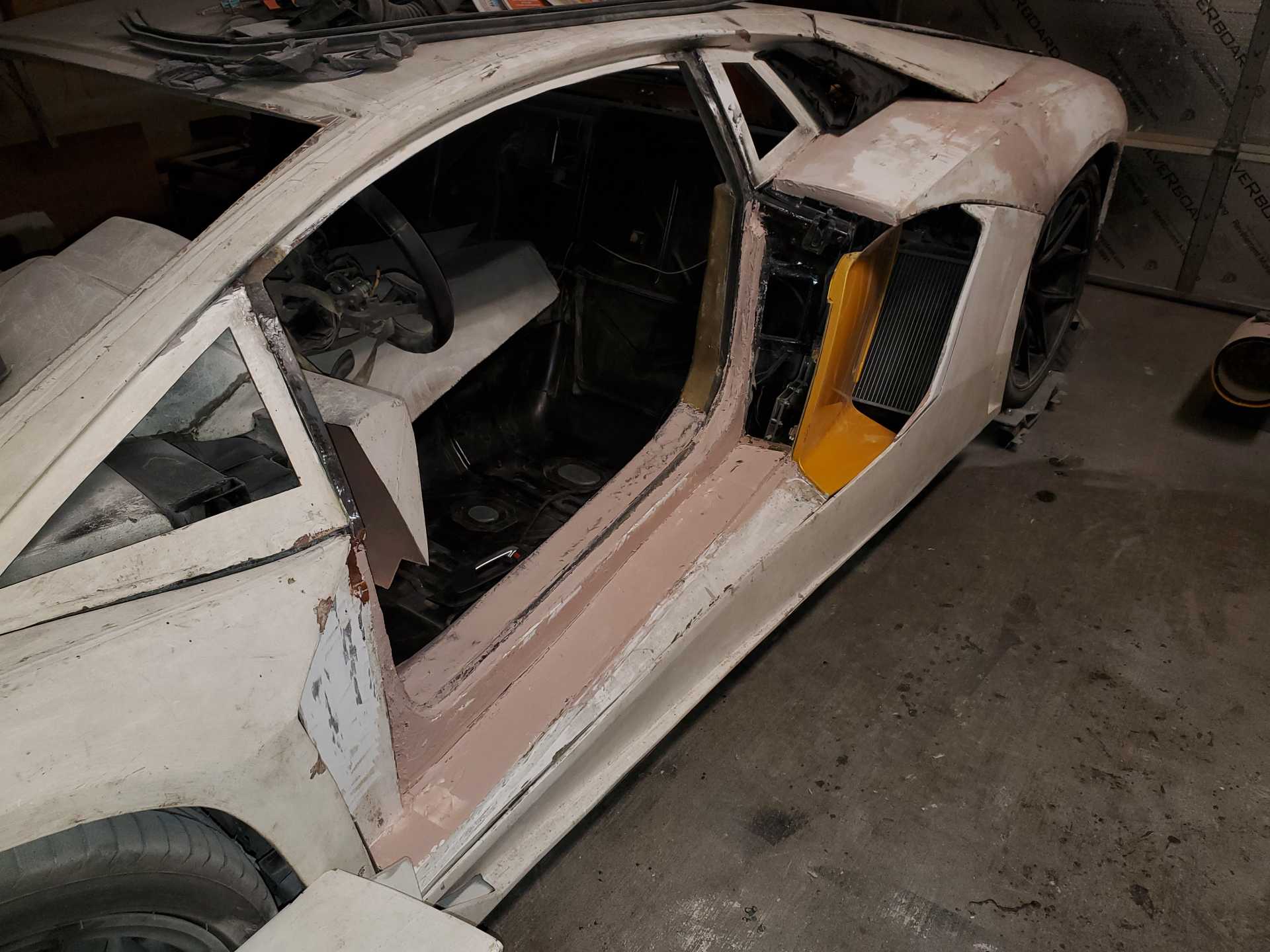

I now have almost all driver's side panels installed. I've also started to add some body filler just to give everything a more finished look. This helps me to make sure I'm not missing anything. I'll have to take some time to get the passenger's side paneling completed so I can finish all of the body work at the same time.

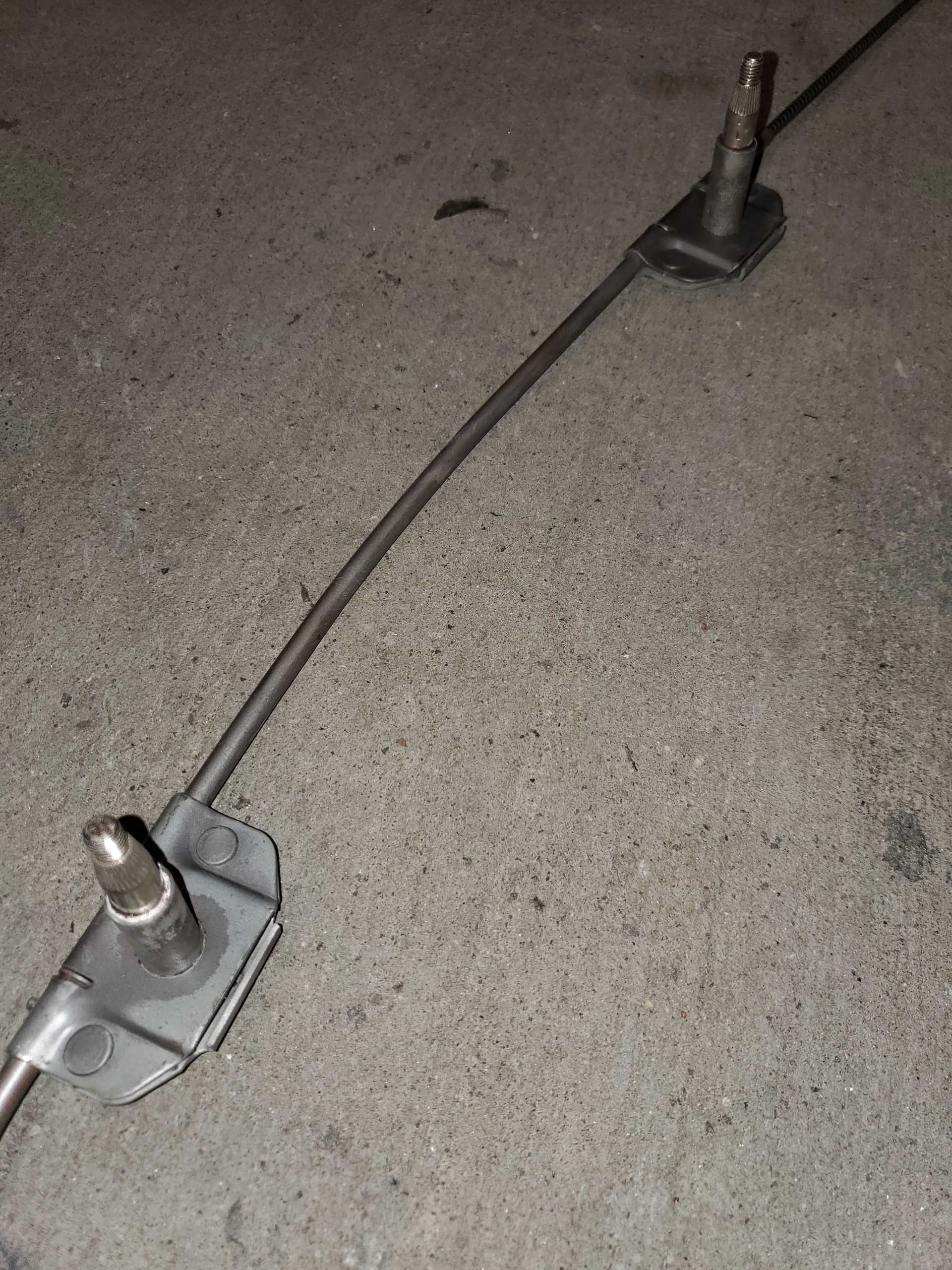

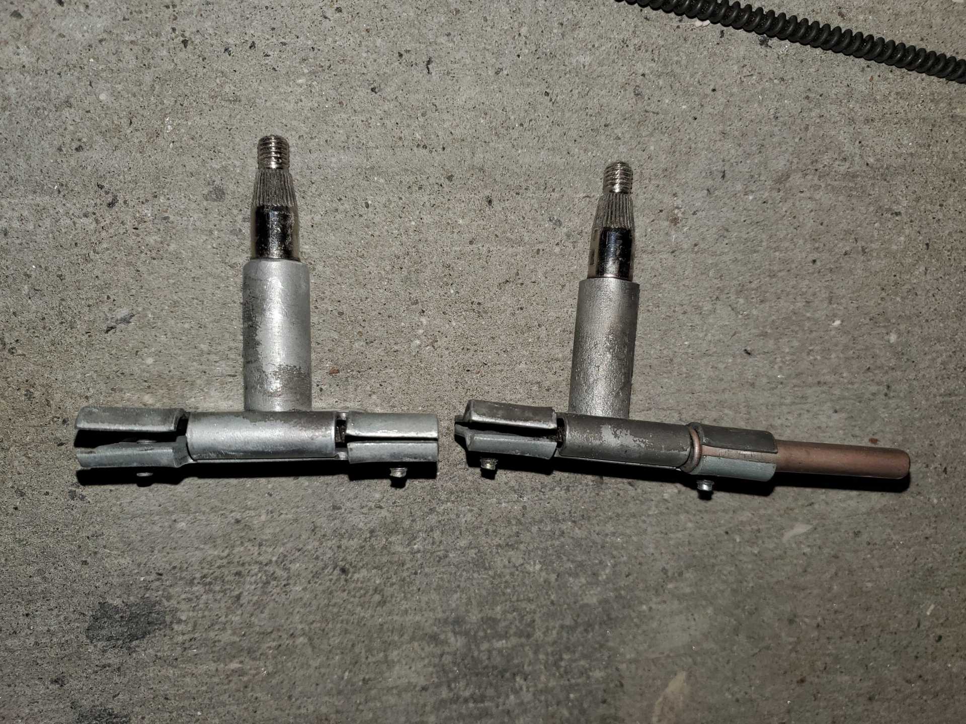

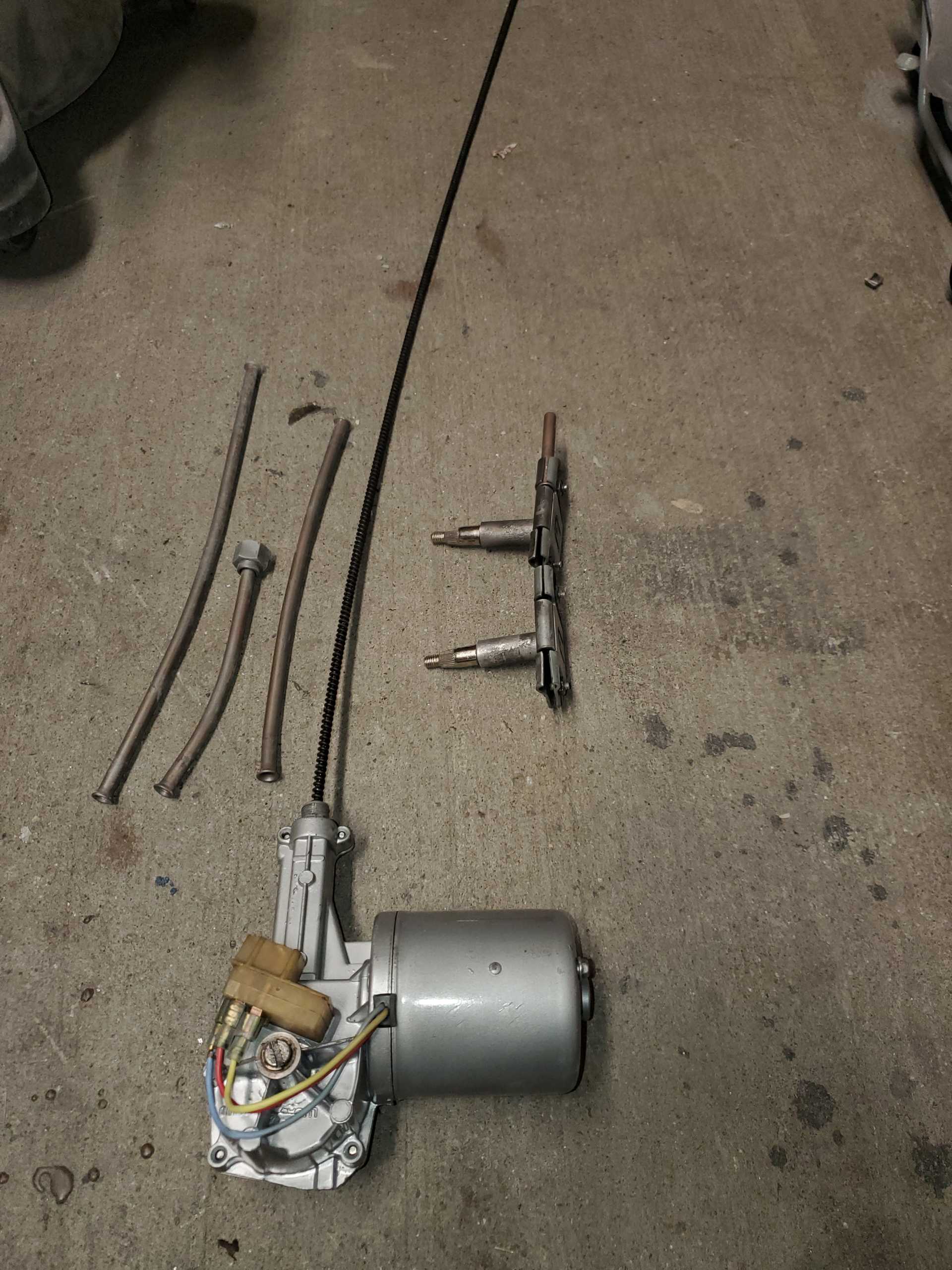

I've been taking a little time to work on the wiper system. I need to get this finished so that I can complete the fiberglassing at the bottom of the windshield. Originally, I had planned to utilize the stock Fiero wiper mechanism and the Fiero wiper arms, but quickly changed my mind due to the "whimpyness" of the Fiero arms. I looked around and couldn't find any mass produced wiper arms that were any better. I decided that I'd be better off using the OEM Aventador wiper arms, which I ended up buying quite cheaply. The Aventador wiper arms use the tapered spline posts. I picked up the complete wiper linkage system for an Audi A4 (with the tapered spline), with the hopes of cutting it up and creating a custom linkage. Unfortunately, I quickly found out that there just wasn't the room for any type of traditional bar linkage. However, I was able to get a complete remanufactured wiper system for an MGB, which uses a cable drive instead of a bar linkage. I did have to modify the posts from the standard straight spline to the tapered spline, but this proved to be relatively simple. This system is great! It fits in place even with almost no room. The cable moves back and forth, driving the posts via gears that are attached to the bottom of each post.
