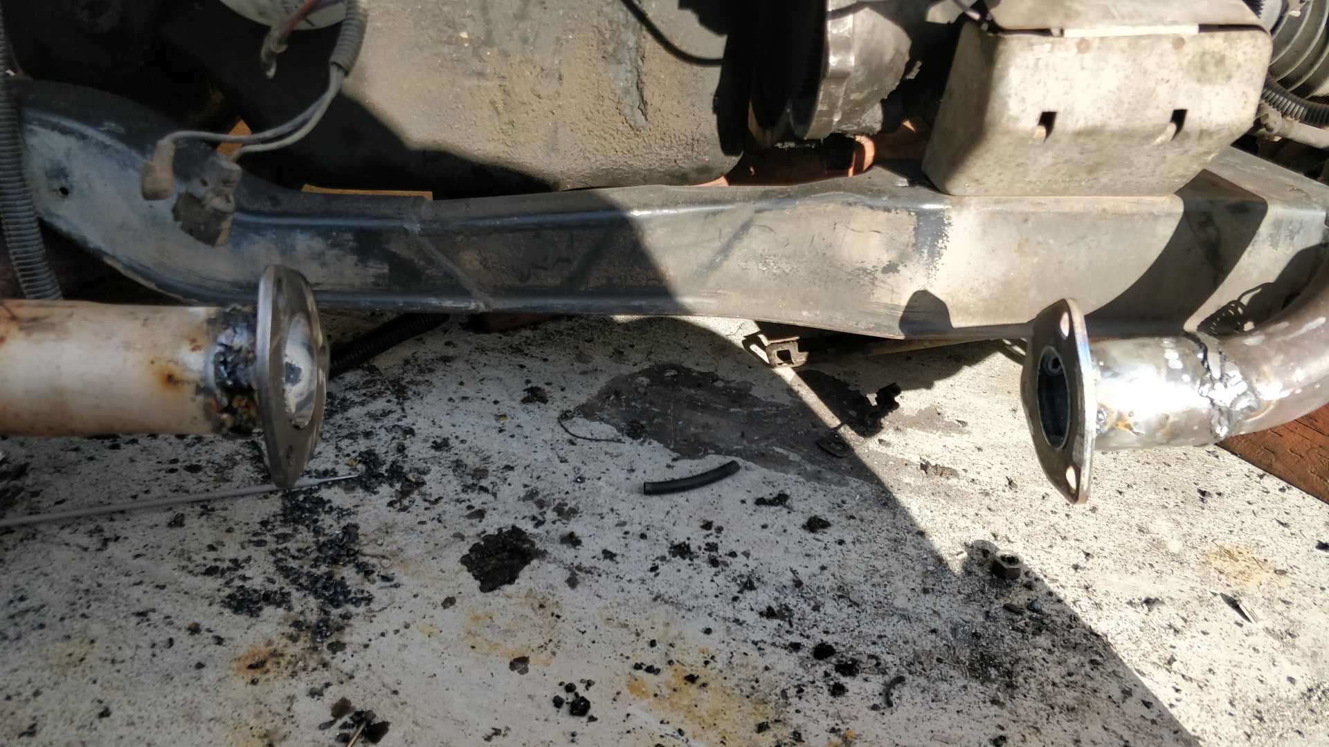

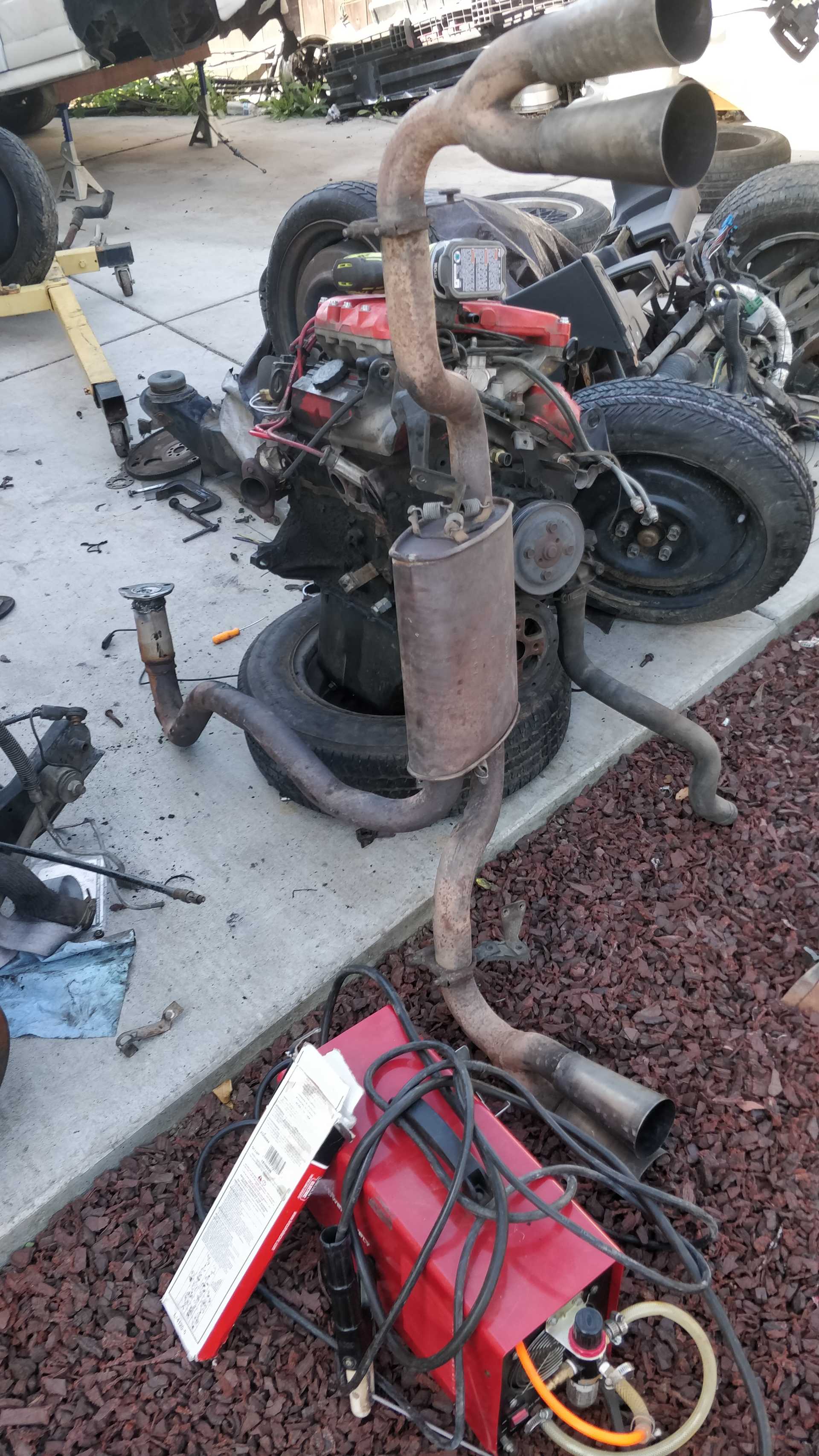

Im not the best welder in the world. Throw some rusty old stainless into the mix and its not good. However I tend to get things mostly sealed.

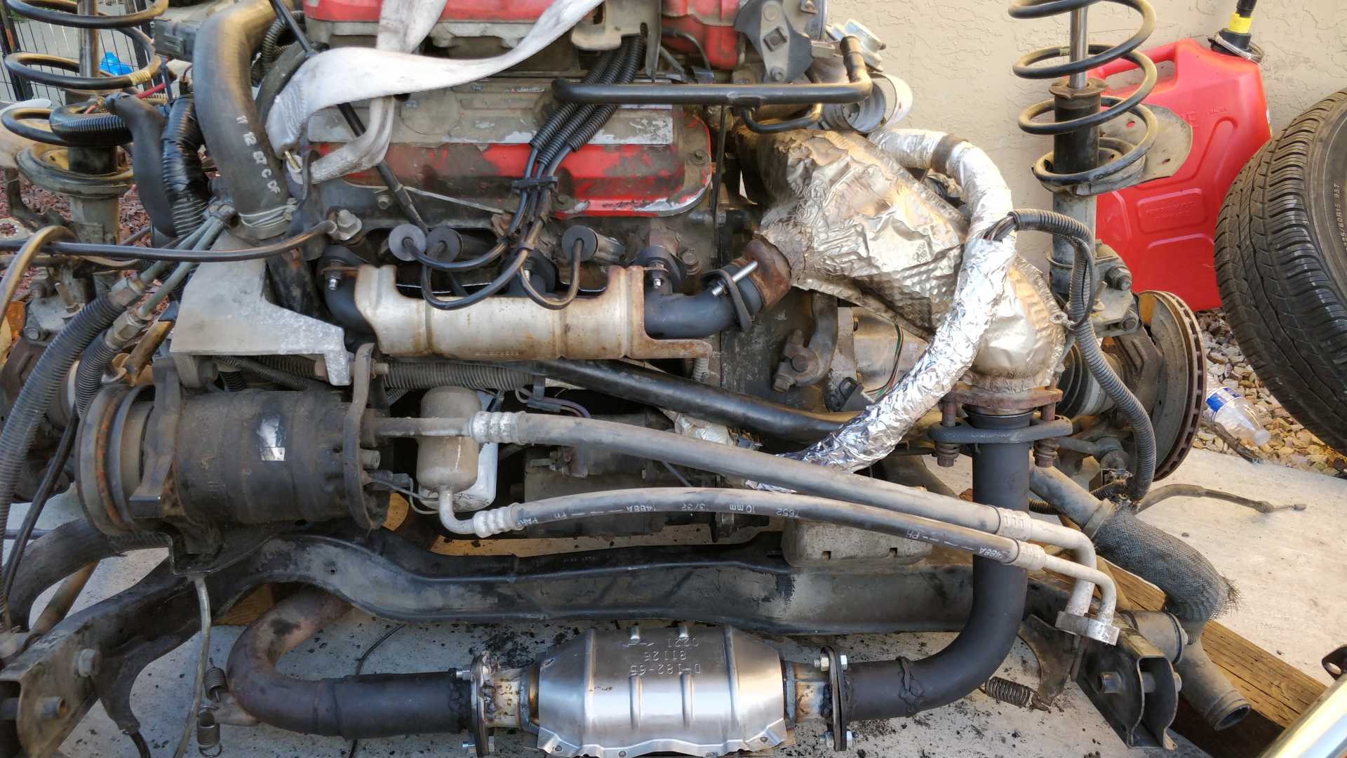

I welded in this repair tube. I trapped the flanges in there so once the one side was welded I could weld the flanges and cut off what will eventually become my test pipe. I put the new cat in for measurement.

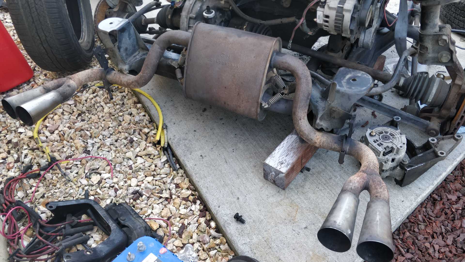

I pulled the Exhaust so that i could get better access to the spots i need to weld.

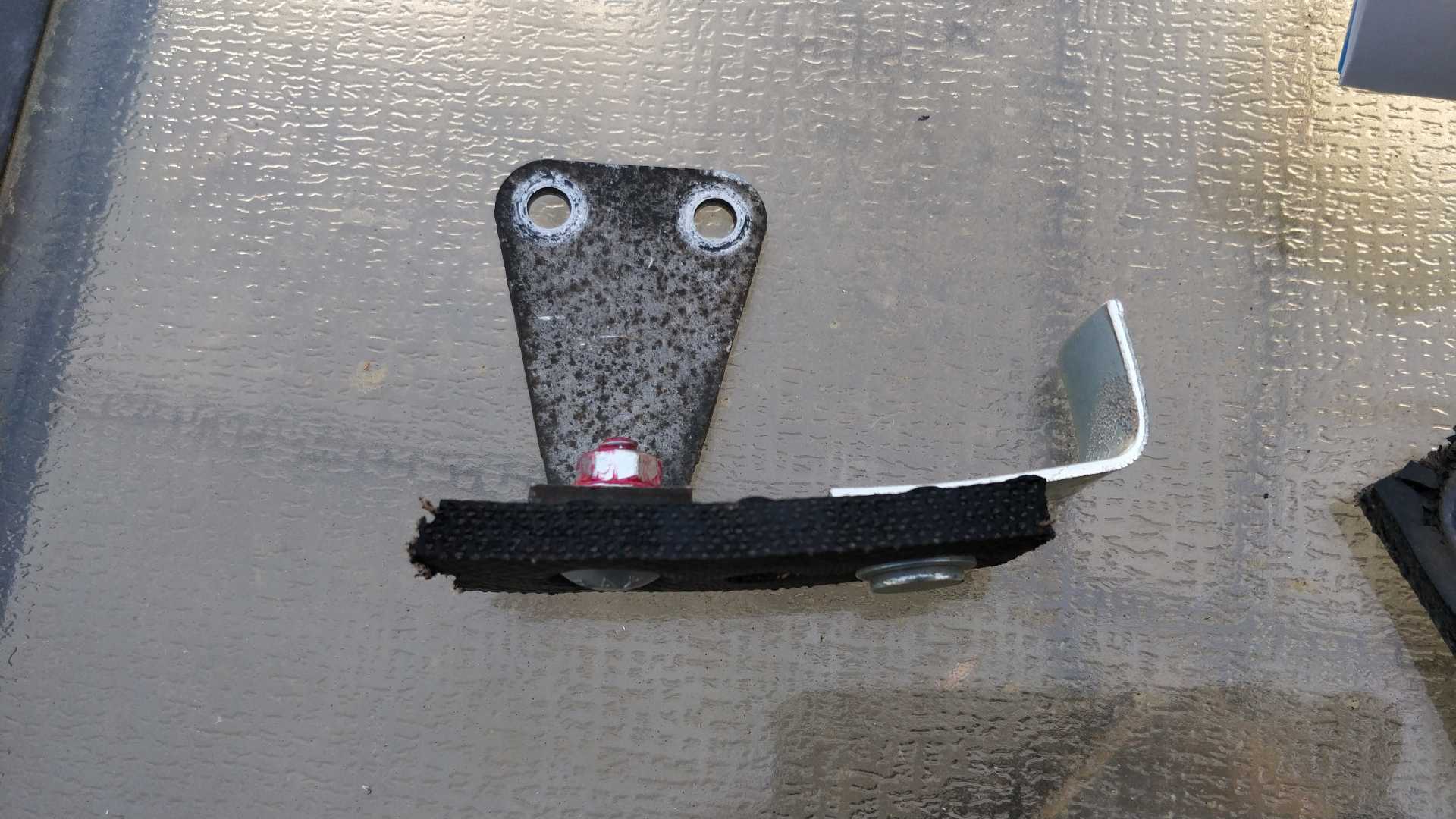

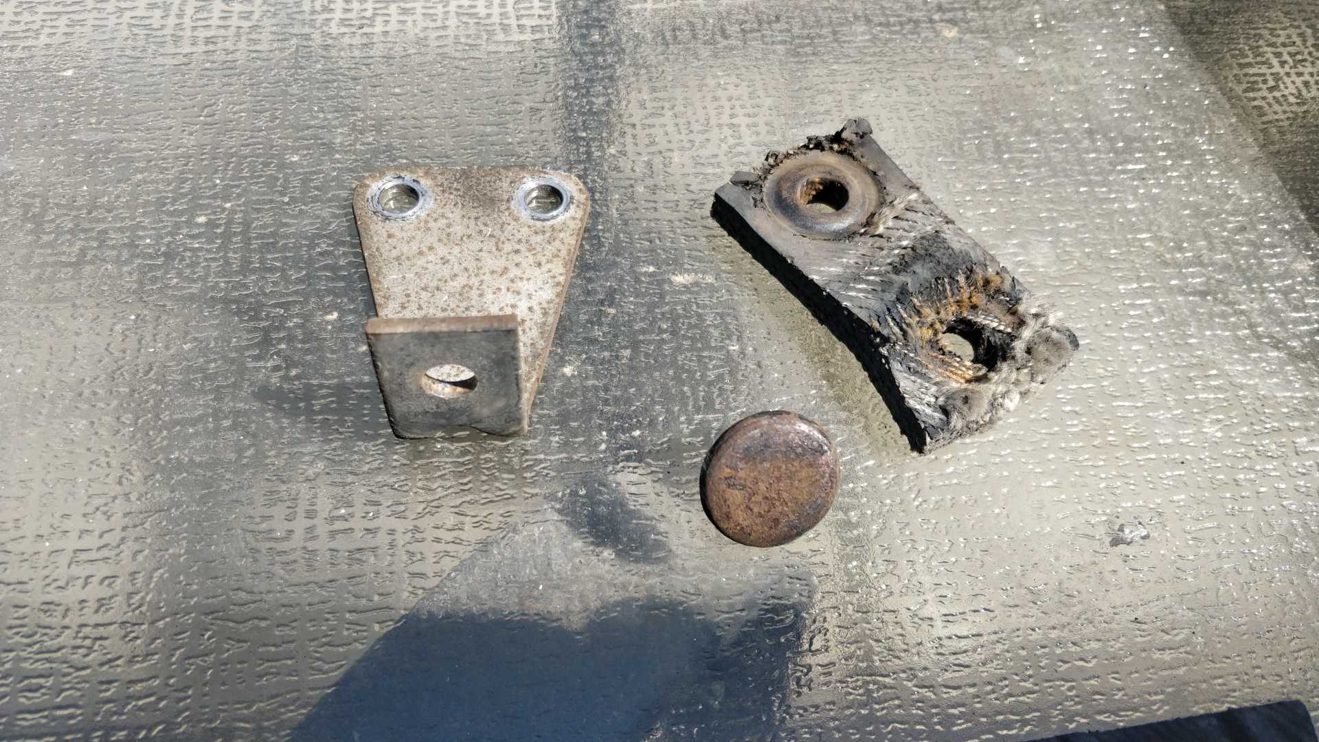

I also needed impact access to the hangers. So while the exhaust was out I fixed my bad hanger and my about to be bad hanger. I found these Exhaust Mate 36274 universal hangers. I could have gotten away with only using 1 and doing the bolt through method top and bottom on one side. Instead i got 2 and will have some extra in case i need to use them on a different Fiero.
Cut off the bottom bracket and ground and punched the rivet on the top bracket.
Bolted the rubber to the top mount.
Did this same thing for the other side and put the exhaust back.
Im actually 1 set of flanges short. I should get those in on Wednesday. Then i can weld up the test pipe and cat. I like to do these at the same time. In the meantime I could bolt the AC back on and the starter (for those of you playing along at home with the to do list. The starter was not on my to do list above because i forgot) I think the current To-Do list before I can put the cradle back is:
- Install Starter
- Swap Starter wire for cleaner one
- Install AC and make sure main harness is routed properly around it.
- Weld Flanges on CAT
- Weld Flanges on Test Pipe
- Install Test Pipe (Once i get the car running for the first time i will want to run all sorts of cleaners through it. These would not be good for the cat.)
- Fix some random smurf on engine harness
- Double check connectors on engine harness
i After this i can toss the cradle in.
The drivers rear rubber brake line is cracked looks bad so I ordered replacements for all of the rubber lines. I will replace this as part of the tossing the cradle back in as well as the clutch slave. Once its in and running ill run some sea foam through the intake then ill run some flush through the oil and change the oil. The oil has been sitting in the engine since October 2015. It was recently changed before it was "parked" the oil is still clean looking. If not for this i would probably change the oil run sea foam then run flush and change it again.

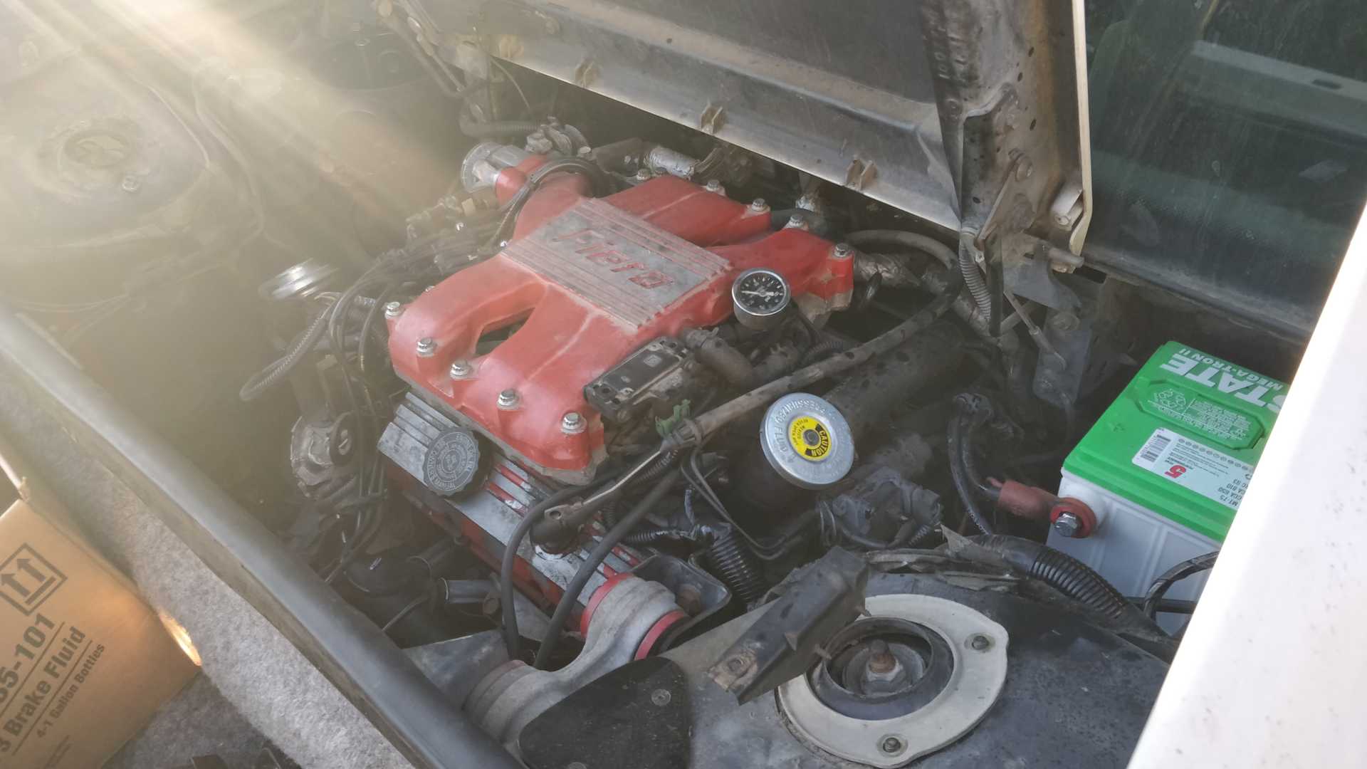

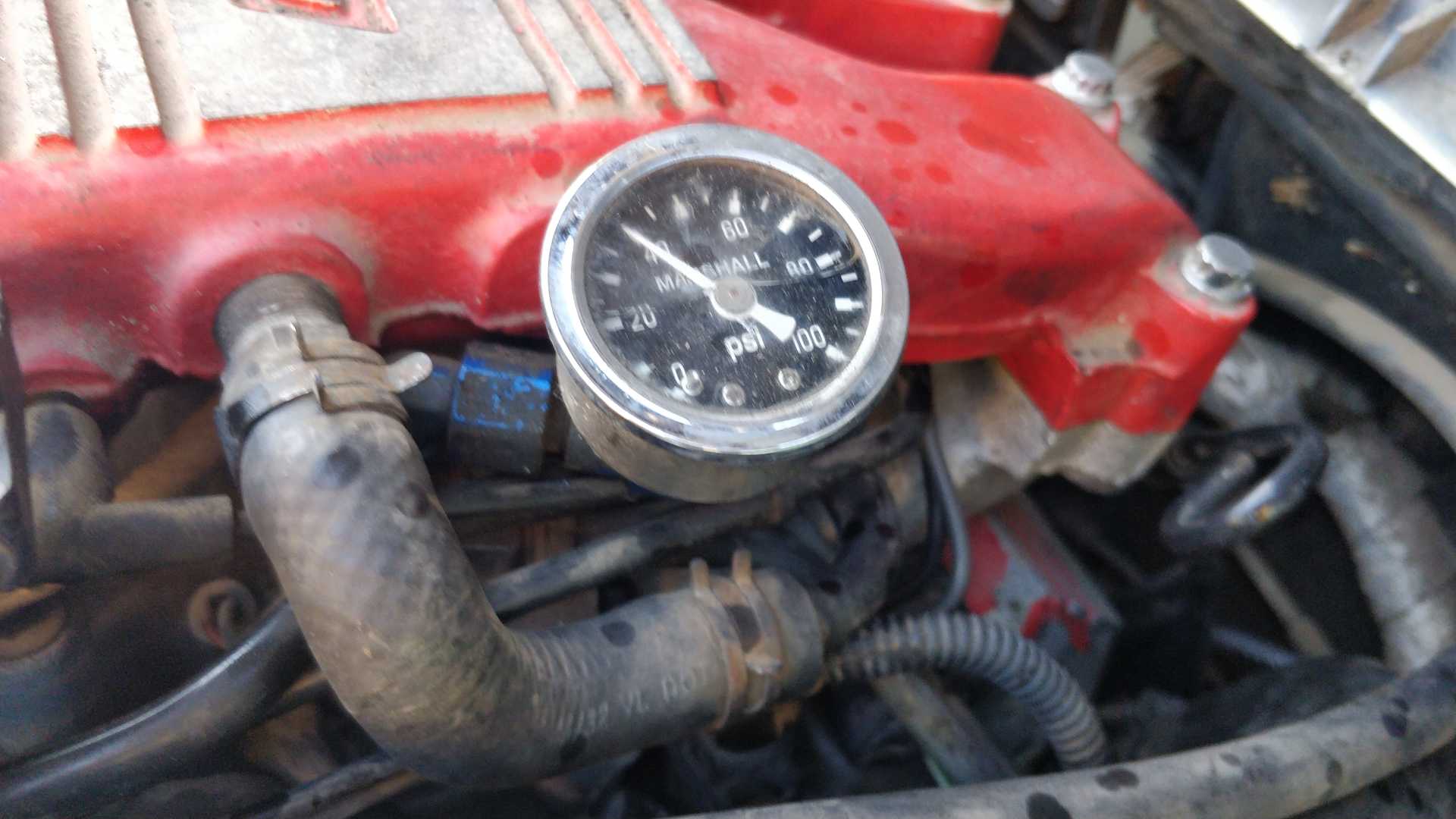

Primed up the fuel system. The Engine came with this nice gauge.
So i ended today on a high note
The manifolds are burning my paint some. Im going to have to run it in short cycles to be safe.
I think i bent the clutch pedal trying to press it. The system is locked up. I needed to push it to engage the starter.
I still need to get the struts fully bolted in and the brakes sorted.[This message has been edited by skywurz (edited 04-10-2021).]

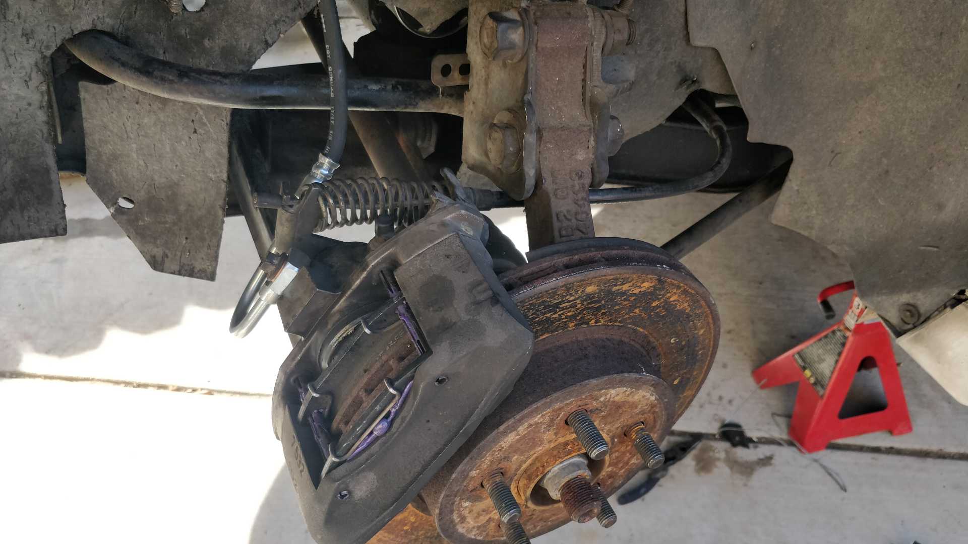

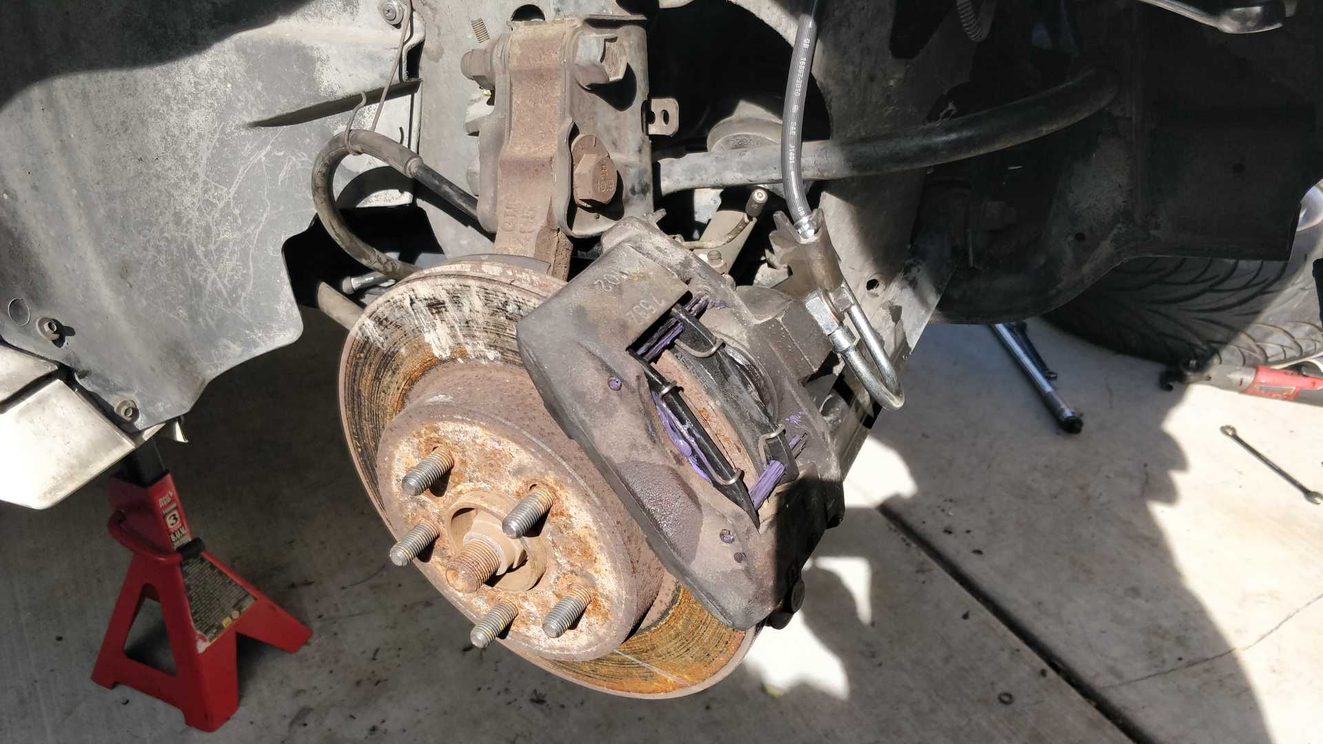

Today I torqued everything down and did the brakes and slave cylinder.
I had never done 88 brakes before, bit they were so much easier than the pre 88 as far as the way the pads are held.

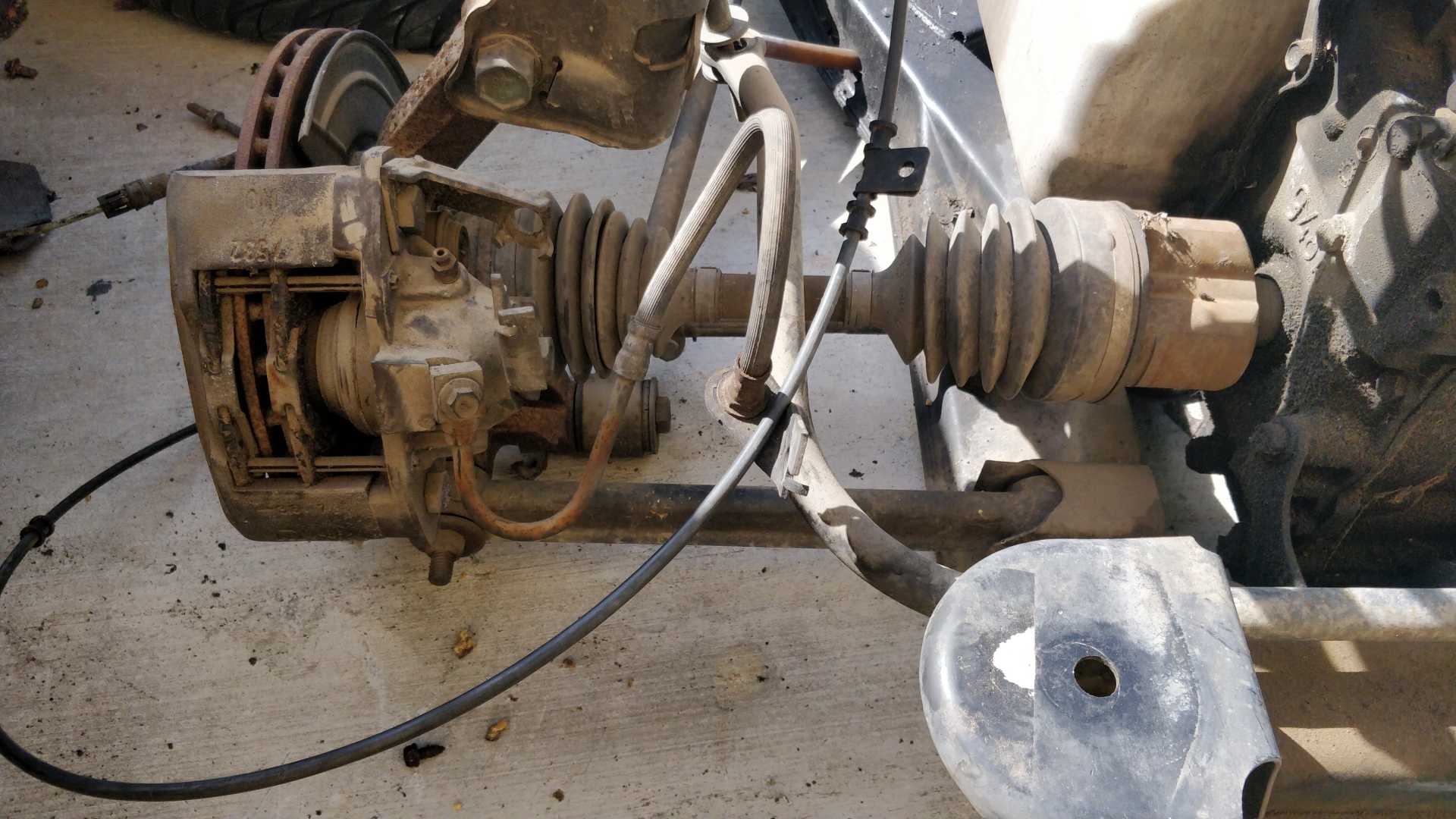

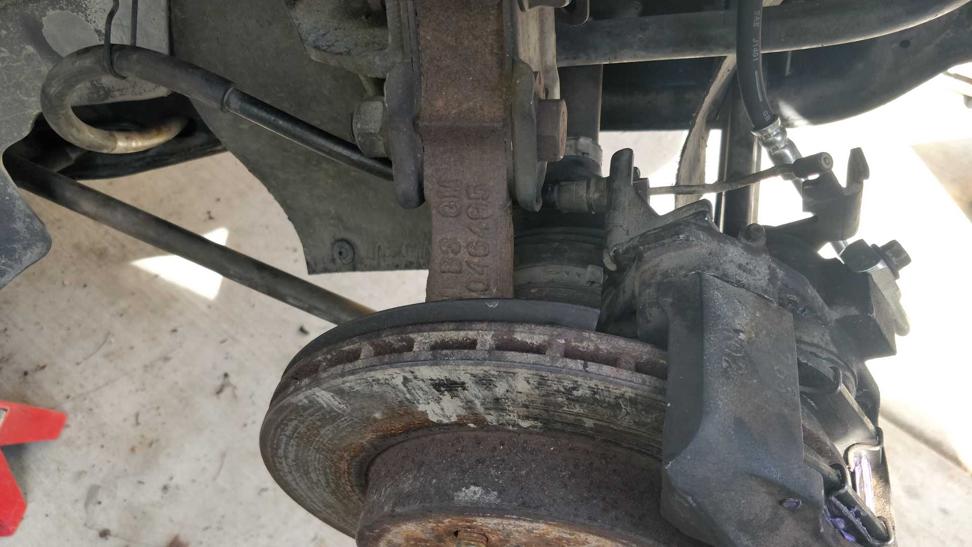

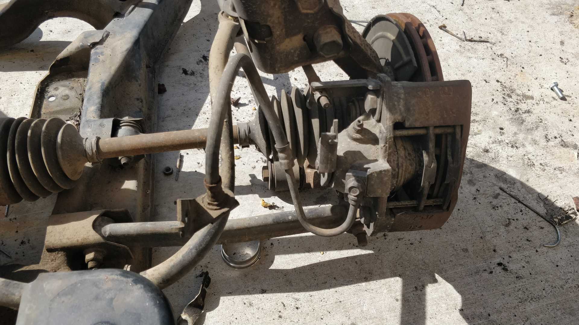

While i was here i took some extra photos for someone who was asking about Parking brake routing.
PSA replace old rubber
Also i took these photos of my other cradle as reference on how to put things back. Hopefully they will be helpful to someone someday.
Basically i just need need to bleed the brakes and the clutch and put the wheels back on, then it would drive.
