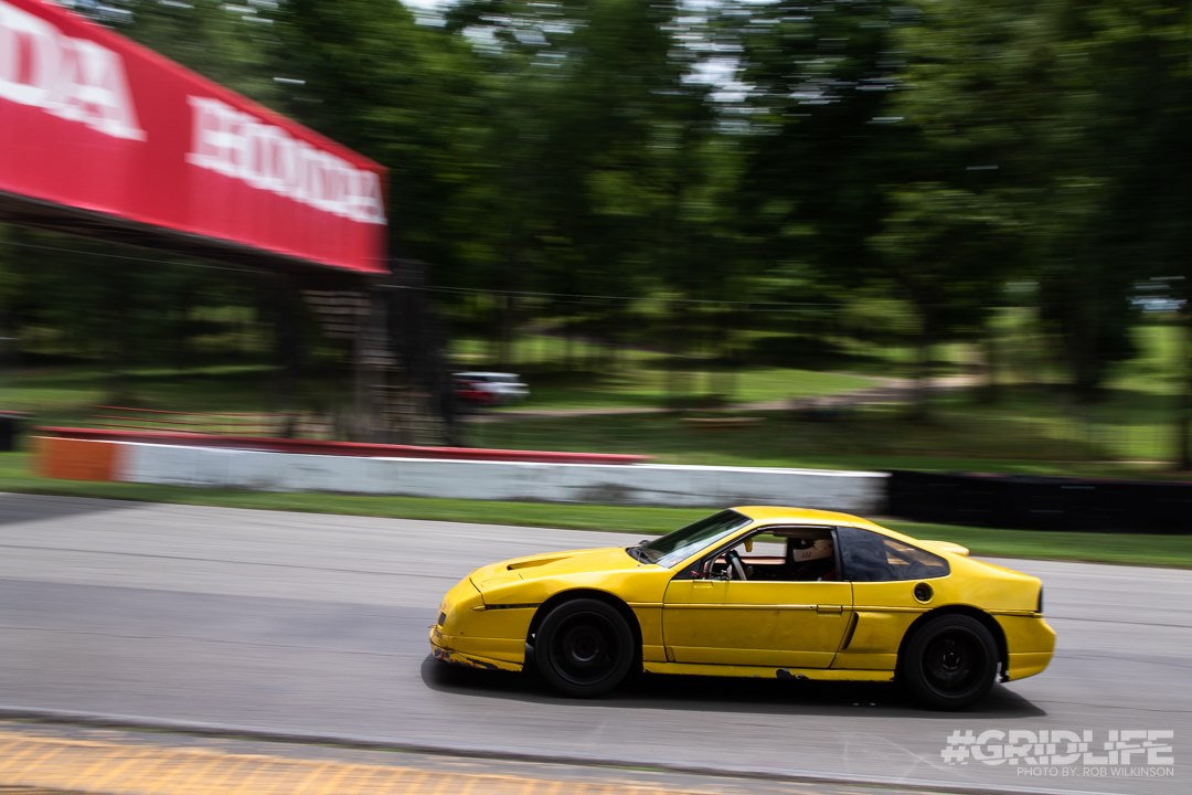

darkhorizon AUG 13, 02:09 PM
Under the honda bridge at Mid Ohio
Rickady88GT AUG 13, 02:25 PM
Cool
