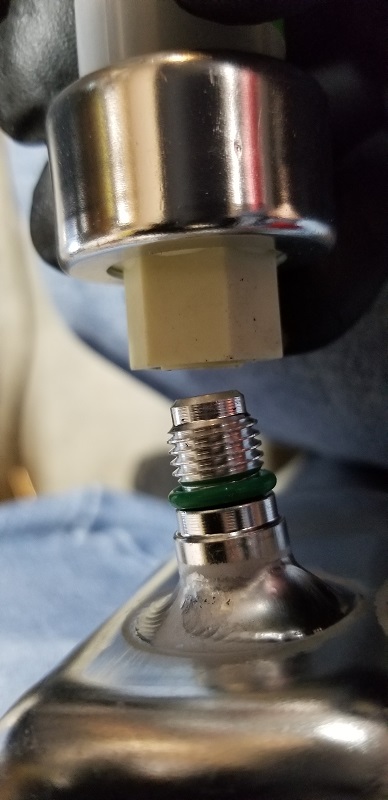

The seal for the switch seemed to fit past the threads on the port. Is this the way it goes???

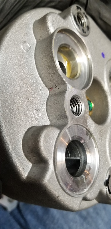

The new compressor did not come with any instructions for fitting the sealing washers. It also, DID NOT, come with anything that says if the compressor comes pre-filled with oil. Should I assume there is oil in the compressor, and that it is PAG?
Should I look under the plastic cover of the new compressor to see if it takes O-Rings or sealing washers?
Should I open the new compressor or leave it sealed until I am ready to install it?[This message has been edited by computer_engineer (edited 06-08-2020).]

Yes, that looks fine.
Right before you put the compressor on the car, install the switches, and take the suction/discharge plastic cap/cover off and see if it takes sealing washers (it should if it came with them and really is a 58255). With the ports pointing down towards a cup, spin the clutch over a few times and see if any oil comes out. If the Four Seasons website is accurate, it should contain 3oz of PAG150.
The point of the cap is to keep moisture out, as refrigerant oil absorbs moisture, and prevent corrosion in the compressor. If you get the whole system assembled and draw a vacuum with a vacuum pump down to 29 inHg for a minimum of half an hour, that should boil off any moisture in the system, leaving the total system capacity of 8 oz of oil you add to the compressor and accumulator. If the system doesn't leak, you can just leave it that way until you're ready to add refrigerant.

The reman Four Seasons #57255 I just picked up came with 3oz. PAG 150. The compressor was labeled as such as well. When drained the 3oz was there for sure.
On install I put 4oz. Ester100 in the suction port of the compressor and 4oz. into the drier/ accumulator. This is the same as I did for the previous compressor and accumulator that lasted 10 yrs. when it (a reman HR6 #57255) failed due to a compressor case seal leak. My guess was the compressor case may have been compromised during install while tightening the a/c belt. Oh well, that reman compressor worked great for 10 yrs. till the case seal leaked using Ester100.
I used Ester initially as there may have been residual oil from the OEM R-12 system in the lines and condenser. For a complete rebuild and flushing I would just use the PAG150 (8oz total).

So the ports on the new compressor are not like the old ones with the O-Rings. The instructions you posted (RWDPLZ) seem to indicate I use the top row with the first column arrangement. I have the sealing washers, but no pilot adapters came with the kit. Do I really need those? The instructions that came with the compressor do not mention the washers at all.
What should I do?
RWDPLZ
JUN 13, 11:45 PM
Post a picture of the hose end that mates to the compressor, and measure the diameter of the suction and discharge holes on the compressor.
