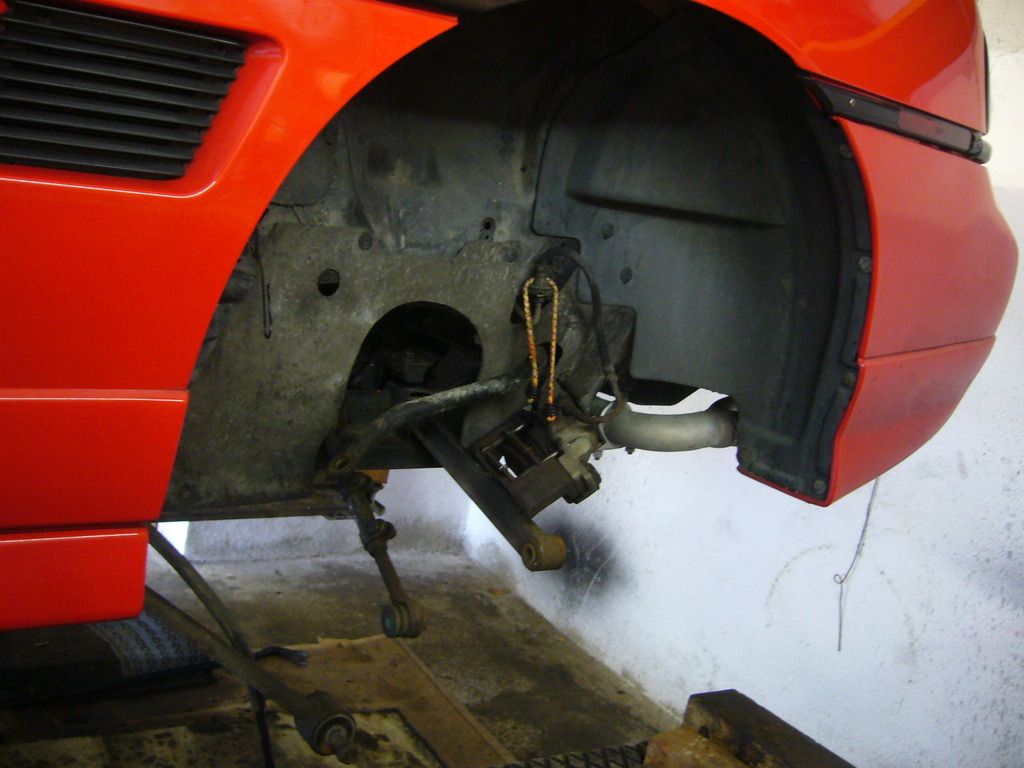

Late but finally I have removed the trans and split the case of my Getrag transmissions.
Preparation work:
Car lifted and supported on wooden blocks:

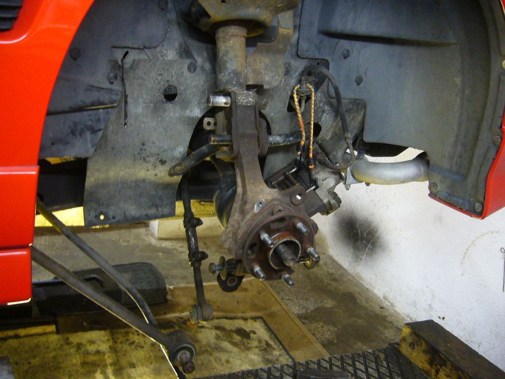

Removing parts like intake duct hose, exhaust pipes, suspension components etc.

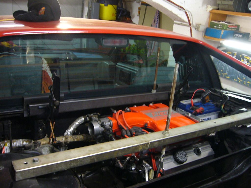

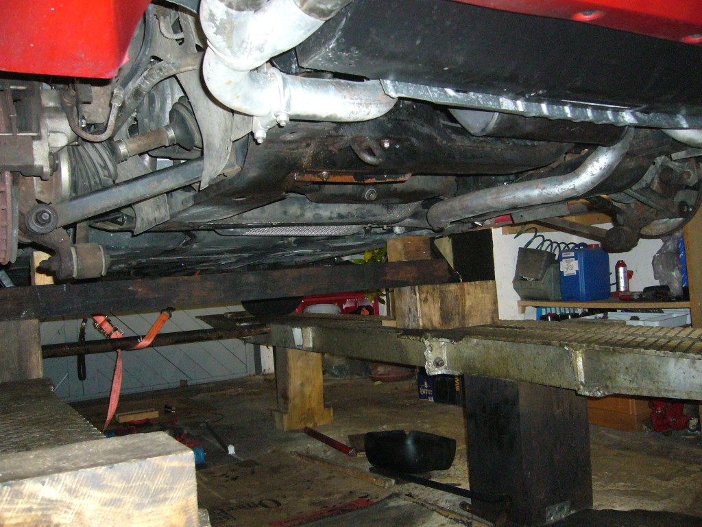

Simple custom construction for lifting and dropping the engine/transmission:
In the next step I loosened nuts and bolts (trans mounts, bellhousing to engine, etc.)
Transmission removal procedure:

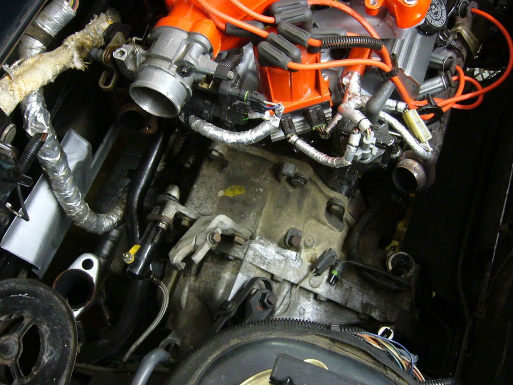

First I lifted the engine/trans a few centimeters in order to remove the transmission/engine mounts and brackets:

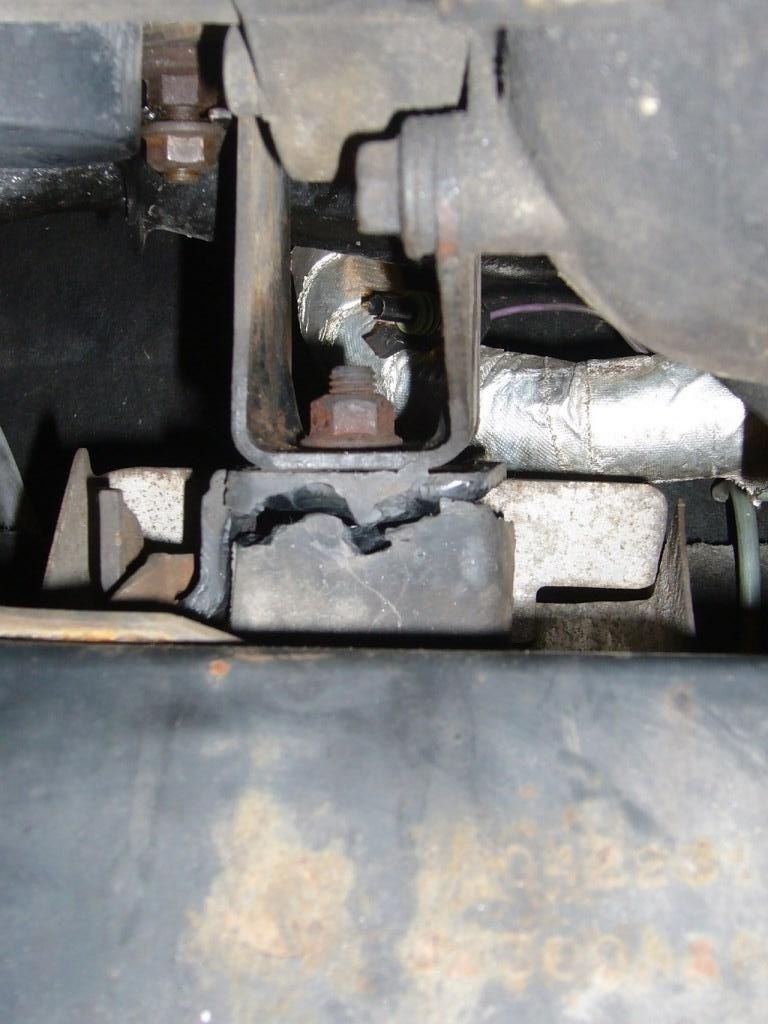

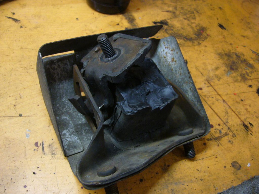

This is the front trans mount which is completely fu**ed up:
Removing rear trans mount and bracket:

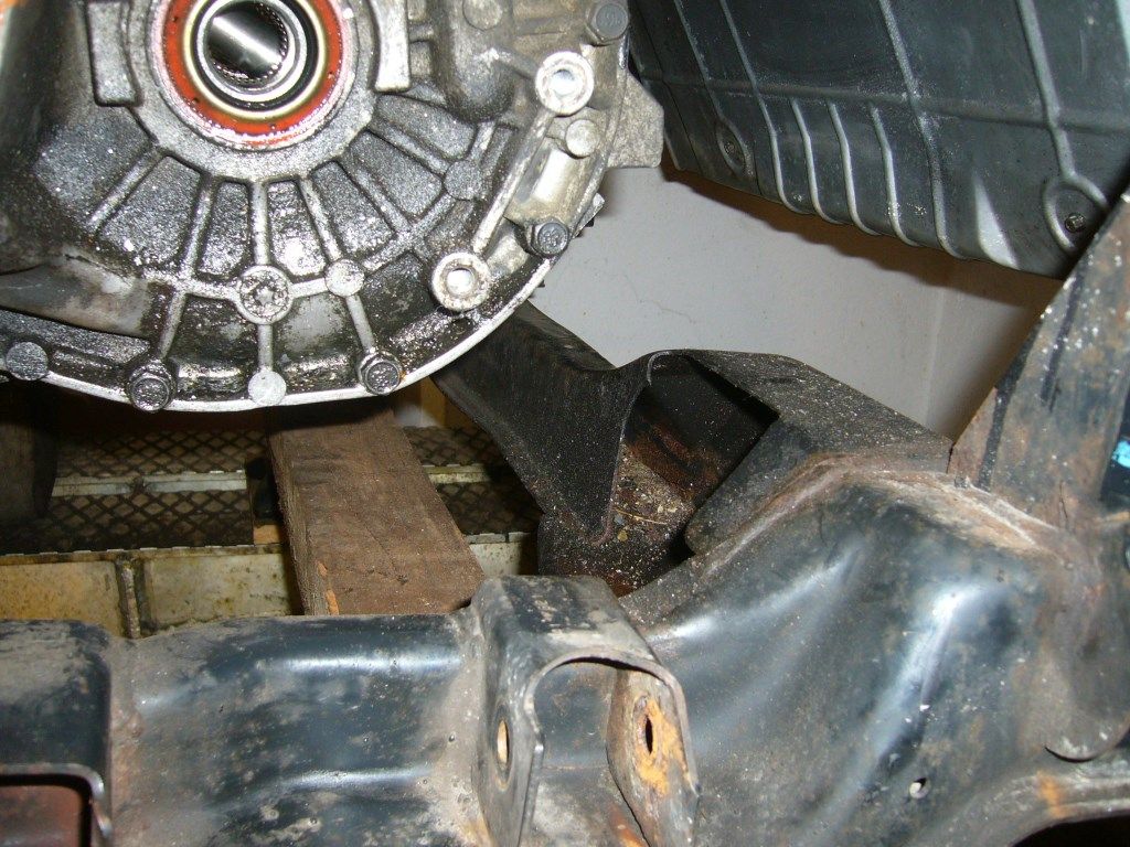

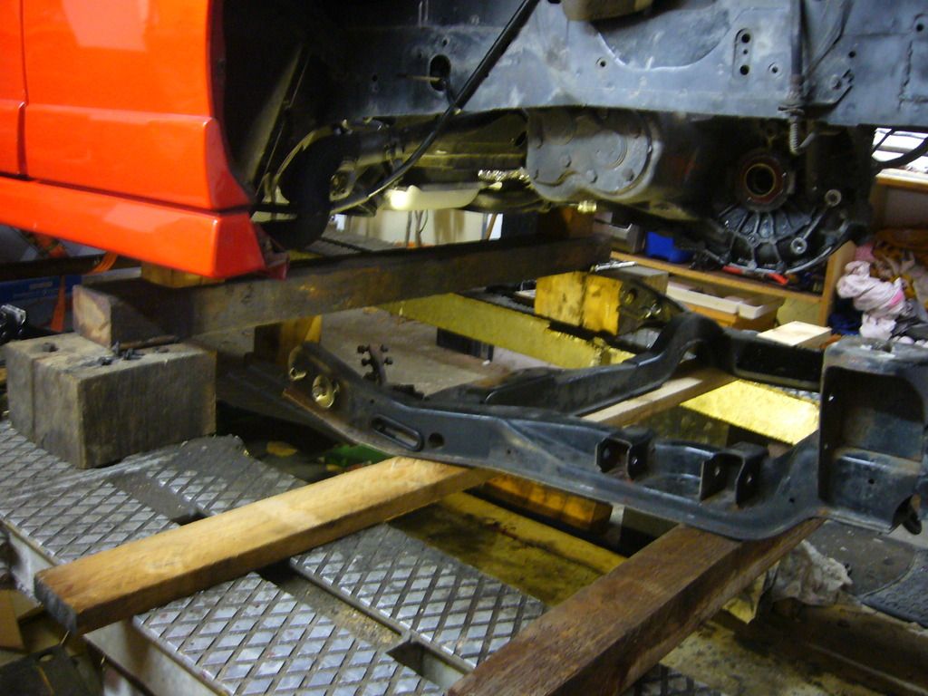

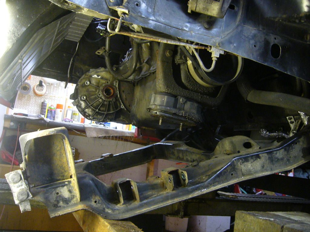

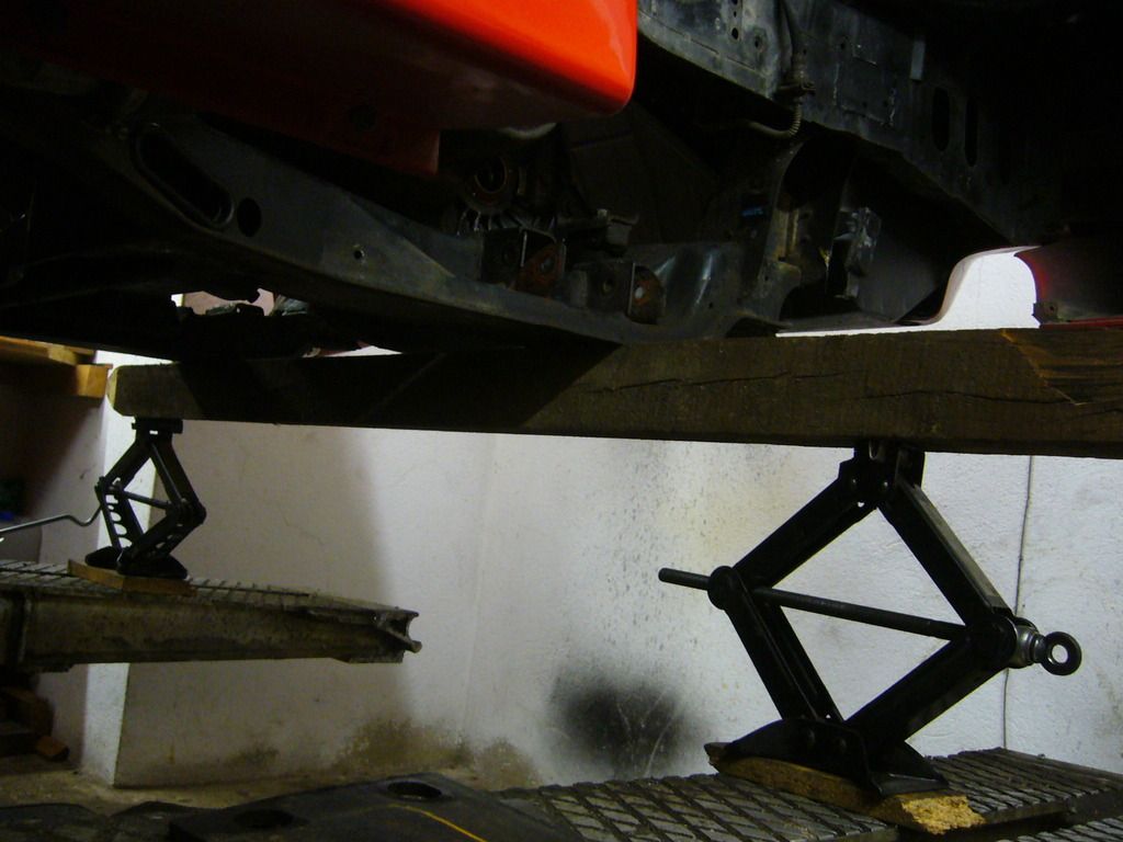

Cradle supported on lifting jacks with rear cradle bolts removed:
Cradle pivoted on the rear down to the floor:

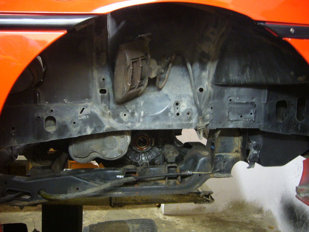

After this I have also removed the front bolts for removing the subframe completely (I’ll sandblast and repaint it later):

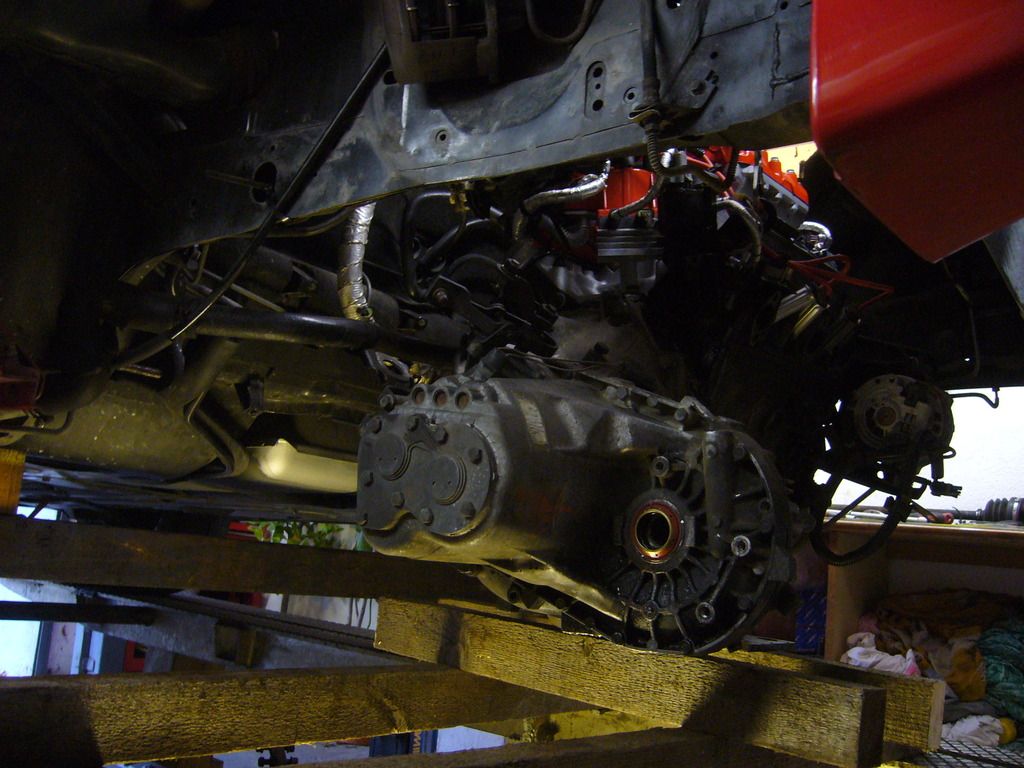

Lowered engine/trans and supported on wooden blocks for additional safety:

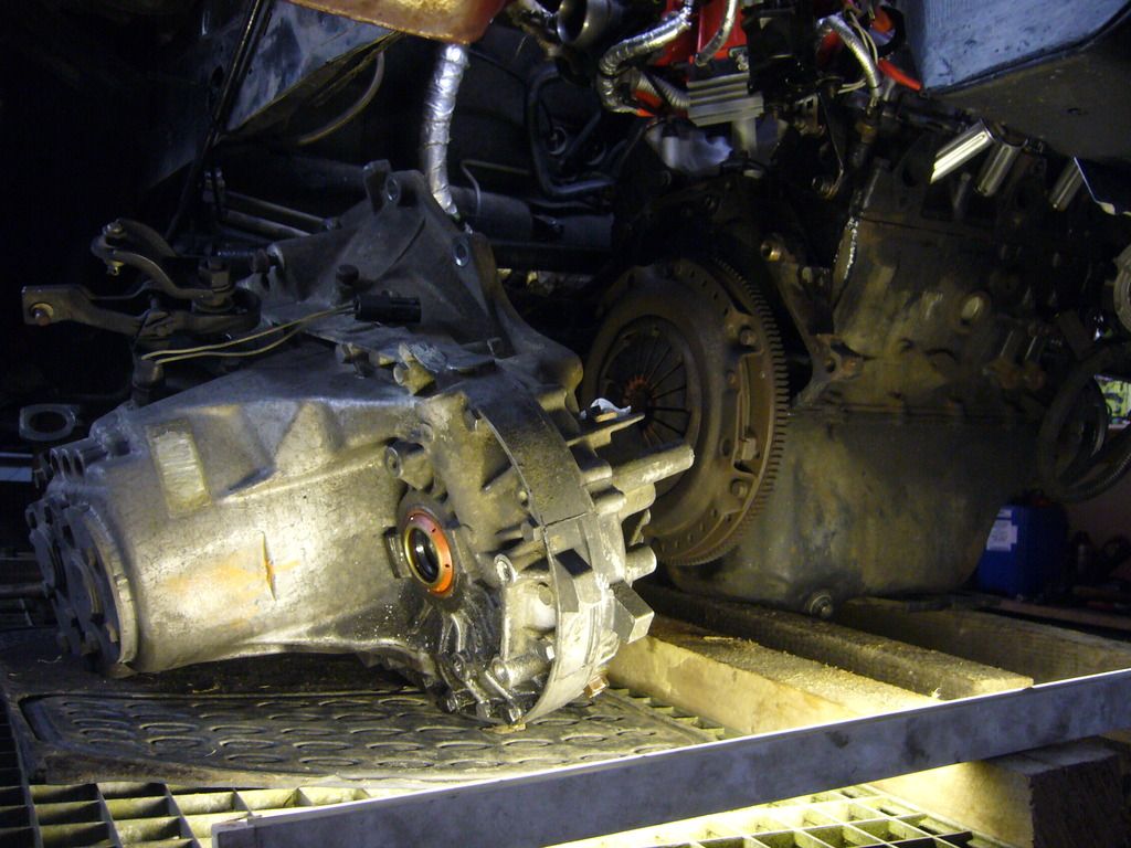

Finally I removed the transmission from the engine:

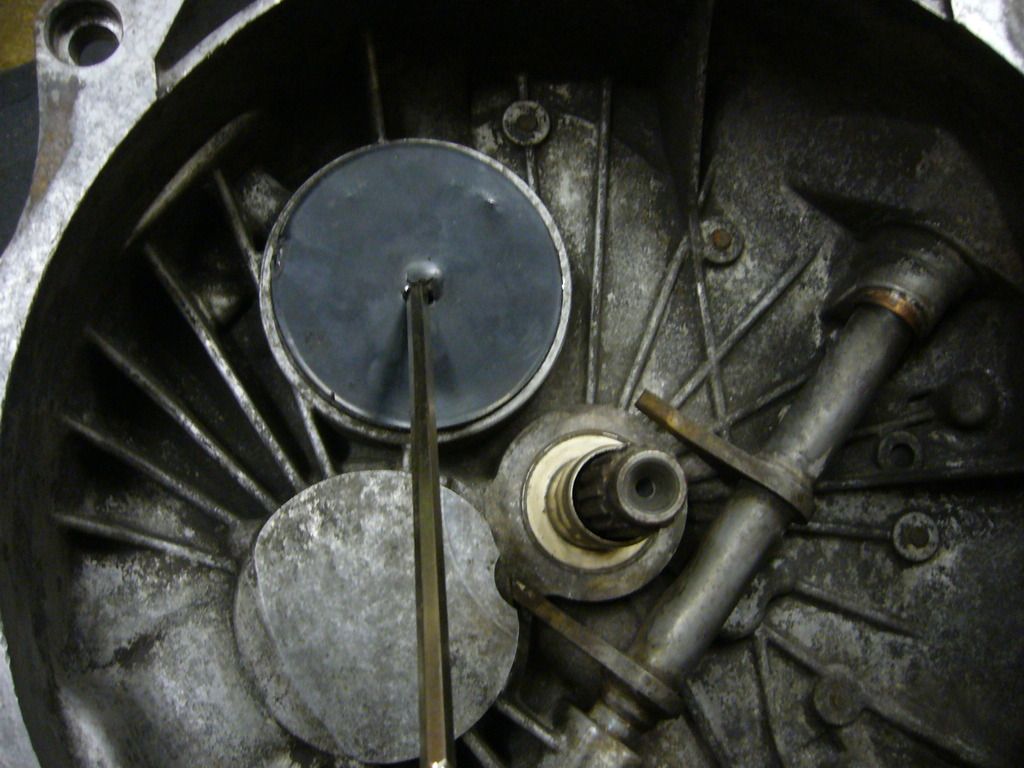

Splitting the case of the salvage unit:

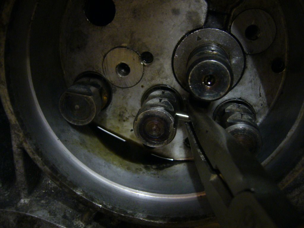

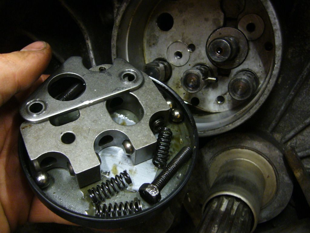

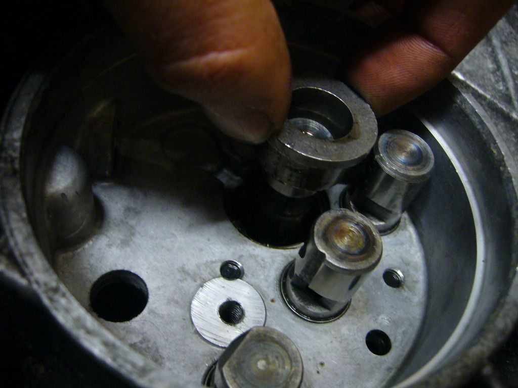

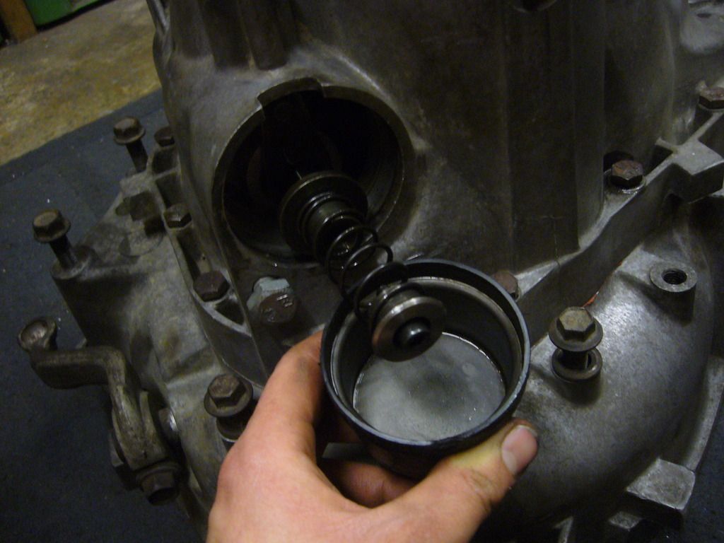

Removing the detent cover and detent holder:
Don´t forget this pin, otherwise you may lose it and then you are fu**ed up!
Remove bushing:
Removing shift shaft cover and spring (optional, not necessary to remove spring):

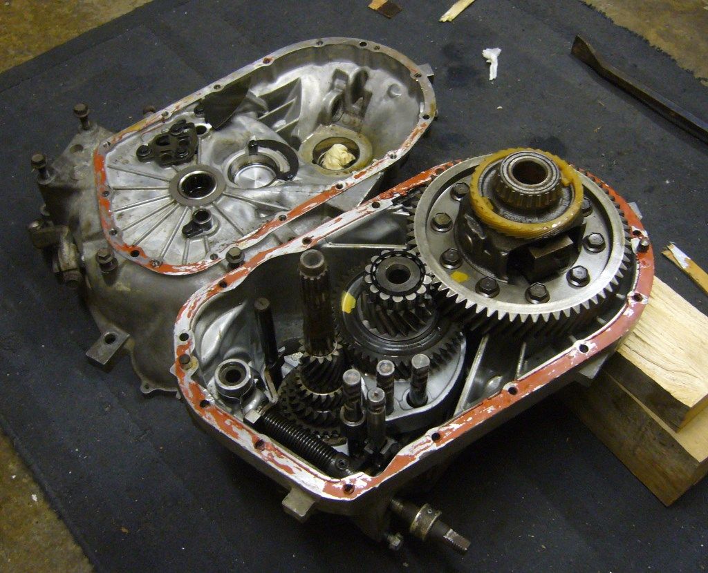

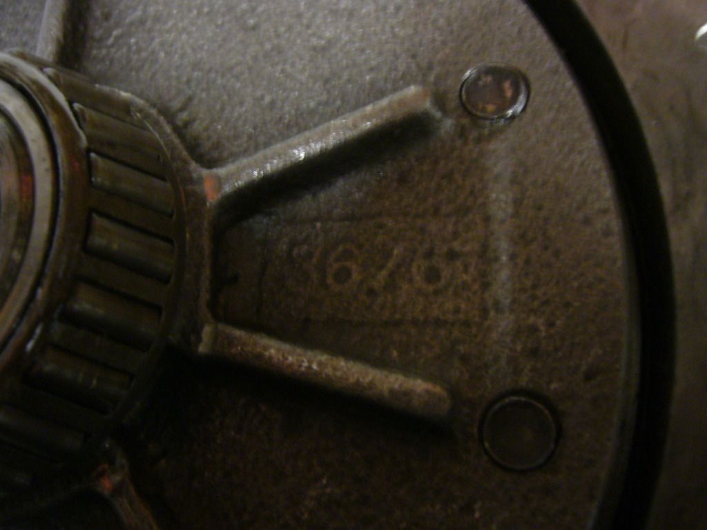

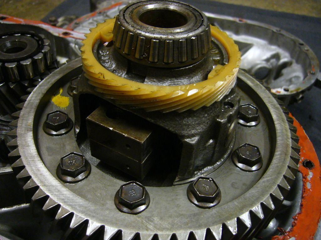

Split case - salvage unit with limited-slip differential:
Does someone know which LSD this is?

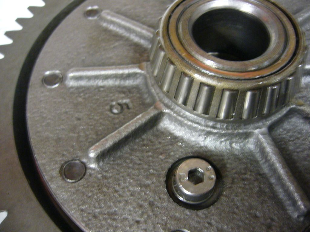

Gall757 JAN 01, 09:30 PM
It looks like the input shaft bearing is good......
