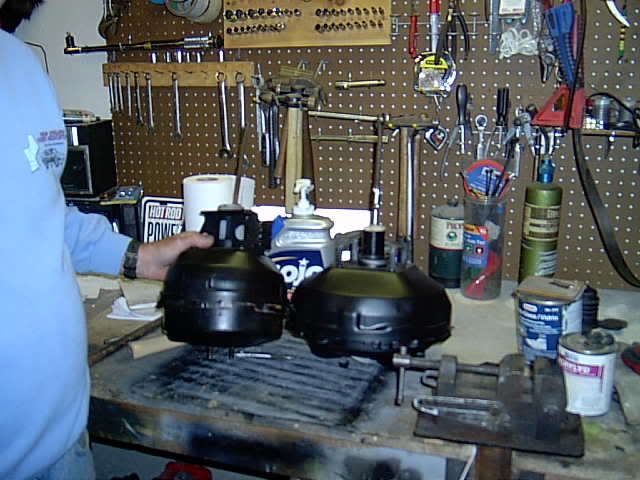

For anyone interested here is a side by side picture of the orinal power booster and the S-10 one. You can see how much larger the newer one is. Phil told me he also painted it black to match the look of the original as they are silver in color when you get one.
[This message has been edited by avengador1 (edited 01-16-2009).]
