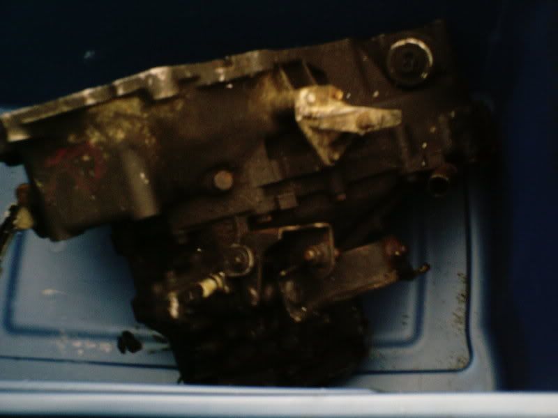

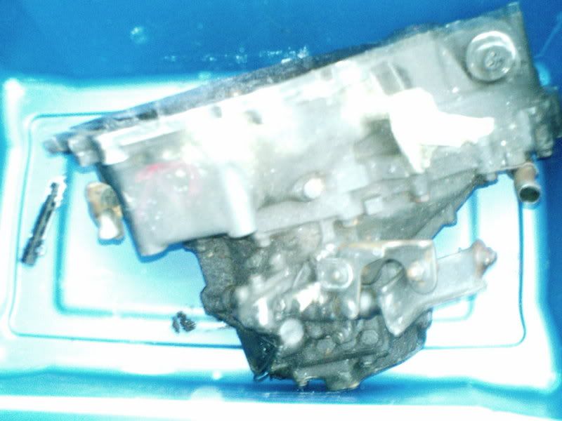

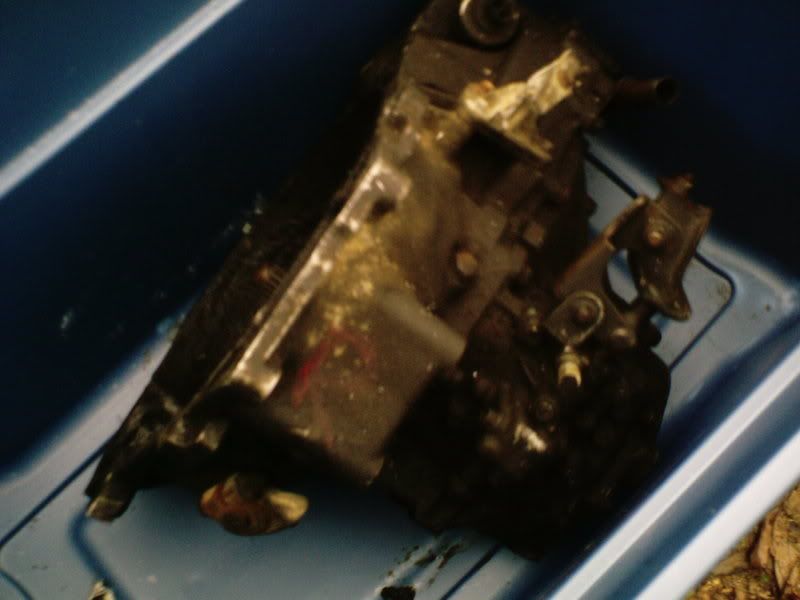

ok i have a 4 spd munci in an 86 se 2.8......ok i bought a replacement long ago an when it got here it wasnt even the same tranny as pictured on ebay and it also looked nothin like my munci can anyone identify it? and are the parts from this tranny compatible with mine cus my munci has some shift problems and it needs repaired or replaced and sofar i cannot find a suitable replacement
pics of what i was told to be a replacement to my munci on ebay

that's an isuzu,
you will need the metal brackets from the tranny to the rubber mounts,
the shifter inside the car,
the shift cables,
the clutch slave and mount bracket.
and then re wire your car so the reverse light switch on the tranny can be used.
DEMONCHILD MAR 03, 09:33 PM
the thing is i have none of those parts from the car it came out of and i dont kno what kind of car it came out of either
buddycraigg MAR 04, 04:47 PM
85 and up 4cylinder should have the parts you need.
Steven Snyder MAR 04, 05:02 PM
It will probably be easier and cheaper to just get the right transmission.
