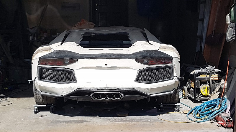

In general (sorry for the lack of details), I reworked the exhaust, adjusted the spoiler lift system, changed the spoiler and finalized it's alignment, changed the rear diffuser and finalized it's alignment, re-aligned the tail lights, installed the rear grill and housing brackets, made additional adjustments to the bumper positioning and alignment, and a few other things that I can't remember right now. Essentially, I have been focused on everything at the rear end. I haven't really started any of the actual bodywork, but I'm hoping that will go fairly fast once I have completed alignment of all components. The fenders and active vents are still sitting loose, but I'm slowly working my way towards them.

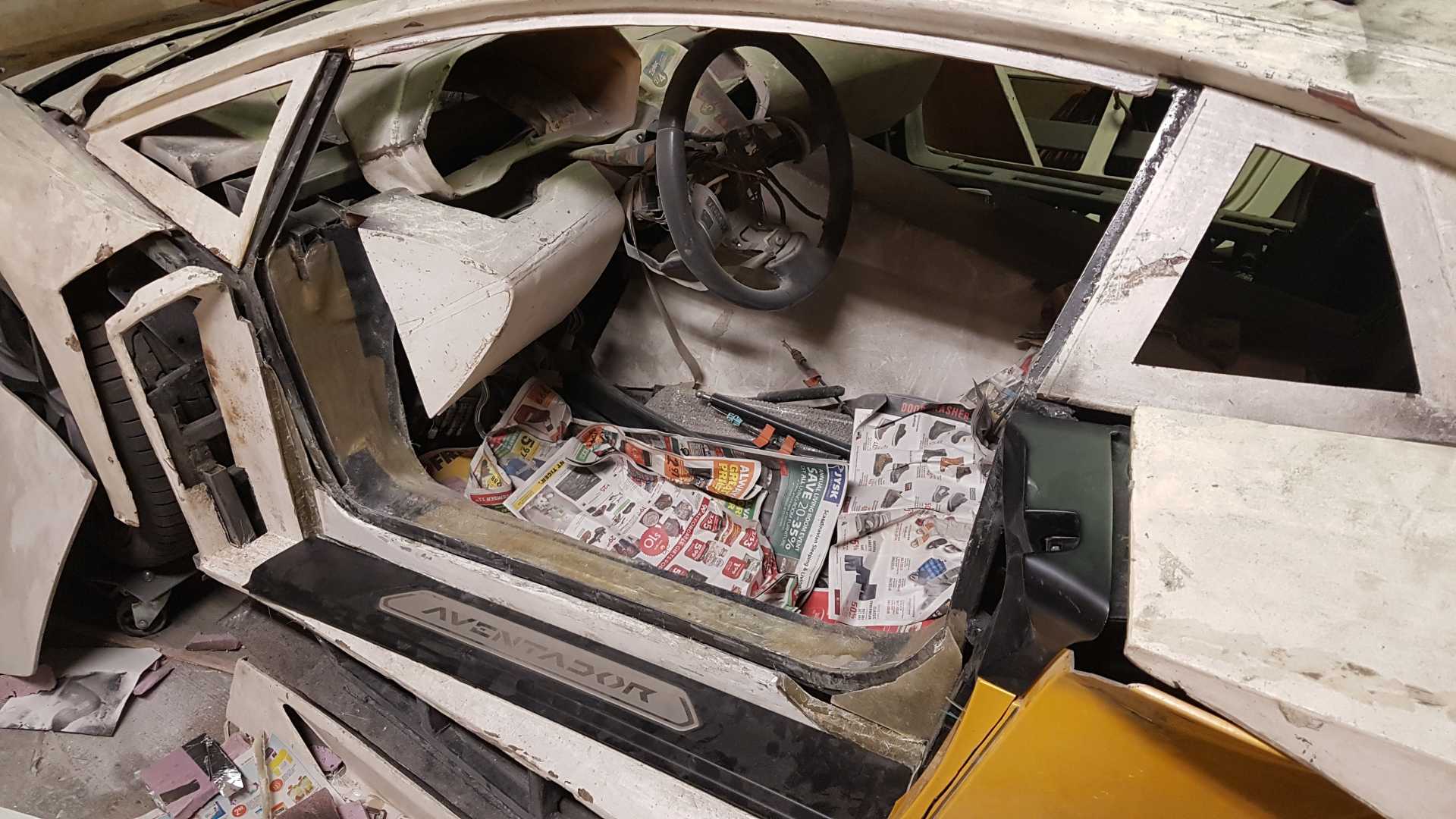

But while I'm here, I may as well give a partial update. I did a little work on the door openings. I made a lip that goes all the way around the opening so the I can install the OEM door seals. I've also fiberglassed some areas of the opening so that I can begin to give it a more finished look.

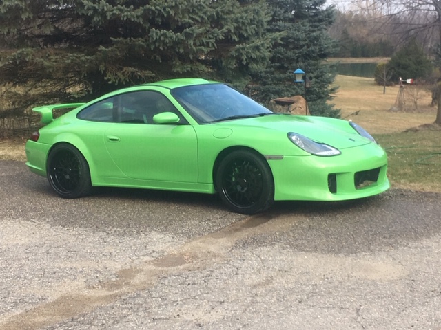

very cool build!! I did a partial rebody for my Carrera 911(lots of fiberglass) last winter and I'm working on a car from scratch currently and looking through this.. its a labor of love lol.
keep up the good work. other people getting this elbow deep in there cars keeps me going and is so inspiring. Brian
