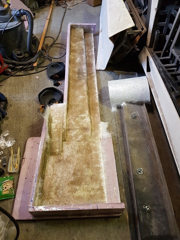

While waiting for the replacement keys/locks to show up, I decided to tackle something that I actually started 3 years ago... the scuff plates under the rocker panels. A lot of work for something that no one will see. As with the driver's side (which had been completed previously), I created a mold using polystyrene foam sheets cut and filed to shape. The parts are glued together with a hot- glue gun and then sealed with packing tape. It's a great way to quickly make a mold, especially ones with large flat areas. In this case, the finish isn't really important since these parts are hidden from view. If everything goes as planned, I'll try to get it fiberglassed tomorrow.
Neils88
MAR 13, 02:26 PM

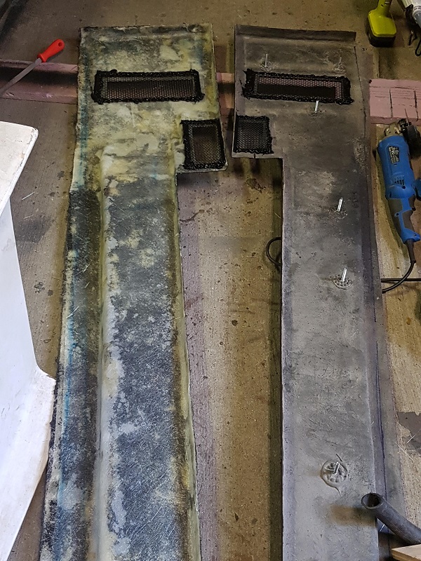

I finally finished fiberglassing the passenger side scuff plate. Took me a couple days longer than I had wanted, but at least it's finished. Almost. I still need to trim the edges and cut the two vent holes. Also, before the two scuff plates are permanently installed, I'll spray them both with a layer of undercoating.... easier to do before they are installed.

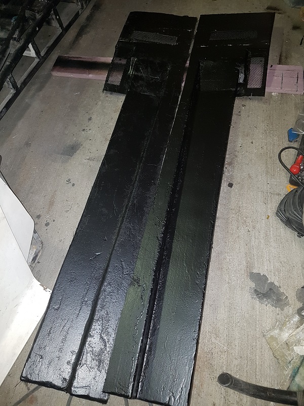

The scuff plates are ready to be installed. The passenger side scuff plate still needs to be trimmed along the edge to match the rocker panel, but I'll do that after it is installed.
Scuff plate in mold...
Grills (rock guards/vents) were mounted into a bead of urethane...
Rubberized undercoating...

Yes, they mount under the rockers (from just behind the front wheels, all the way back to under the radiators). As you can see from previous pics, the car has the additional framing outside of the Fiero spaceframe and there are a number of items mounted in that area. I want to keep water, rocks, debris, etc. from getting up into that area.

I attached all of the necessary "bonding bolts" to the scuff plates using 3M panel bonding adhesive. However, in addition to bolting the scuff plates in place, I will also use a urethane adhesive between the framing and the plates to ensure they don't come off.

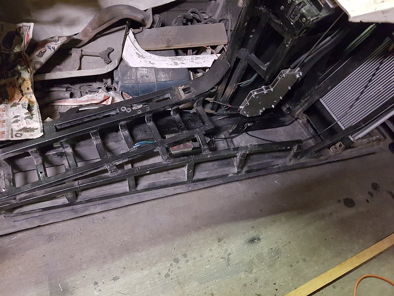

I decided it was time to get the passenger side of the car caught up with the driver's side. Everything is fun the first time round... less fun when you have to duplicate it. The first step is to modify the section of the body where the latch/ lock connection mechanism gets mounted. As with the driver's side, it needs to be moved in to allow for the curved body panel that forms the main vent. I spent some time today cutting away the old body work and framing that interferes with the new panels. Hopefully tomorrow I can weld in a new plate to seal it all up.

I managed to get the plate welded in place and painted today. This modification effectively eliminates the interference between the Fiero spaceframe and the OEM Aventador vent panel.
