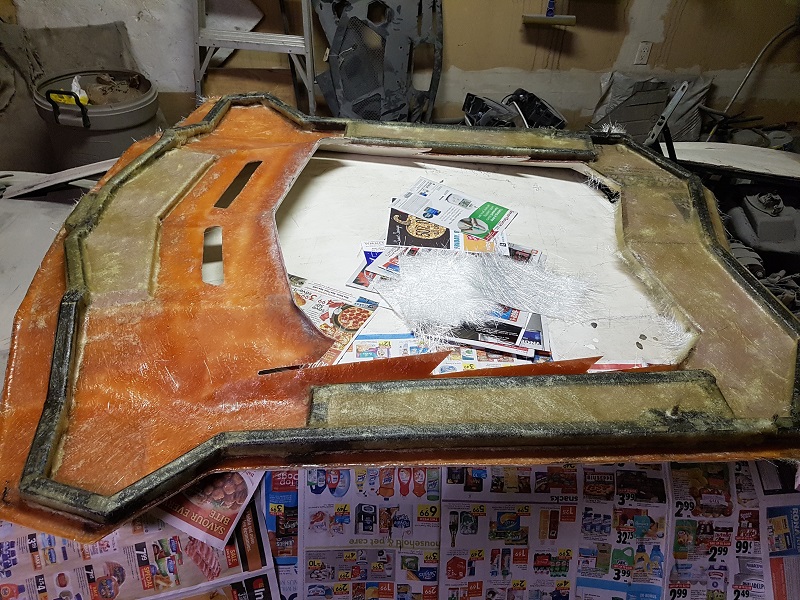

I started work on the inside of the engine hatch. I've fiberglassed the frame to the hatch and will finish it off with a little body fill to smooth it out.

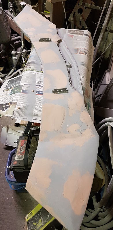

I also primed the underneath of the spoiler....and subsequently found several dozen flaws that needed some attention. Should just need a final sanding now.

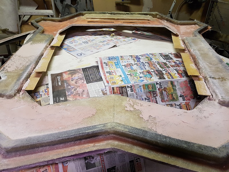

I added ledges to the engine hatch today (used to hold the glass panels). They were cut from flat strips of fiberglass (4 layers) that were larger than the required finished ledges. The first step was just to align them and get them bonded in place with some body filler. I'll strengthen them with multiple layers of fiberglass to properly bond them in place and complete the underneath shape of the hatch. Once they are properly secured I'll be able to flip the hatch over and then cut them to the finished dimensions.

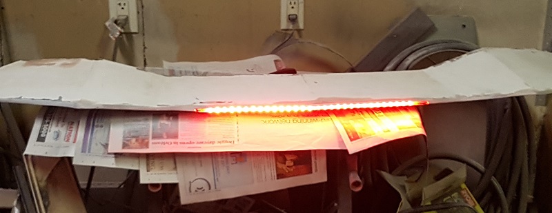

First test of the (oem) third brake light that is embedded in the spoiler...

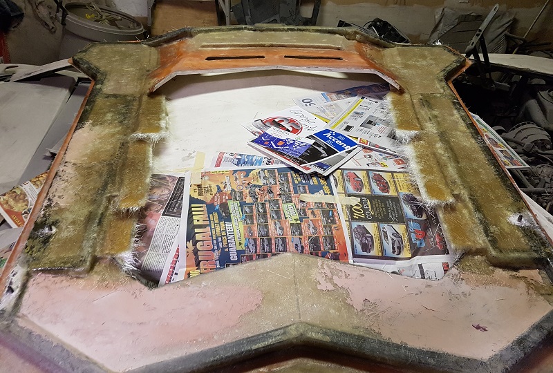

I've now finished fiberglassing the back side of the engine hatch. I still have to add a finishing layer of body fill to smooth out the surface, and then I'll cut the ledges to their final shape.
