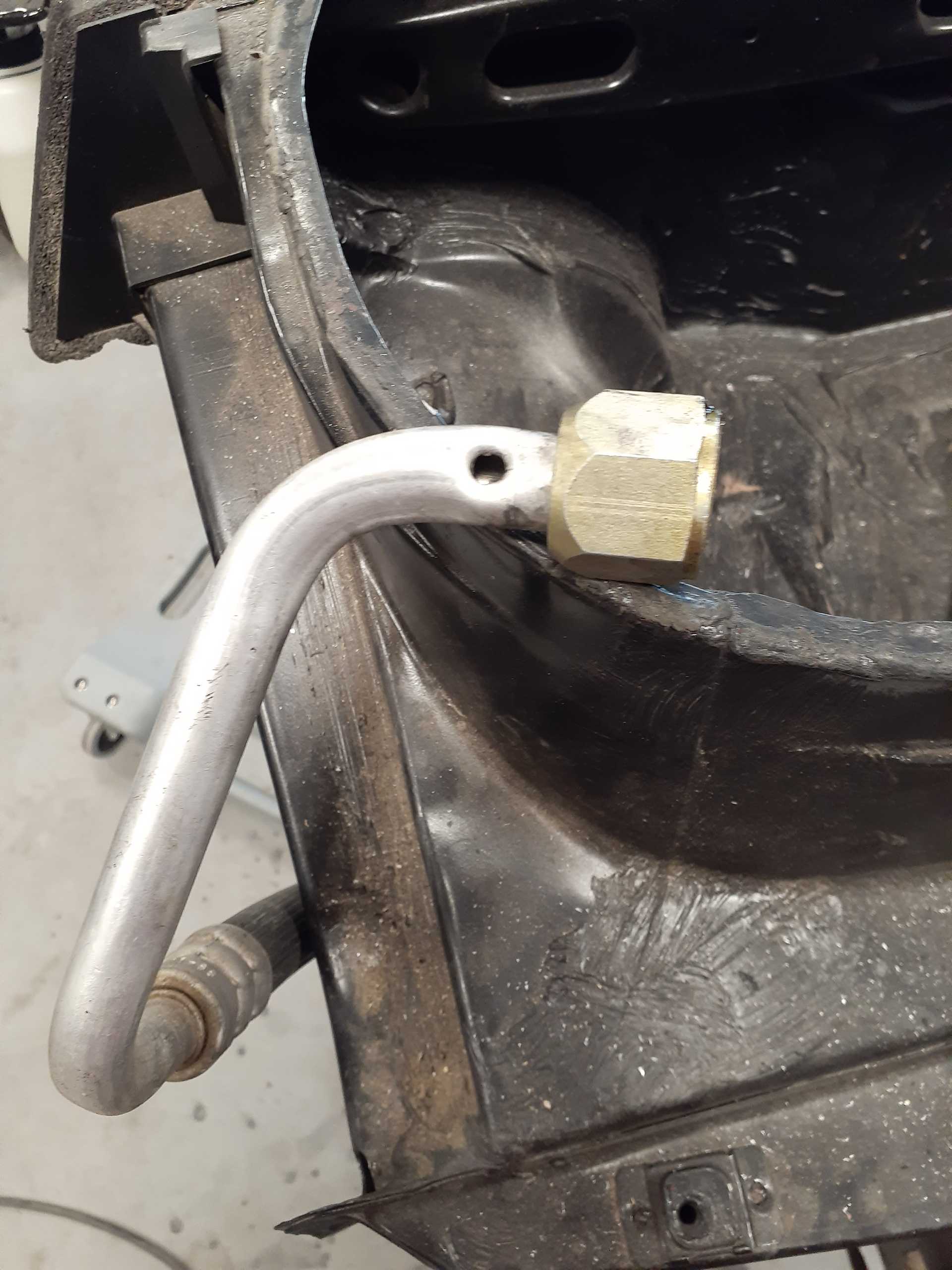

 Trying to get as much done as I can before my surgery, so I went to the Pull-n-Save to get AC lines. This is what I found. Yes, I bought them anyway, but i gotta ask, is punching holes in A/C lines standard procedure? All of the cars i checked there had similar holes. |
They suck out the freon and drain the tank. Also empty the oil pan. That is now standard in Ca. The goal is to NOT spill anything.

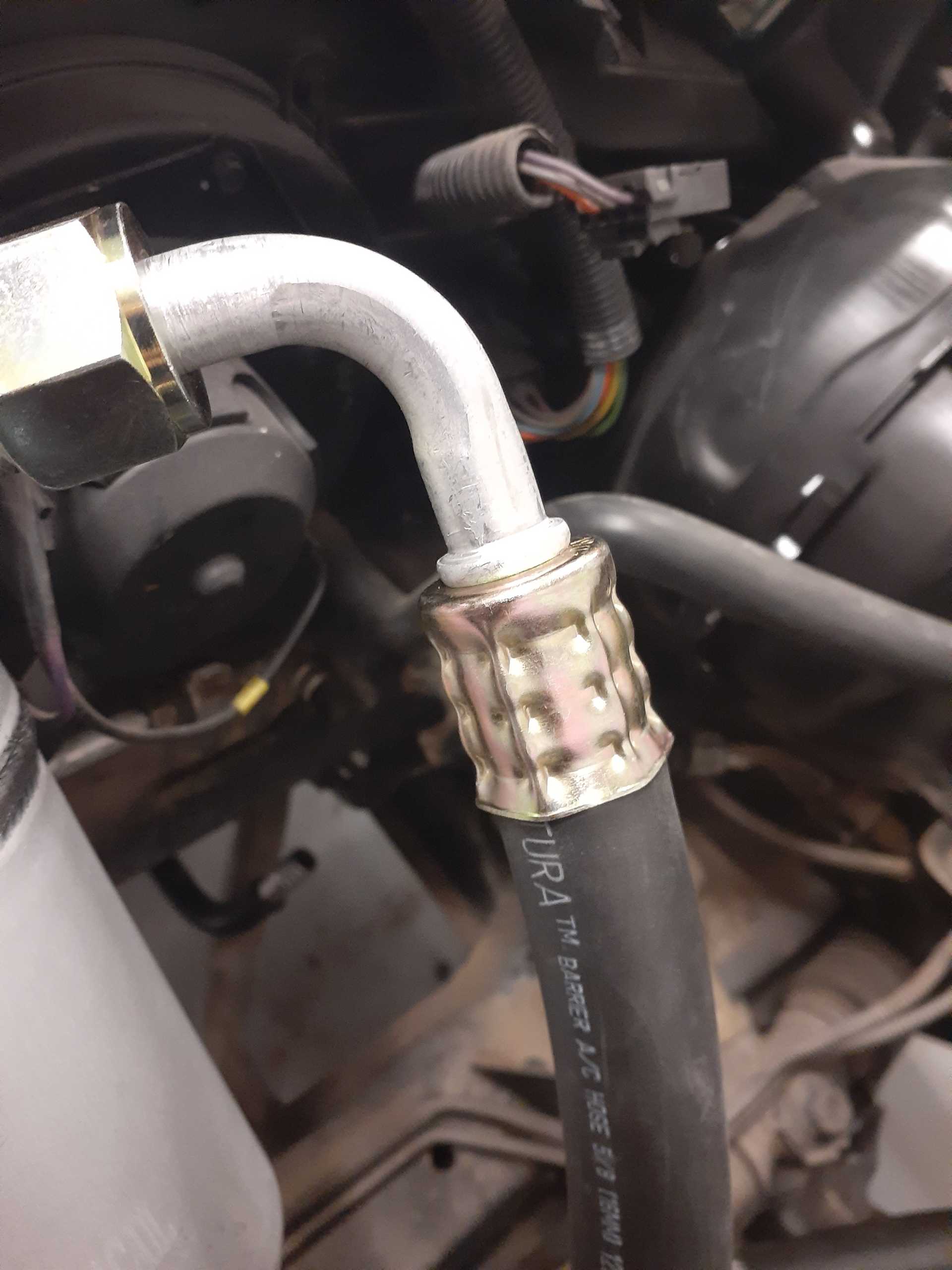

 That new tool I was so excited about, well I got to use it today. This is actually my 3rd crimp. I think it looks ok, what do you guys think?

| quote | Originally posted by Daryl M: Is anyone familiar with this type of tool? Any tips before I ruin the first few crimps trying to learn how to do it right Thanks Daryl |
I have that one as well. I normally crimp the fittings 2 times rotating the tool 1 flat to help balance out the compression of the crimped fitting.
DEC 18, 07:12 PM
 That new tool I was so excited about, well I got to use it today. This is actually my 3rd crimp. I think it looks ok, what do you guys think? |
Looks "factory" to me.

| quote | Originally posted by fieroguru:
I have that one as well. I normally crimp the fittings 2 times rotating the tool 1 flat to help balance out the compression of the crimped fitting. |
Have you ever had a leak in a fitting you crimped?
fieroguru
DEC 19, 08:50 AM
Have you ever had a leak in a fitting you crimped? |
Yes. When Iooked closely at the crimped ferrule it wasn't uniform on all flats. That is when I started to crimp them twice and rotating the tool between crimps.
Daryl M
DEC 19, 11:48 AM
Yes. When Iooked closely at the crimped ferrule it wasn't uniform on all flats. That is when I started to crimp them twice and rotating the tool between crimps. |
Thanks for the tip. I can use all of the help I can get.
