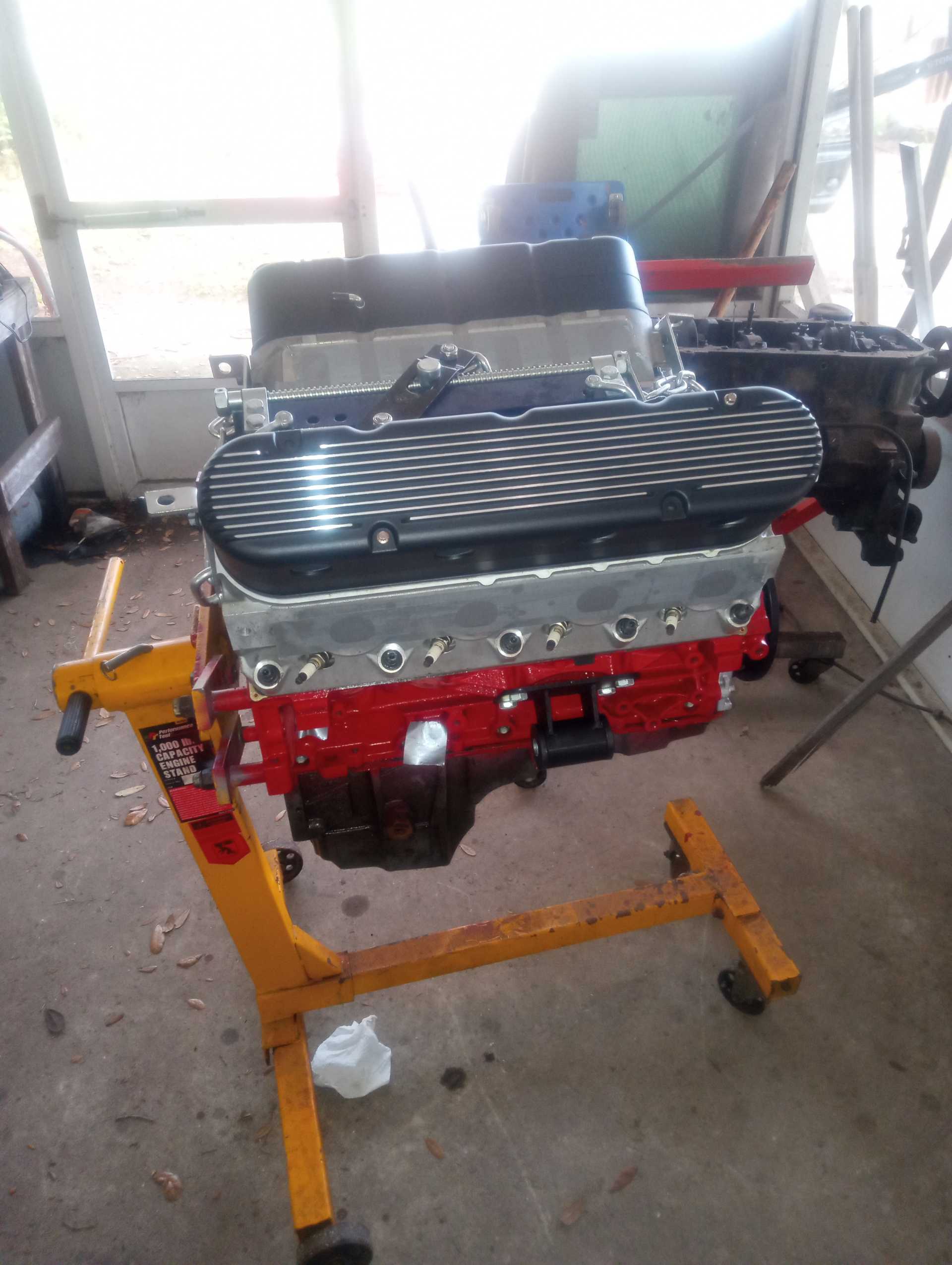

engine man DEC 21, 09:44 AM
New valve covers to clear the rocker arms and hide the coils
