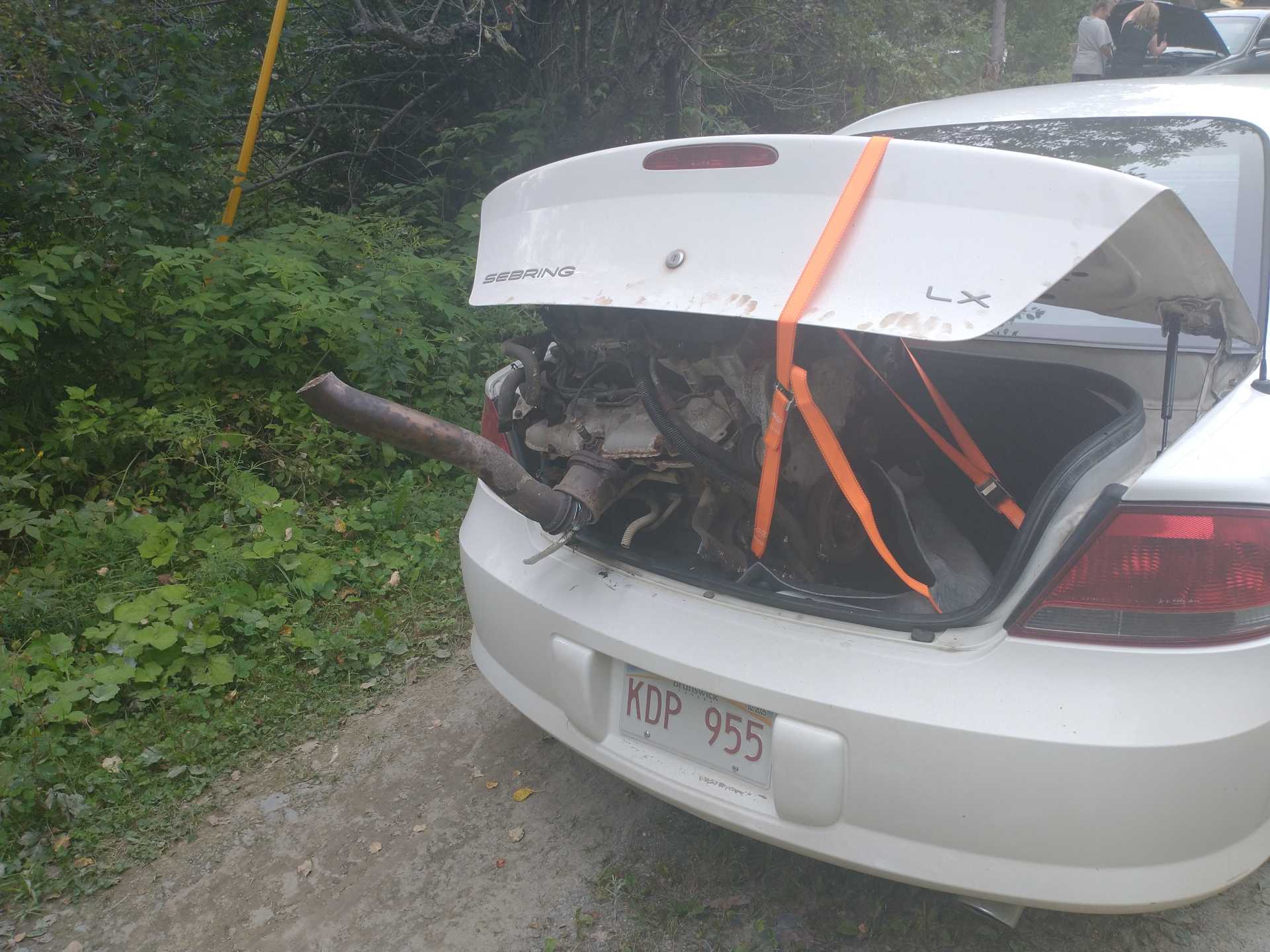

Well, I picked up the engine today, it appears in pretty good shape, rotates just with my hands on the crank pulley, but has the compression bumps (seems harder to turn over with a ratchet through the compression than my Fiero currently). It was loaded in my trunk with a backhoe, I drove with it in my trunk for 250kms, and unloaded with a lawn tractor with the arms on the front, worked surprisingly well, my Sebring is a beast haha.

Kms not miles, it's about 105,000 miles, I will replace the bearings, maybe not the rings, pmbrunelle overbored the cylinders and installed slightly undersized pistons and rings to deal with heat from the turbo, I figure any wear on the rings/block now should be equivalent to that, but I'll keep it in mind, as I open up the engine, I'll obviously replace anything that is obviously worn/broken.
