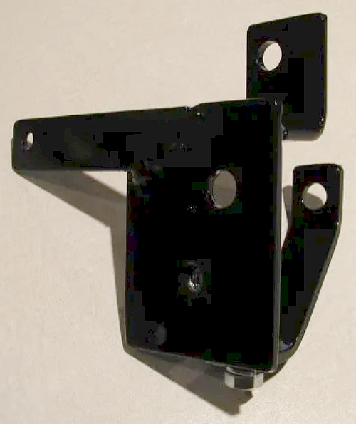

Thx for pointing me in the direction of Dodgerunner
My pleasure. I'm a satisfied customer of his, and I'm happy to spread the word.
I've replaced the tensioner itself once in the dozen years I've owned mine, but the custom made bracket is bullet-proof.
Spadesluck
APR 01, 01:43 AM
I have the same tensioner on mine as well. 2019 when I drove to Carlisle I was probably one of the few fieros there not squealing on startup. Ha

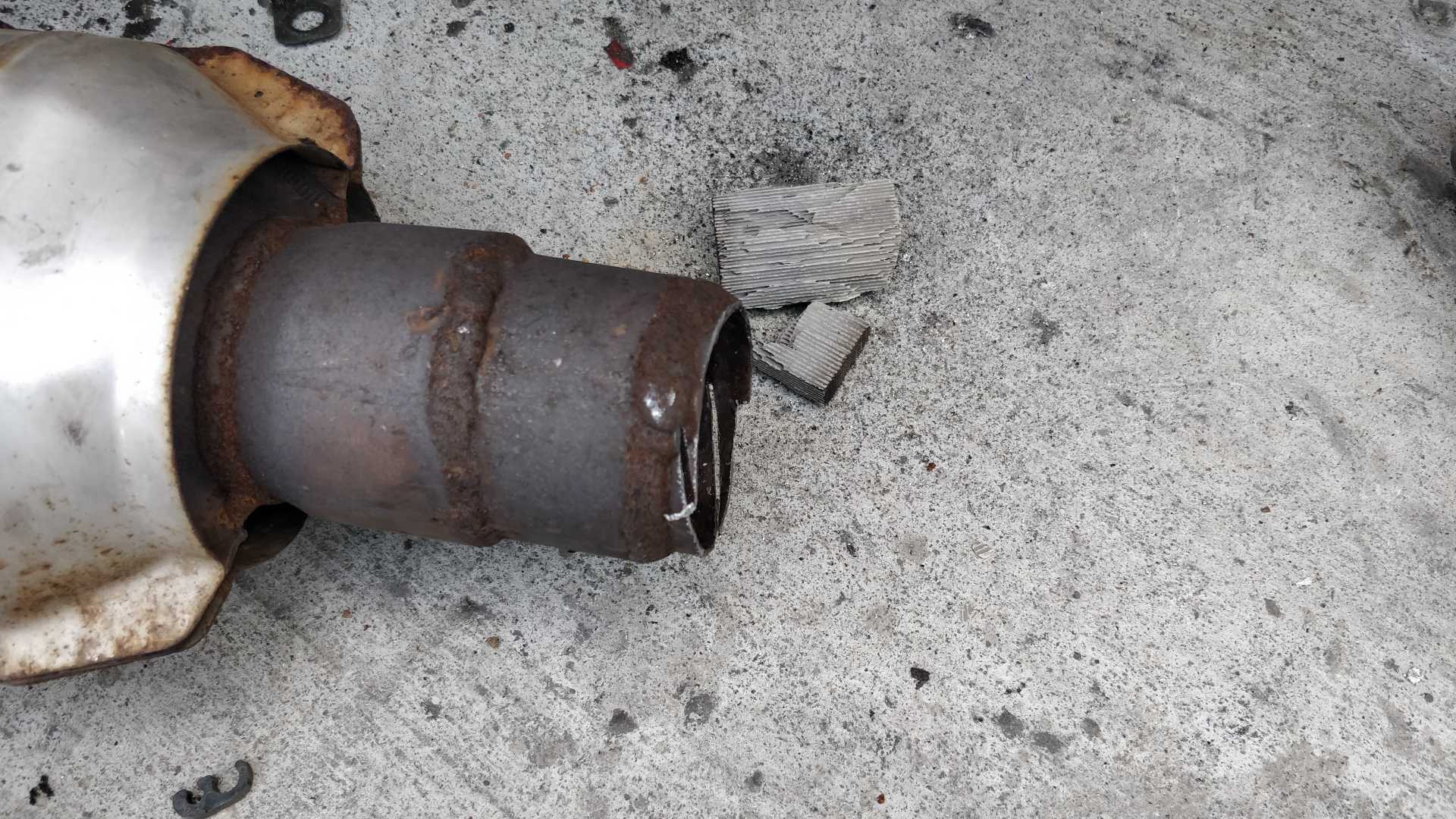

Mid day update. I've been a bit under motivated as the weather has gotten hot. I managed to get outside today.

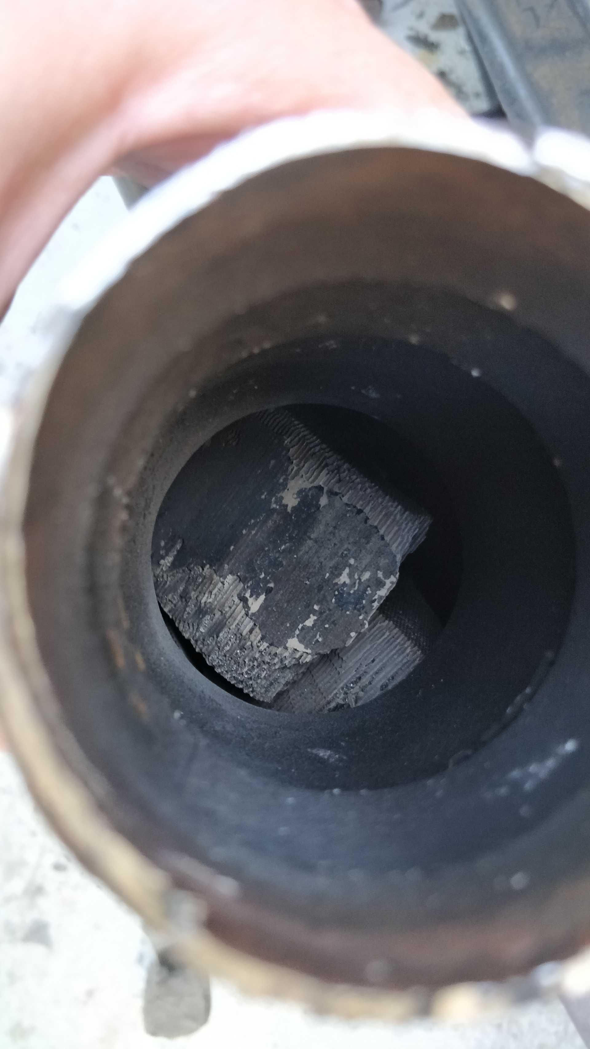

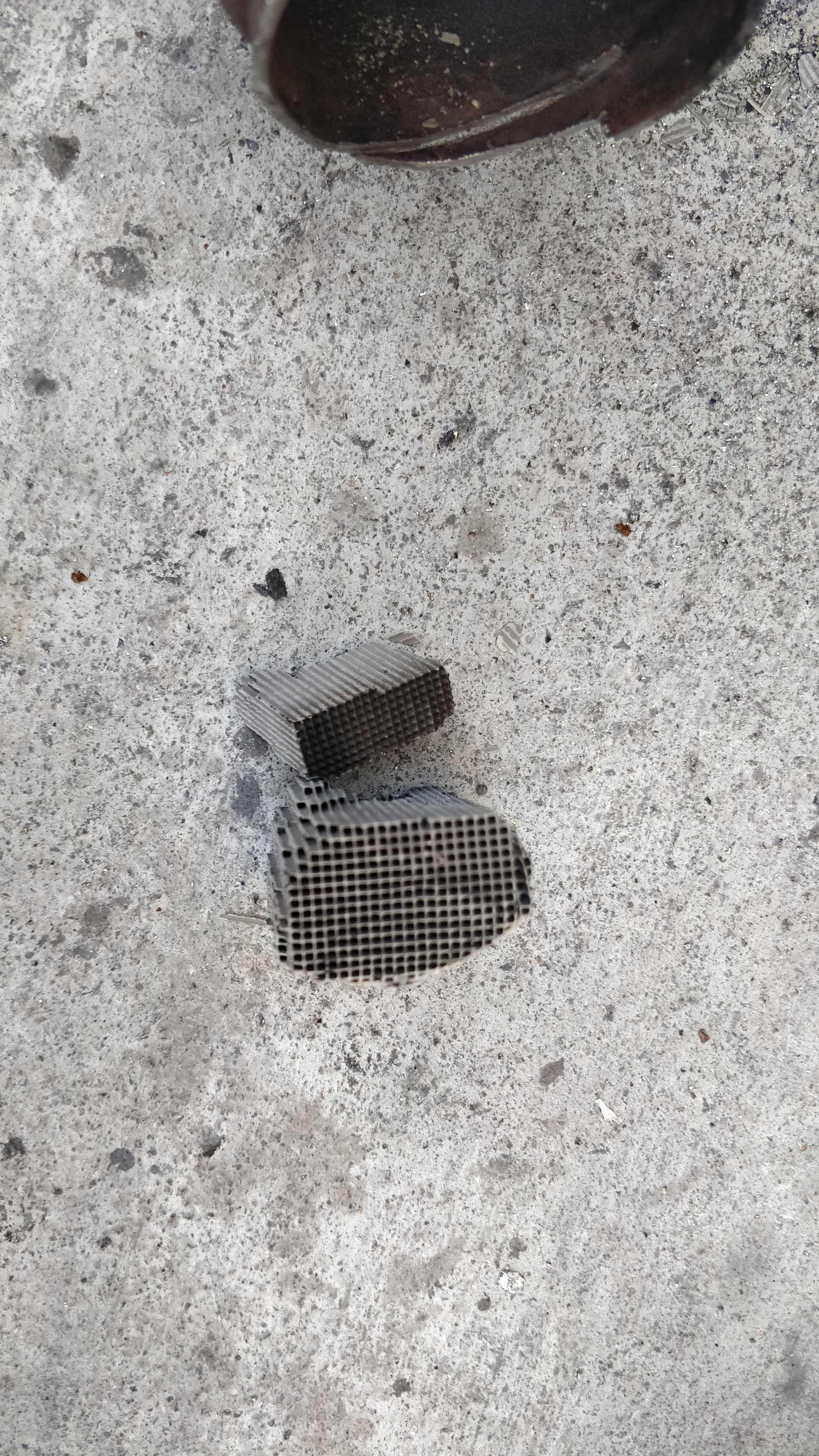

I cut off the CAT for inspection. The amount of smoke that this was puking lead me to think its probably toast even tho its only a couple years old. Sure enough as one side comes free i see CAT guts.
These fell right out

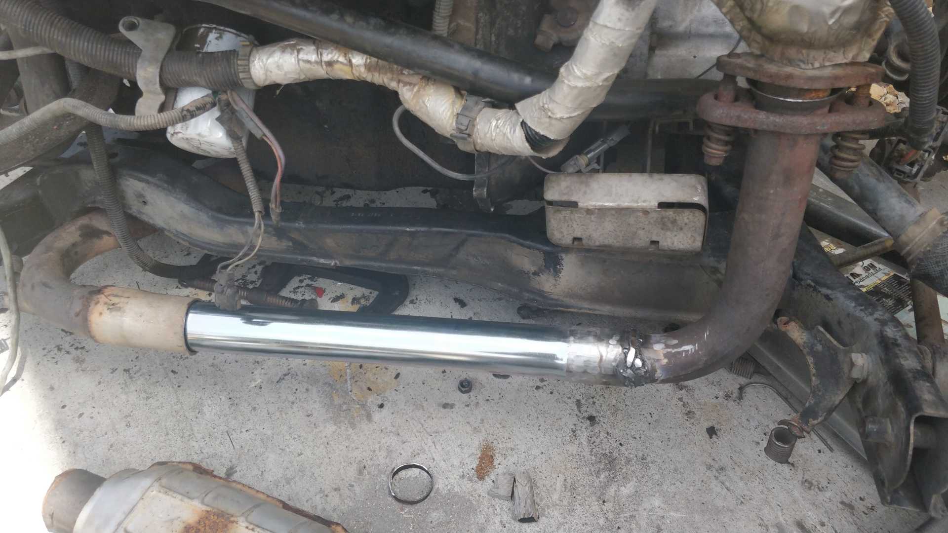

Apparently CATs are in high demand especially CARBs approved ones. I noticed the Fiero store sells one from Walker. I went to Walker and found a CA part number. I found it on Amazon for a deal at $250. Hopefully its not counterfeit or if it is hopefully it has the right numbers stamped into it?
The dead CAT was for 2.5" they welded in a bunch of step up pioes. so i started repairing the section.

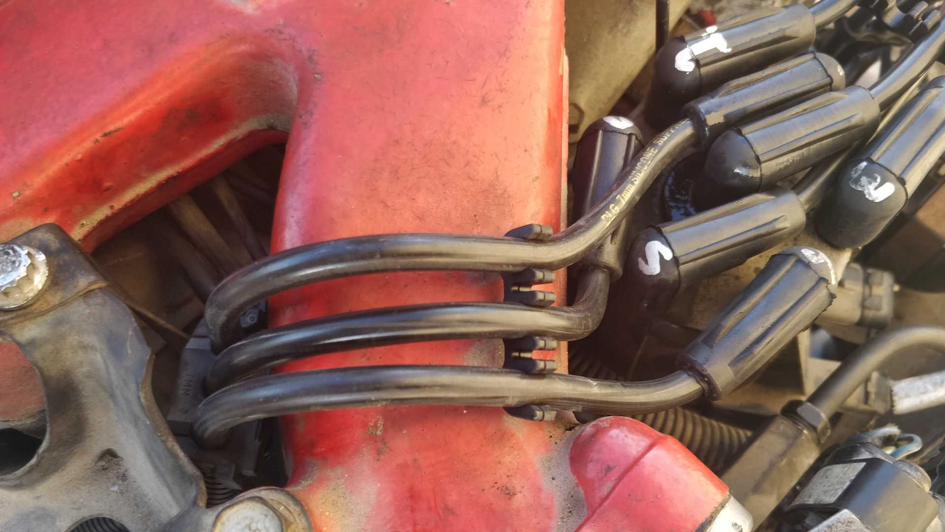

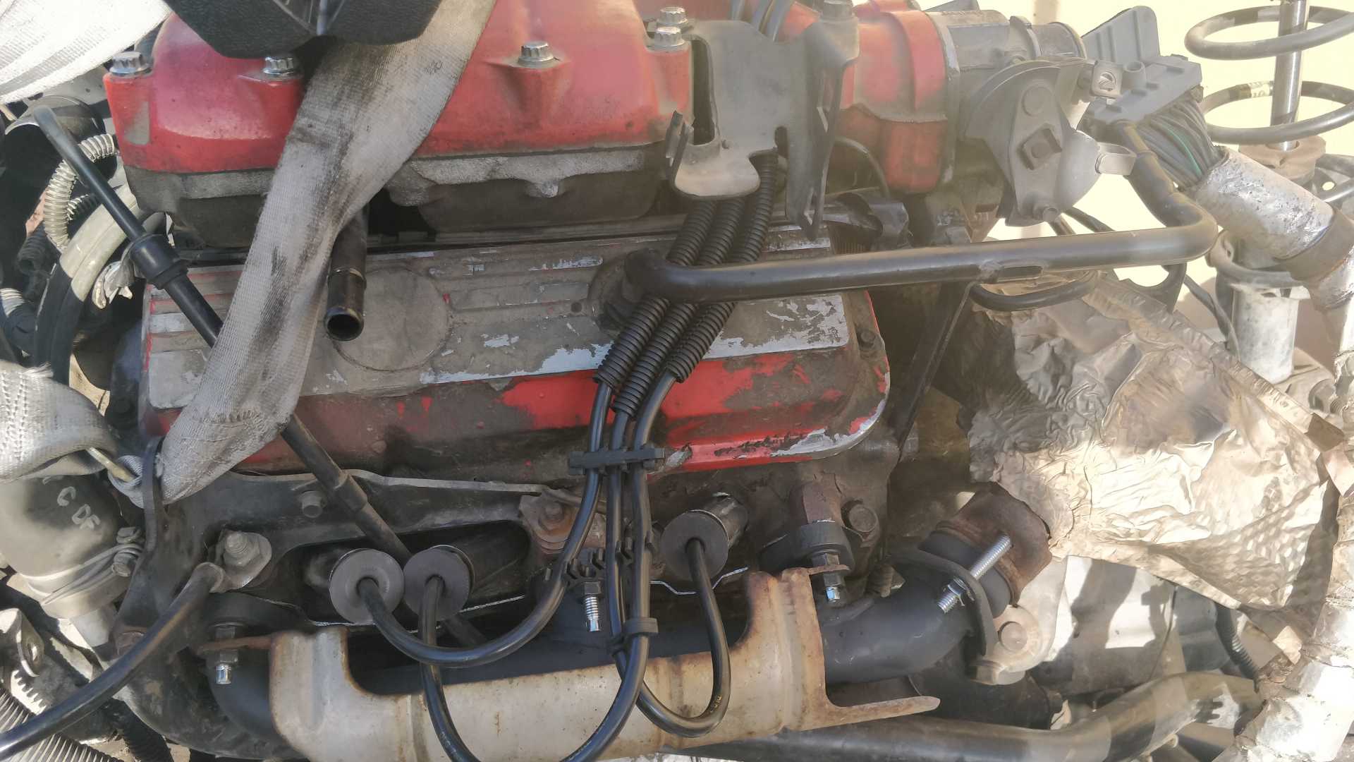

Evening edition

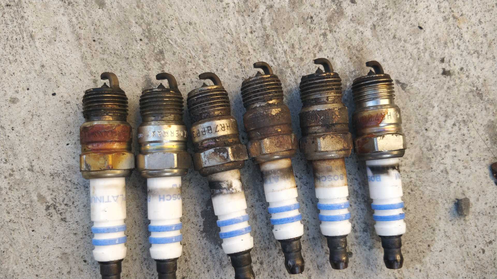

I went out and did plugs and wires. I gapped the oem plugs to . 045 torqued them down to 12ftlbs with some anti-seize.
The plugs that were in it were some fancy made in germany numbers.

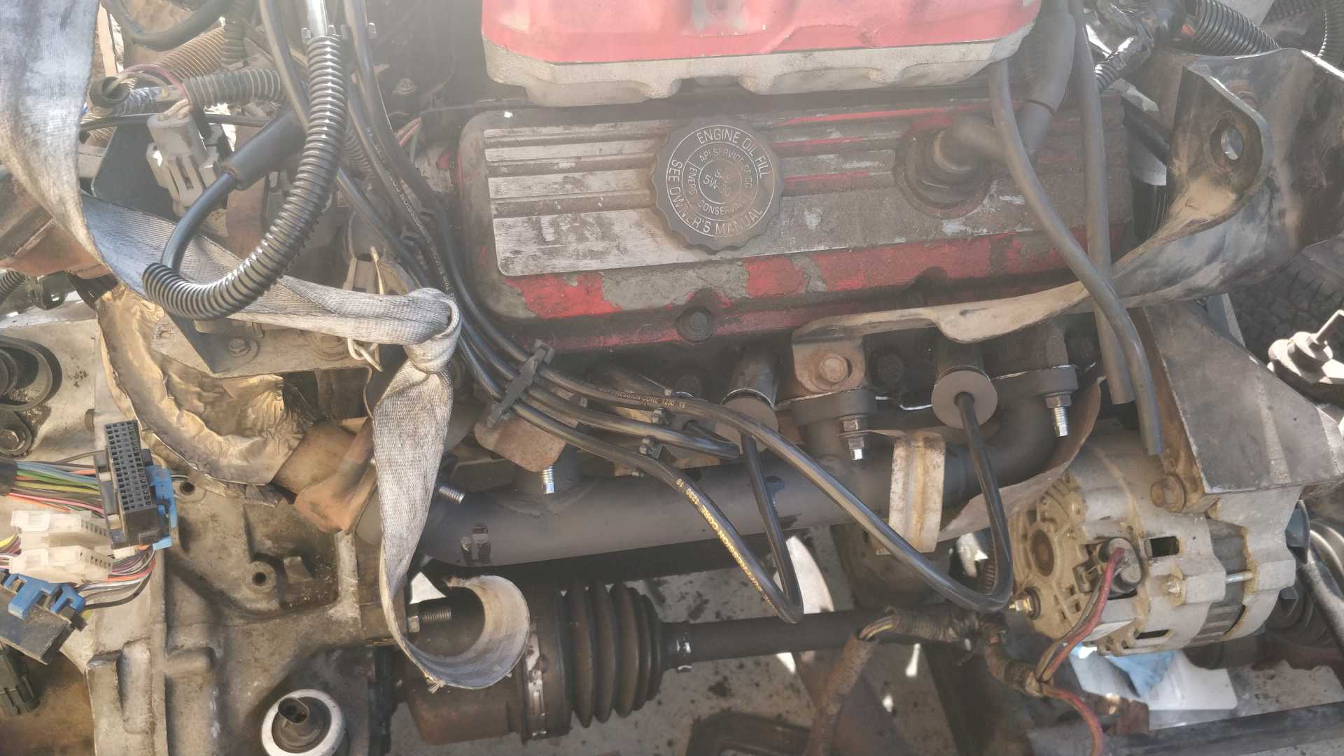

I greased everything and numbered the wires on the distributor.
So tick this one off the to do list.
APR 02, 09:47 PM
| quote | Originally posted by skywurz:
 | | CLICK FOR FULL SIZE |
I'd hazard to guess that the gap in those old plugs was more than .045". Any chance you measure a couple, just out of curiosity?
skywurz
APR 02, 09:58 PM
I didn't bother. They looked like iridium and its typically recommend to people not to gap iridium due to the fragile core. Secondly people seem not to know that plugs should be gapped. Also they were obviously wide lol. [This message has been edited by skywurz (edited 04-02-2021).]
APR 02, 11:25 PM
| quote | Originally posted by skywurz: , ...they were obviously wide lol.
That's what I thought from the picture, which made me curious. They were probably at least .060"... which is what's specified for the duke.
