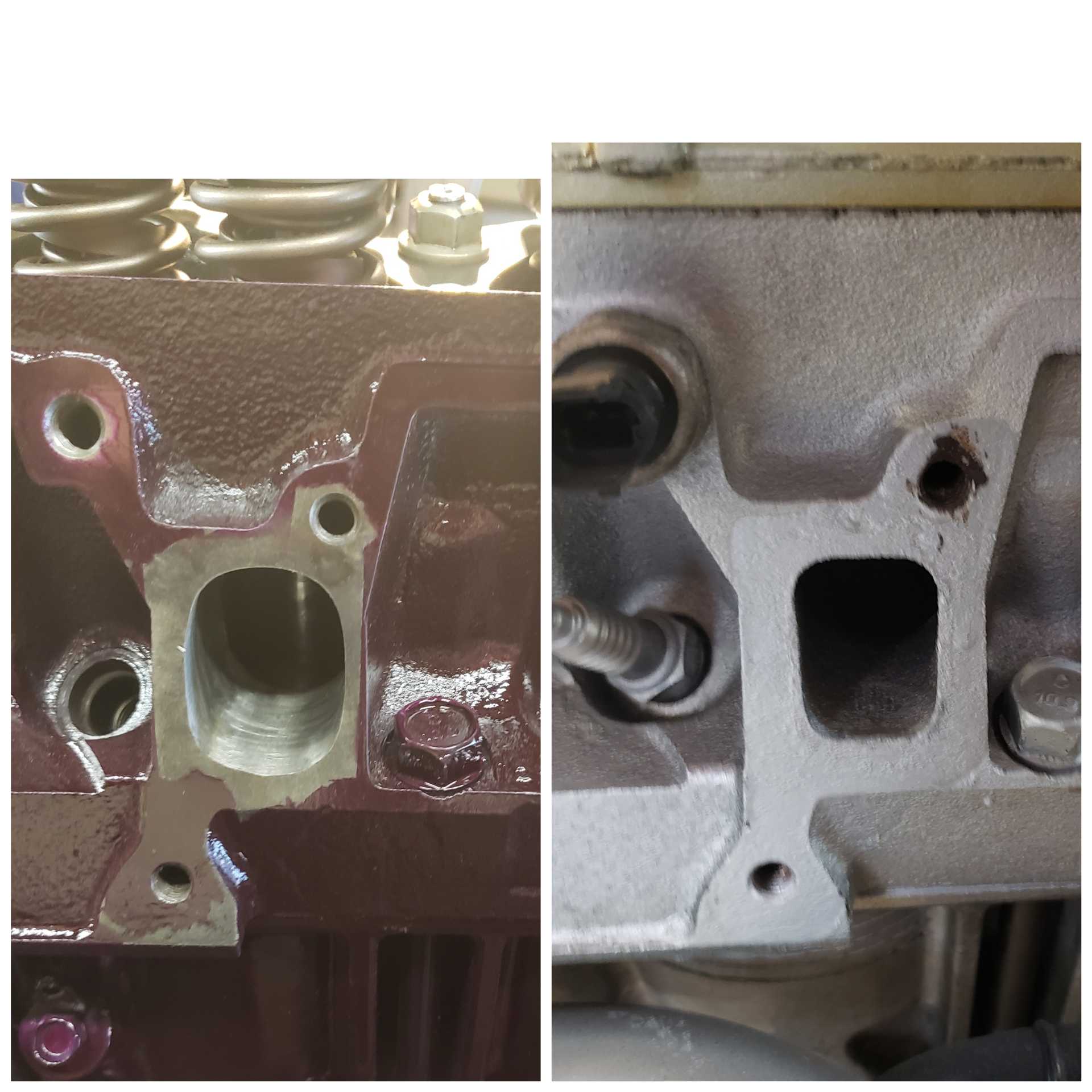

Here are some quick head comparison photos:

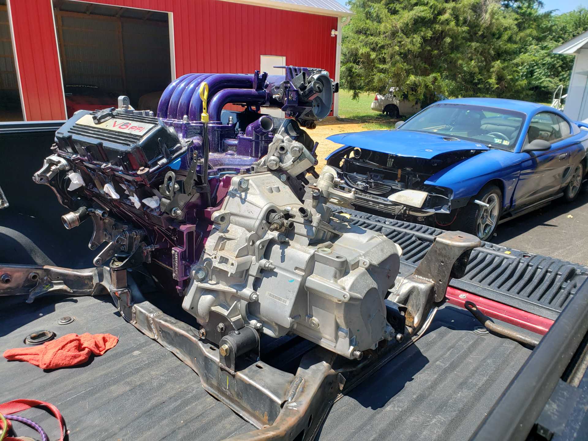

Here is how it looks right now:

Looks great, Spadesluck! That 6 speed is pretty nice! I'm jealous.

Are you installing the F40 "as equipped"?
I am very intrigued by Fieroguru's 3.09 FDR swap. Priced a few UK F40s this morning.
The most expensive one was, I think, ~100 pounds, UK. Shipping would have to be a heller, though.
As is, I am not that deep in the pockets to try that adventure.

The Allante intake is very well built honestly. I did port it some to match the heads but there was not much work to be done. If you have ever had the chance to look at one you will understand there is a big difference between the stock intake and Allante setup.

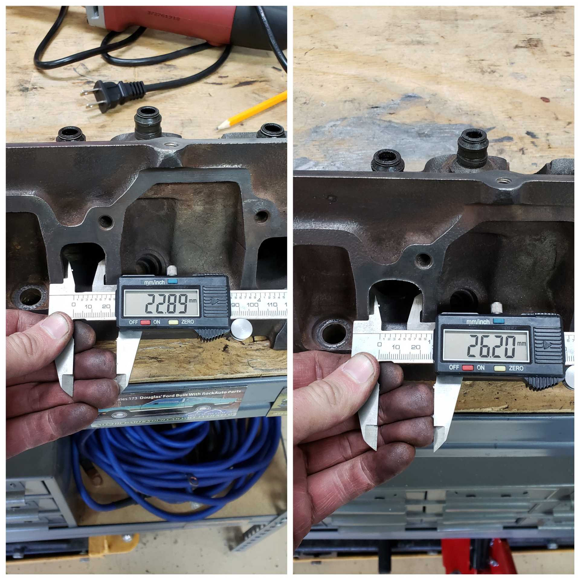

No, I did not do any flow testing as this was just all done in my garage. This has been a learning experience for me being only my second head porting I have done. Only thing I did was weight the heads before and after just to see how much material was removed. Ironically I removed the exact same amount on both heads, 1.3lbs each. M goal is not to set the world on fire, just to learn and have fun with it.
