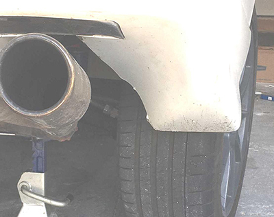

I am pretty sure the issue is with the rear tierods. They are either:
1. Mounted on the bottom side of the steering arm (it should be on top) - would have required modifying the taper, but I have seen stranger things happen. 2. The tierod has been modified to be shorter (mounting location on the cradle moved or spacer block added - both have been done before).

I agree. He said this happened after an alignment at a shop so it wouldn't surprise me if they put the rod ends on the bottom vs. the top.
I lightened up his image in Photoshop vs my car up off the ground and you can tell the rod end is lower on his car. His is at the center of the wheel which would indicate the rod end is at the bottom of the spindle. Mine is above the center of the wheel which you can see is mounted correctly.

| quote | Originally posted by fieroguru:
With the tierod mounted from the bottom, wouldn't it be awfully difficult to tighten the nut, as the taper wouldn't be holding the pin tightly... but I guess that's the "modifying the taper" you're referring to!

So, thank you everyone for your help.
It came down to something simple, I am a complete and utter idiot.
The tie rods were on upside down in the back..in my defense, they fit right in..
This is the third time I have rebuilt the back suspension of a pre 88 Fiero, but I had never left so much time inbetween replacing parts...more pictures next time I guess!

You should probably run a reamer through the steering arms to remove any distortion in the taper cause by installing them backwards.

Will do! But wouldn’t that make it bigger?

Wow man! I'm happy that the mystery is solved. Looking at your pics (I still can't get to the video) that was going to be my guess too, but everyone beat me to it.
You're lucky you didn't crash.

If should only be used to remove the material that is deformed into the tapered section. You don't want to enlarge the majority of the hole.

I am glad you found ths problem. I hope there was no damage to the knuckles.
