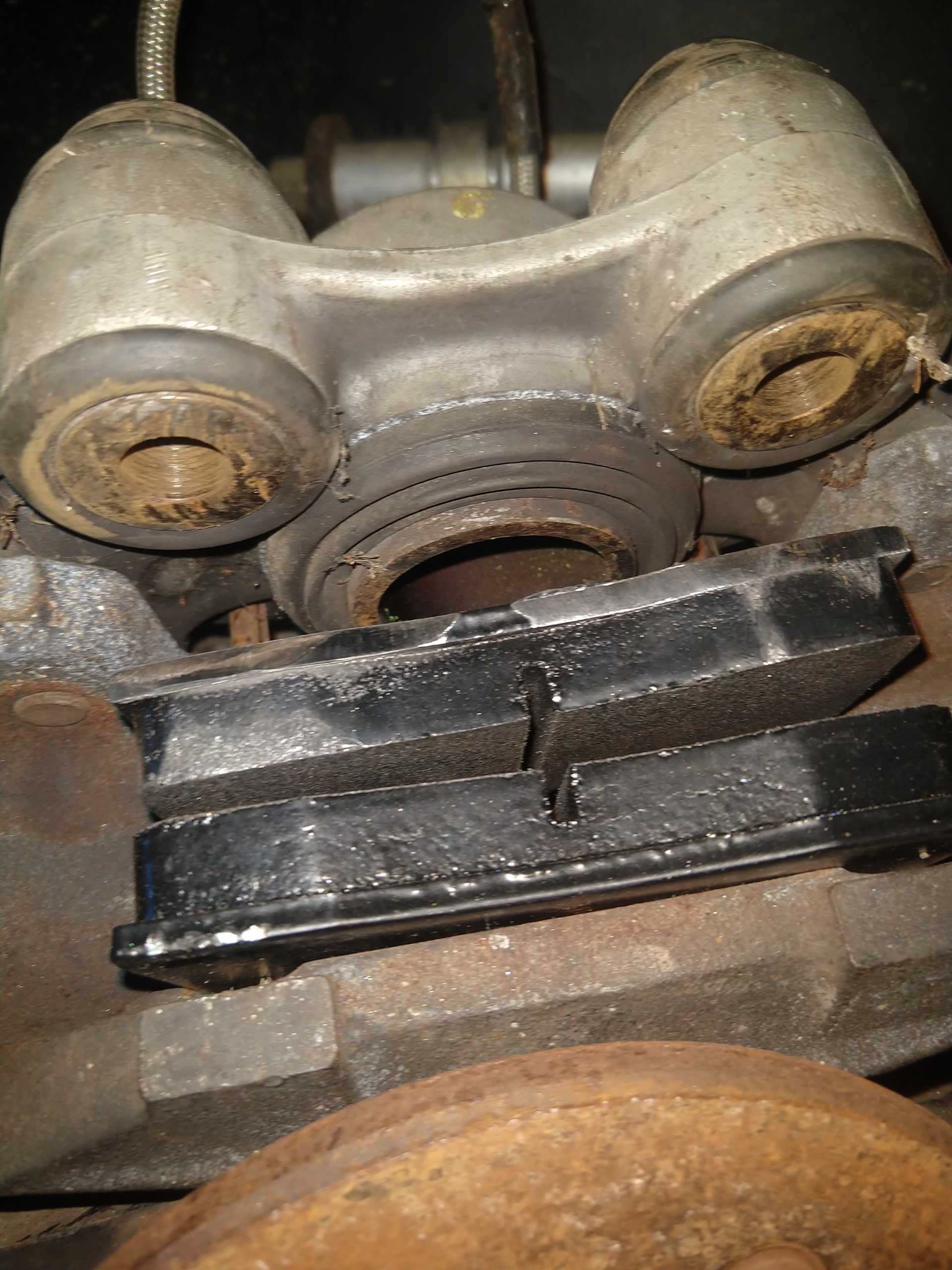

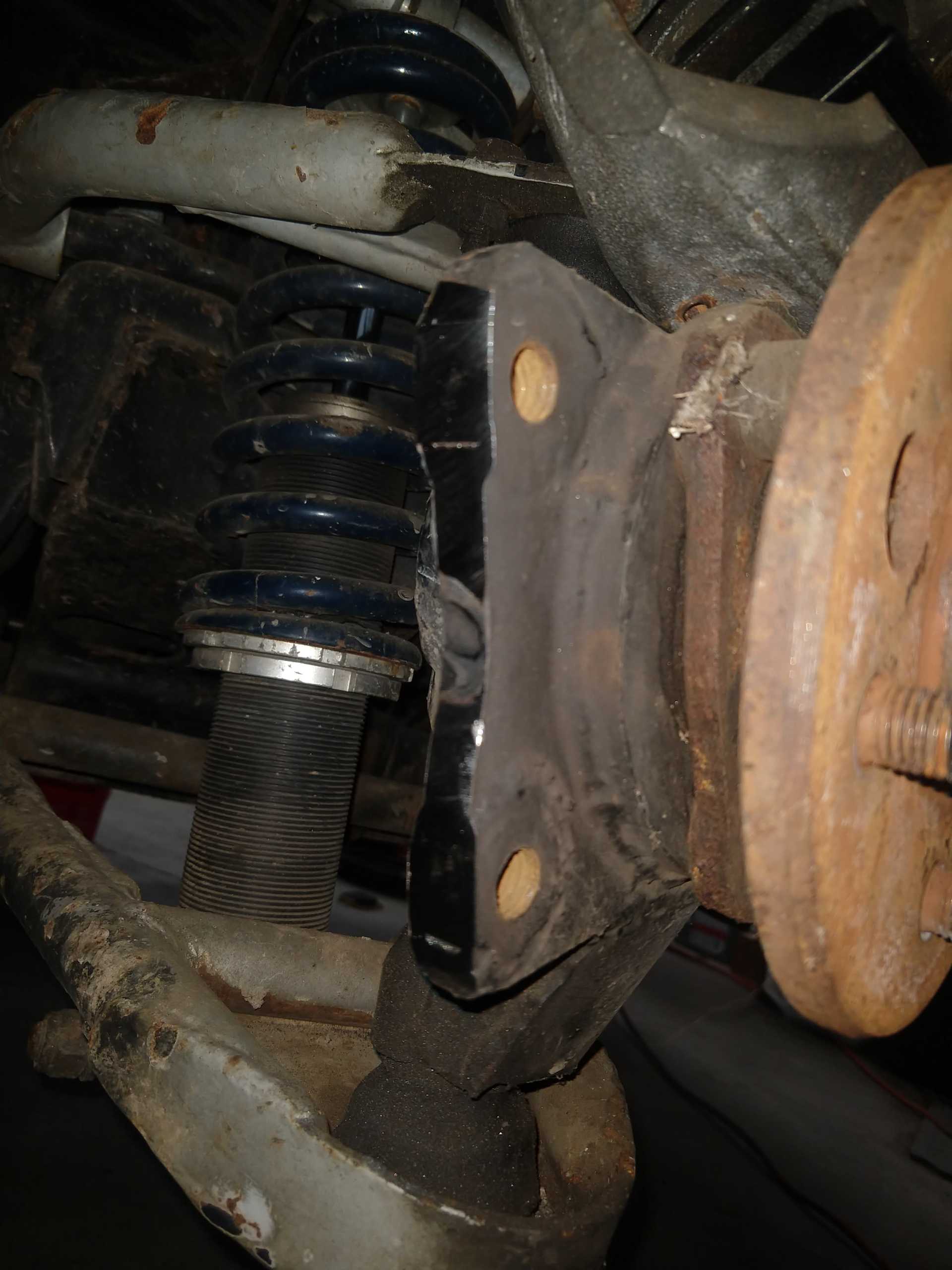

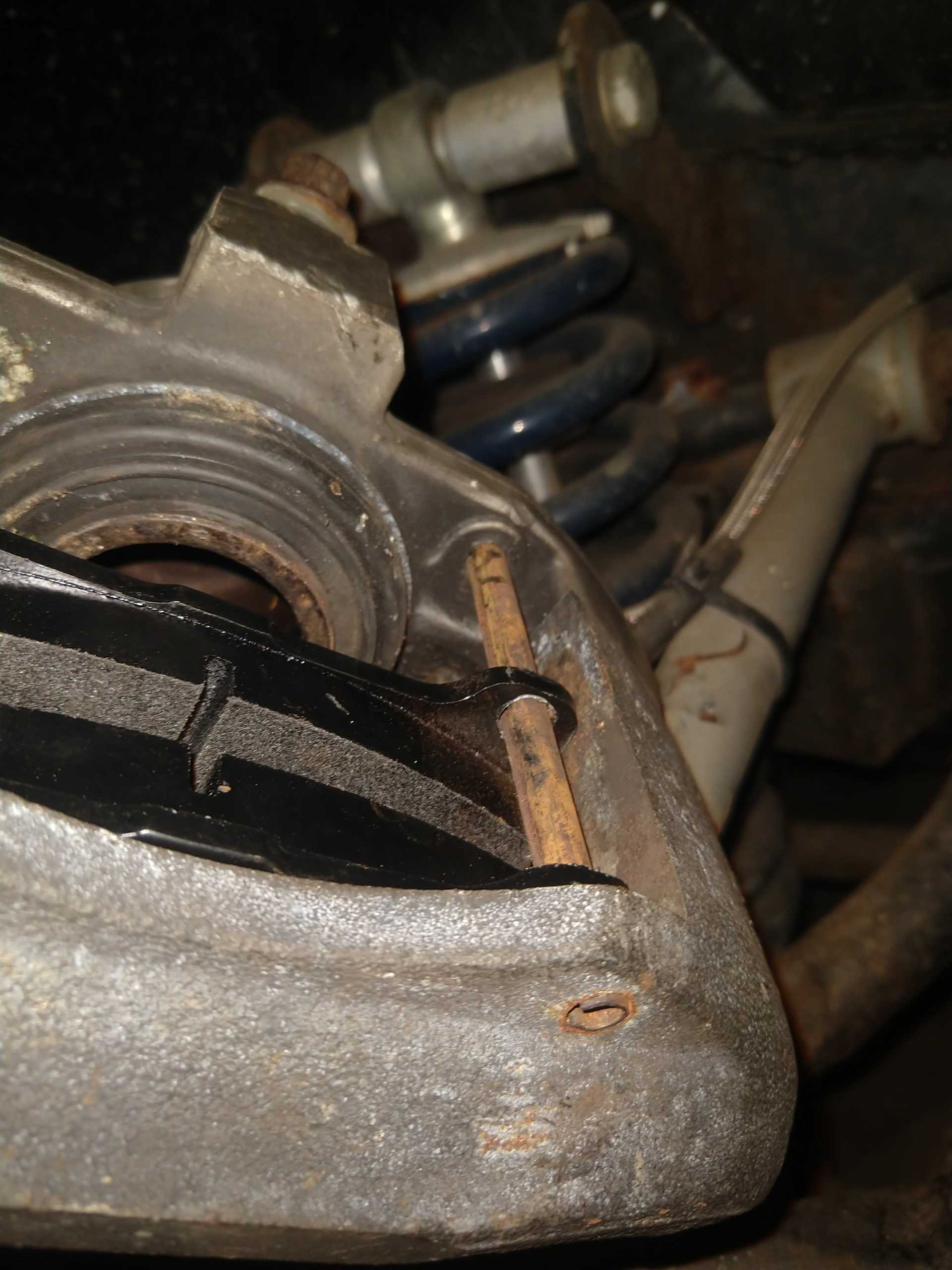

Managed to get the brakes COMPLETELY figured out. The willwood sized DTC70/60 pads are great, and needed minor grinding on the knuckles and pads to fit, as seen here. Also the pin slider holes were drilled out. These brakes combined with stock rotors and calipers are absolutely flawless, perfectly consistent, great bias with the 70/60 front/rear combined with the OEM bias valve. Extremely happy here, and I doubt I will be changing these any time soon. The only thing I may do is go for a 13inch viper rotor but only after I add a bunch more power than I have now.

Would the pads fit unmodified with a little more grinding on the knuckles?

Probably would NOT fit unless you modified both ends, you are already starting to get into the bolt holes and the pads are easier to grind so it only makes sense.
