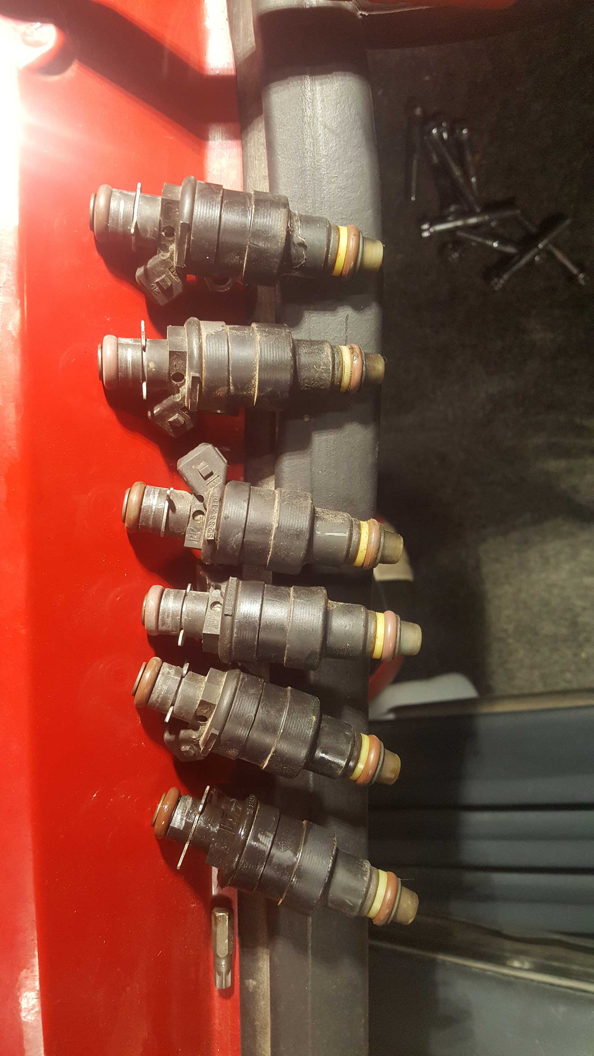

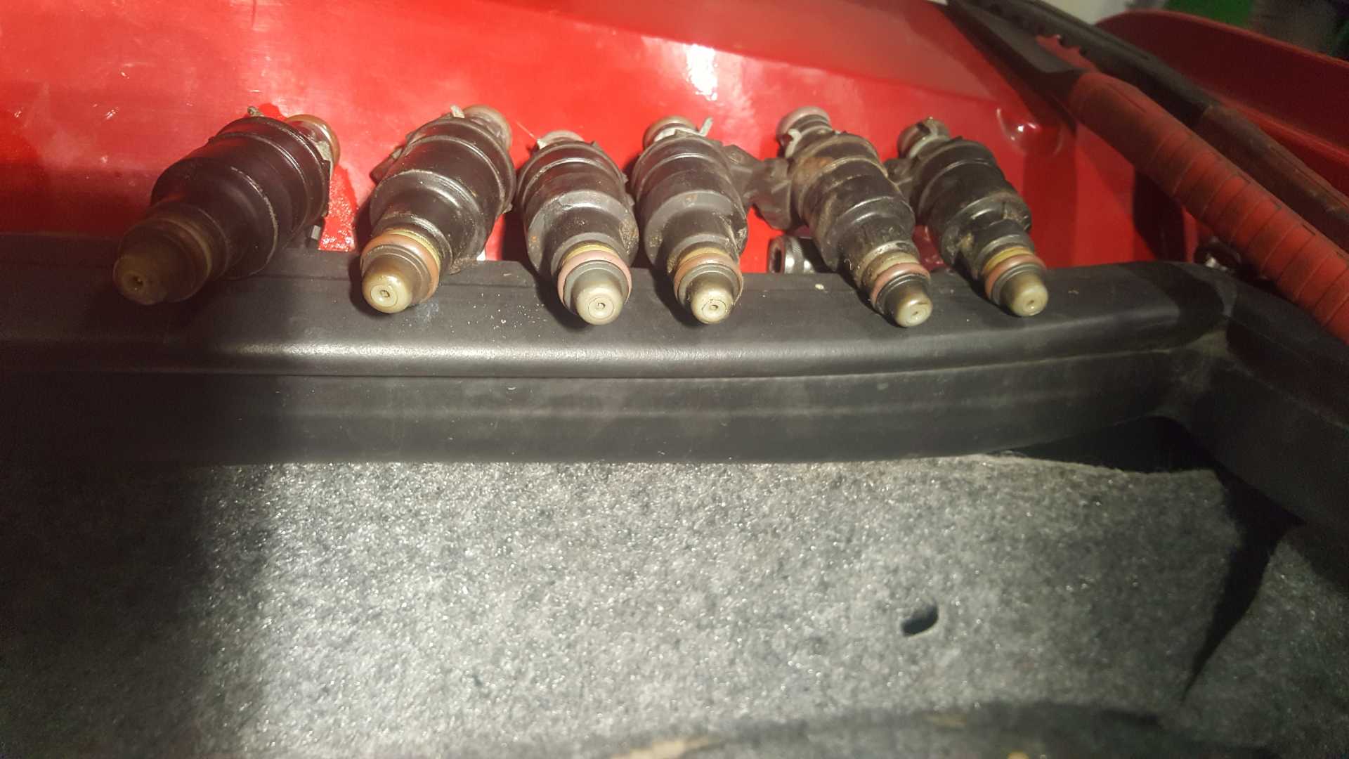

Alright here's the injectors in my opinion they don't look bad at all?

| quote | Originally posted by Monkeybean007:
I'm not sure what looking at them is going to tell us.
Did you do the fuel pressure leak down test before you pulled them?

APR 08, 04:10 AM
I thought I would pull them out first and make sure they didn't look like garbage since I've seen some preety bad ones that are stock that look super bad so I thought I'd check with that
APR 08, 04:54 AM
While you have them out, check the resistance of each injector since they're now easily accessible. Maybe also use a battery to make sure each one "clicks". Details on doing this can be found online. [This message has been edited by Patrick (edited 04-08-2020).]

APR 09, 02:20 AM
Checked them for resistance and for clicking good in both categories.
