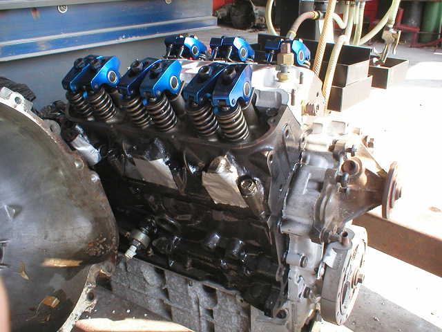

My motor:
If you are truly worried about clearance, you can always run the gasket from other 2.8 motor as an "EXTRA" one - I'm talking about the thin flat one that looks like someone scrammbled cardboard and rubber together...
If these rockers fit the stock valve covers, why did you eventually make valve cover spacers? Did something change?
