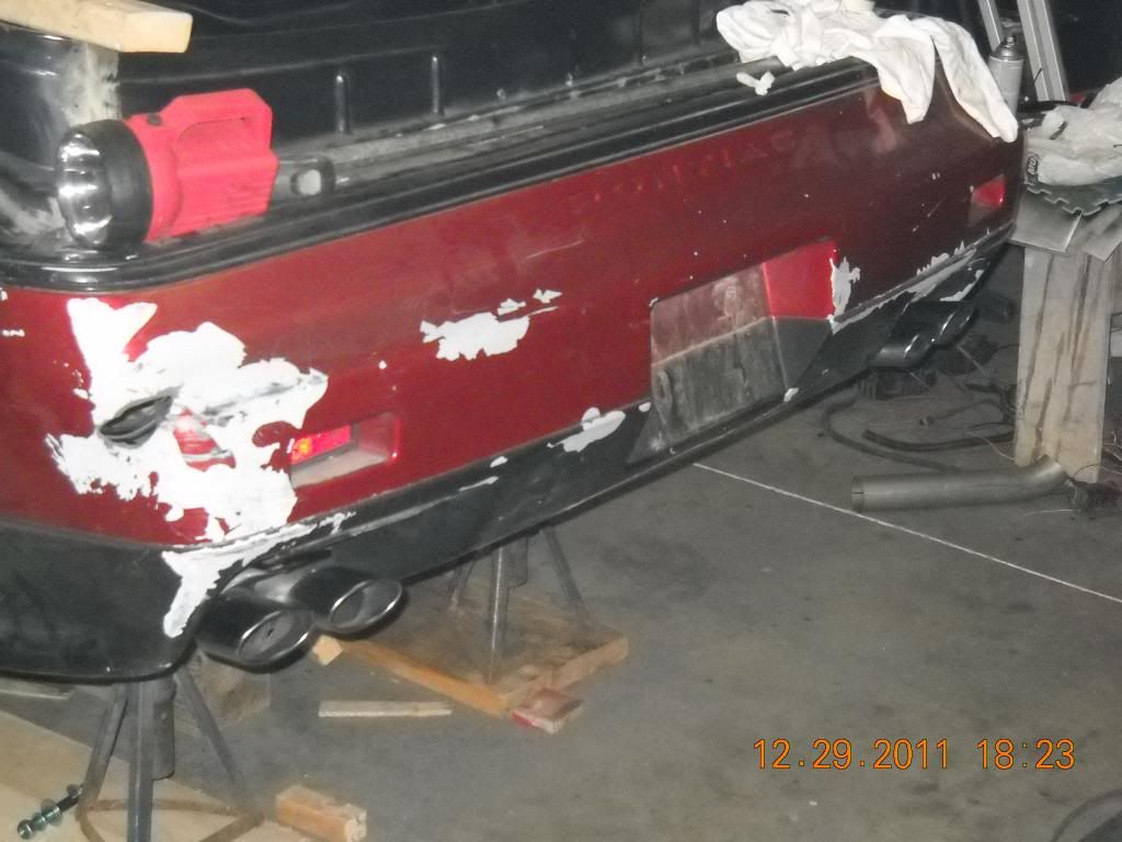

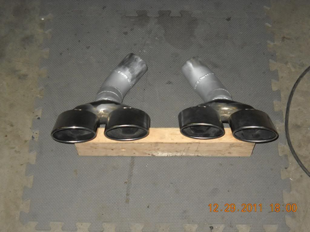

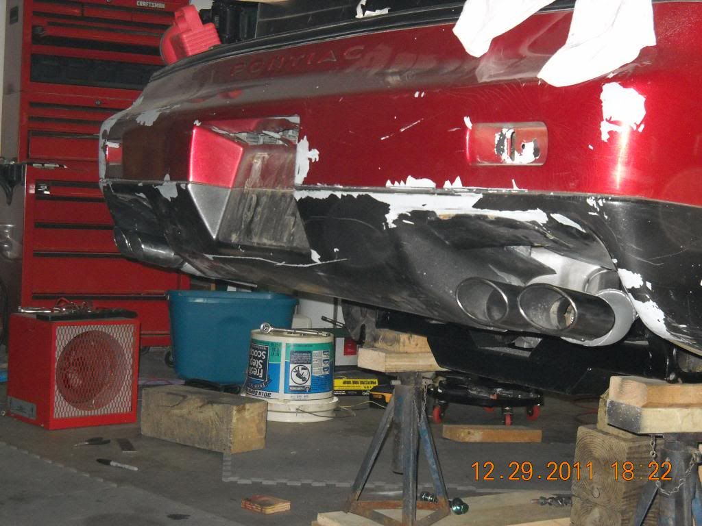

Update, I finished the wiring, or at least enough to start the engine. Still working on the exhaust system. I have the mufflers temporary mounted so I can route the exhaust. I got some exhust tips from a Cadillac and modified them for my exhaust, here is a couple of pics.

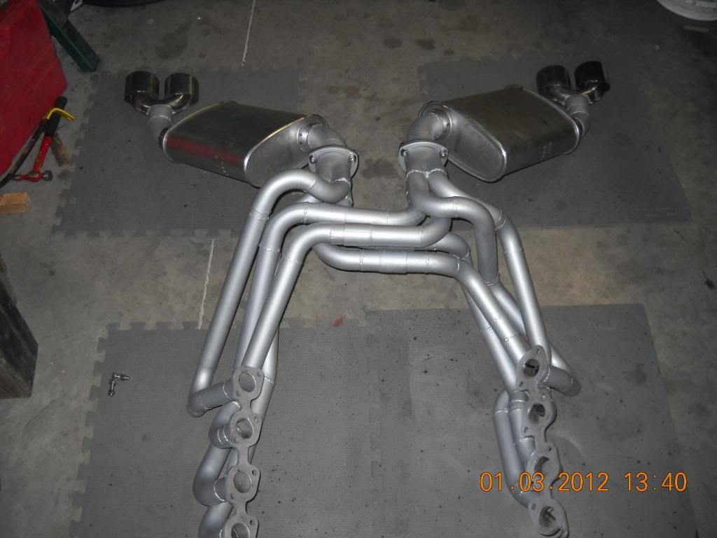

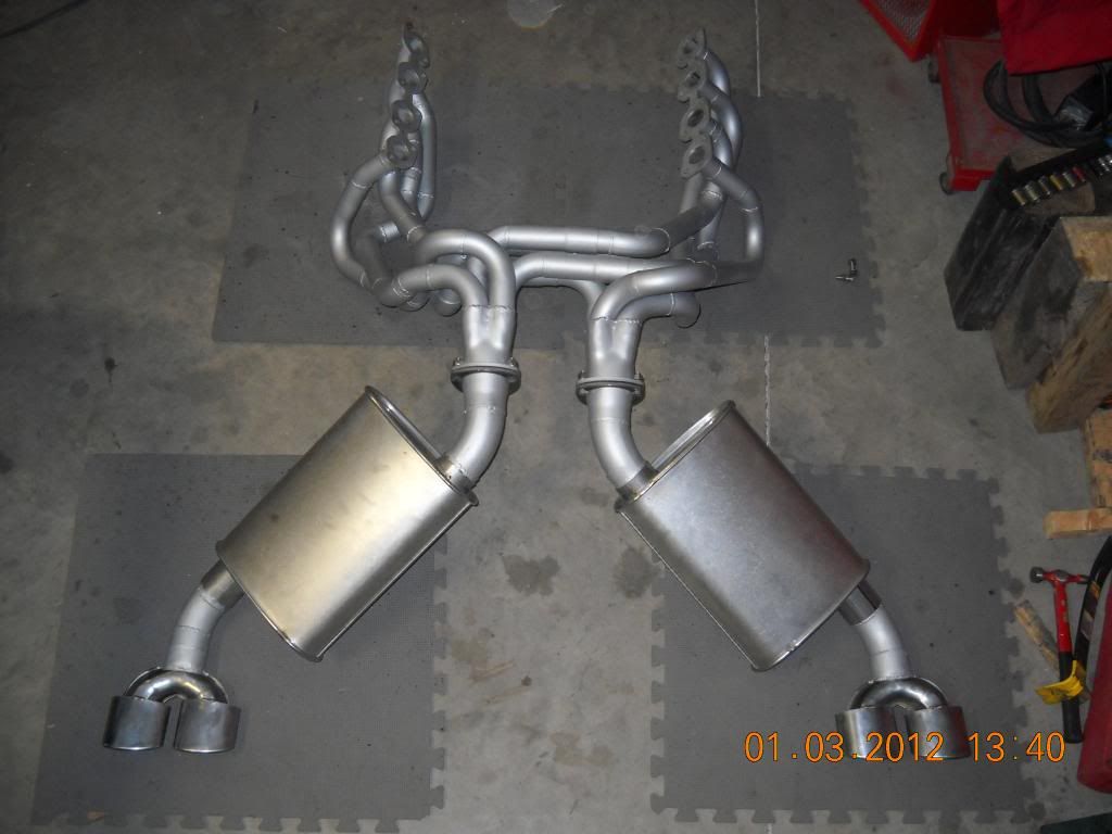

JAN 02, 04:19 PM
I finally got the exhaust system done ! Here it is, pretty awsome !

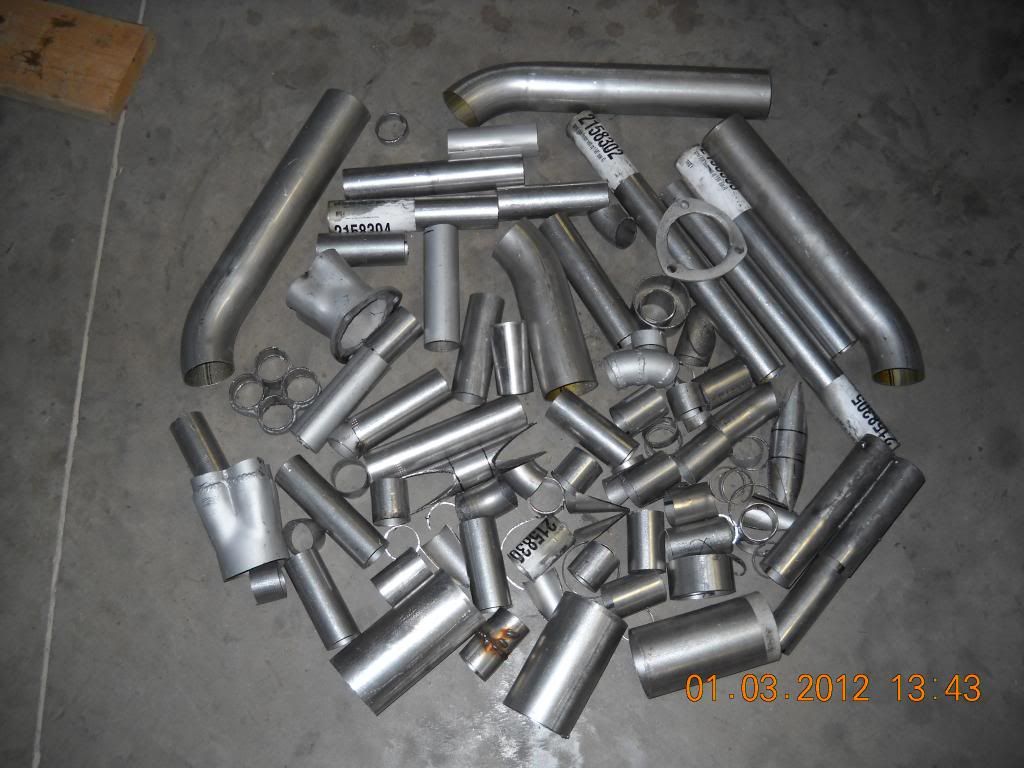

Nebraska
JAN 02, 04:21 PM
What is more awsome is what was left over from two weld up header kits and two U bends from JEGS !
