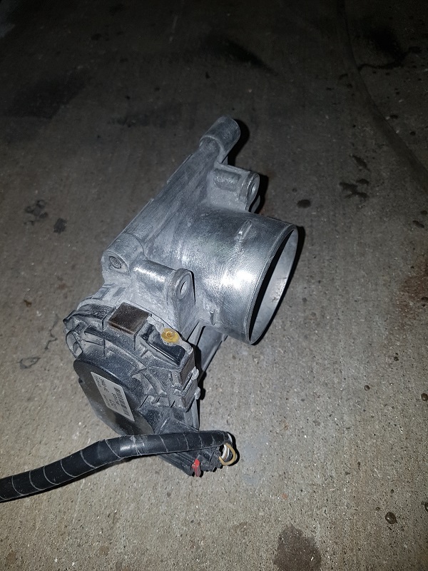

I'm still flipping back and forth between two projects...the active spoiler mechanism and the engine cover. I took some time to work on the "fake" throttle bodies.
This is the Mazda 3 throttle body that I'm using (posted this pic earlier in the thread):

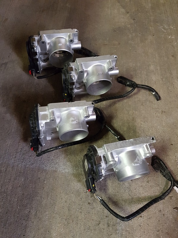

After cleaning them all up and sanding down the scaling, I ground off the top coolant tube to make them look just like the OEM Lambo throttle bodies and then cut out the butterfly valve (I'll need to use them as part of the air intake to the real throttle body so I obviously don't want any flow restriction). Finally, I masked them off and gave them a coat of paint to make them look like new again:
Now they look pretty close to OEM.
