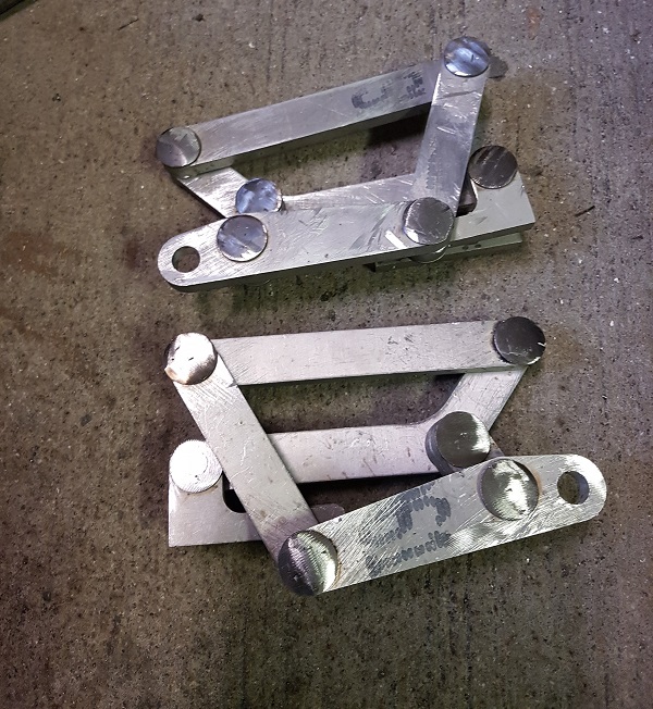

Second hinge complete. Very happy with it...nice and tight pivots. Slightly better than the first. This time I was clamping the pivots lightly as I welded them (though not too tight as I found out) and this greatly improved the joints. The first hinge is really good, but I may grind off one or two of the joints and redo them now that I know a better way of doing it.
Next task...the framing. I like the idea of the whole unit being removable as a single piece (like the oem unit). The first version wasn't done this way...each hinge was separately bolted to the car and individually adjustable. Sounded good in theory, but turned out to be incredibly difficult to get everything properly aligned.
RCR
JUL 16, 08:54 PM
Well, to quote Shemdog, those are pretty slick. Well done, Neil.

Jeepers !!!! that hinge is SMOOTH Nice job taking advantage of your "downtime" there. The mind never stops eh' !
