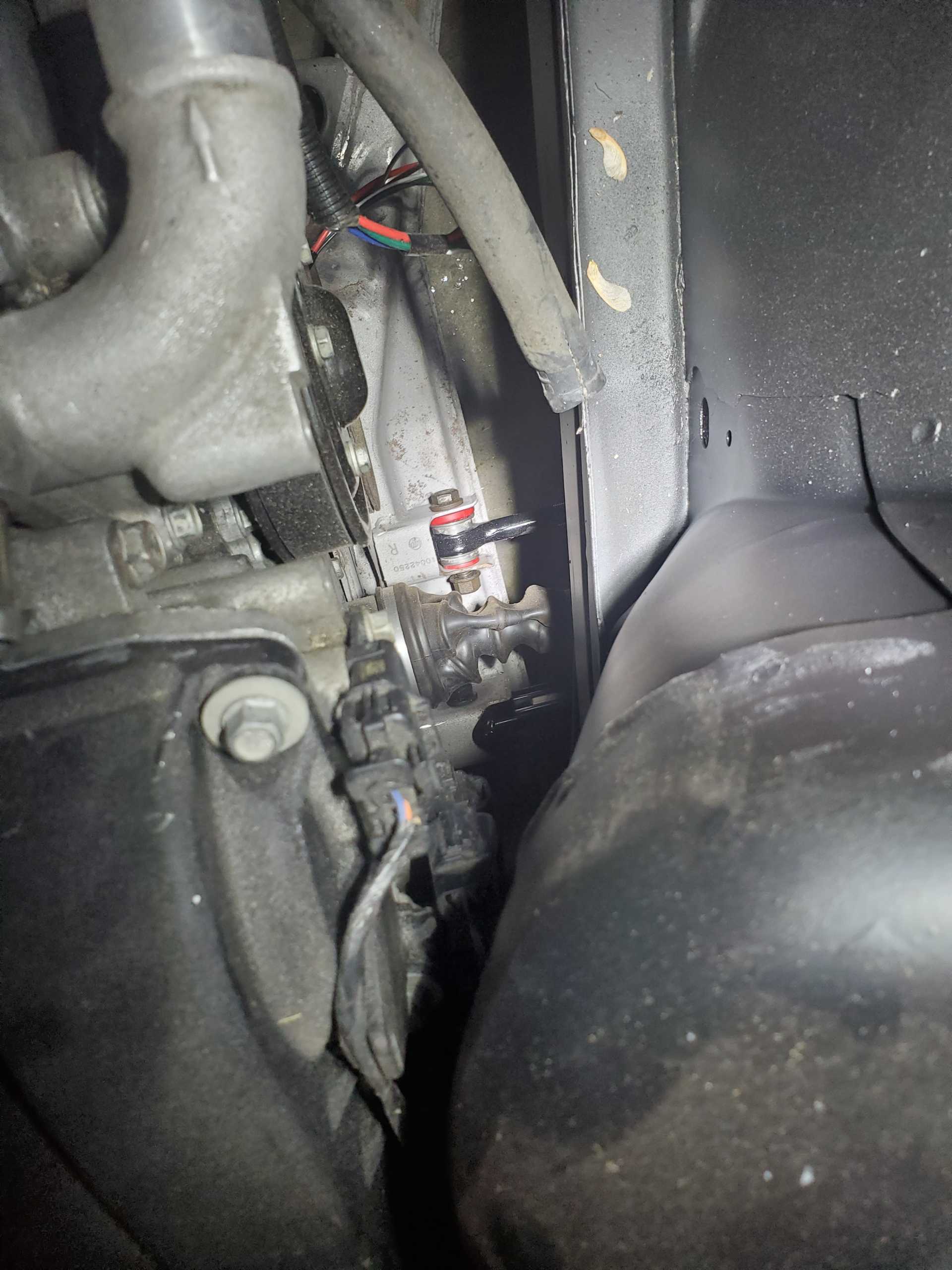

I got the car on the ground. No way stock cobalt axle will work, at least on the passenger side. Its actually pulling the whole driveline to the side, bearings are pulled out of the cup. I found a place that will make me some custom axles for ~$1k. Thanks for the user who informed me about the shipping customs fees associated with utilizing a Canadian company.
I'm not sure what I am looking at in your photo, but I would be interested in knowing how much longer your custom axles will be that the Consult axles.

| quote | Originally posted by RandomTask:
That's looking down at the PS shock tower.
Whoa!
I'm using the cobalt turbo axles resplined for a G6 cage/tripot with fiero outer stubs, which are still the same length as the stock or supercharged cobalt axles and although I had to offset the block/F40 to the passenger side just shy of two inches everything lines up with plenty of room for CV joint play.
Hindsight being 2020, I would have obtained some later model saab 9-3 9-5 axles and maybe found a working combo with them.. or had a shop remake the turbo cobalt axles, one two inches shorter, one two inches longer. If mine shear, probably on the resplined end, I'll look further into these options or go to DSS and get their SC Cobalt axles..
What axle shop/vendor are you going to be utilizing?

The Cobalt axle issue is due to old info and GM changing the differential offset with the production run of the F40.
People have used the Cobalt axles with the G6 version of the F40 by moving the drivetrain towards the passenger side. You guys are not using that version of the F40.
The issue is at sometime during the production run (2009 or possibly later) GM made the bellhousing on the non-GM metric versions deeper so they could fit larger clutch setups for higher HP and AWD applications. This moved the differential about 1" further from the engine vs. the G6 F40.
