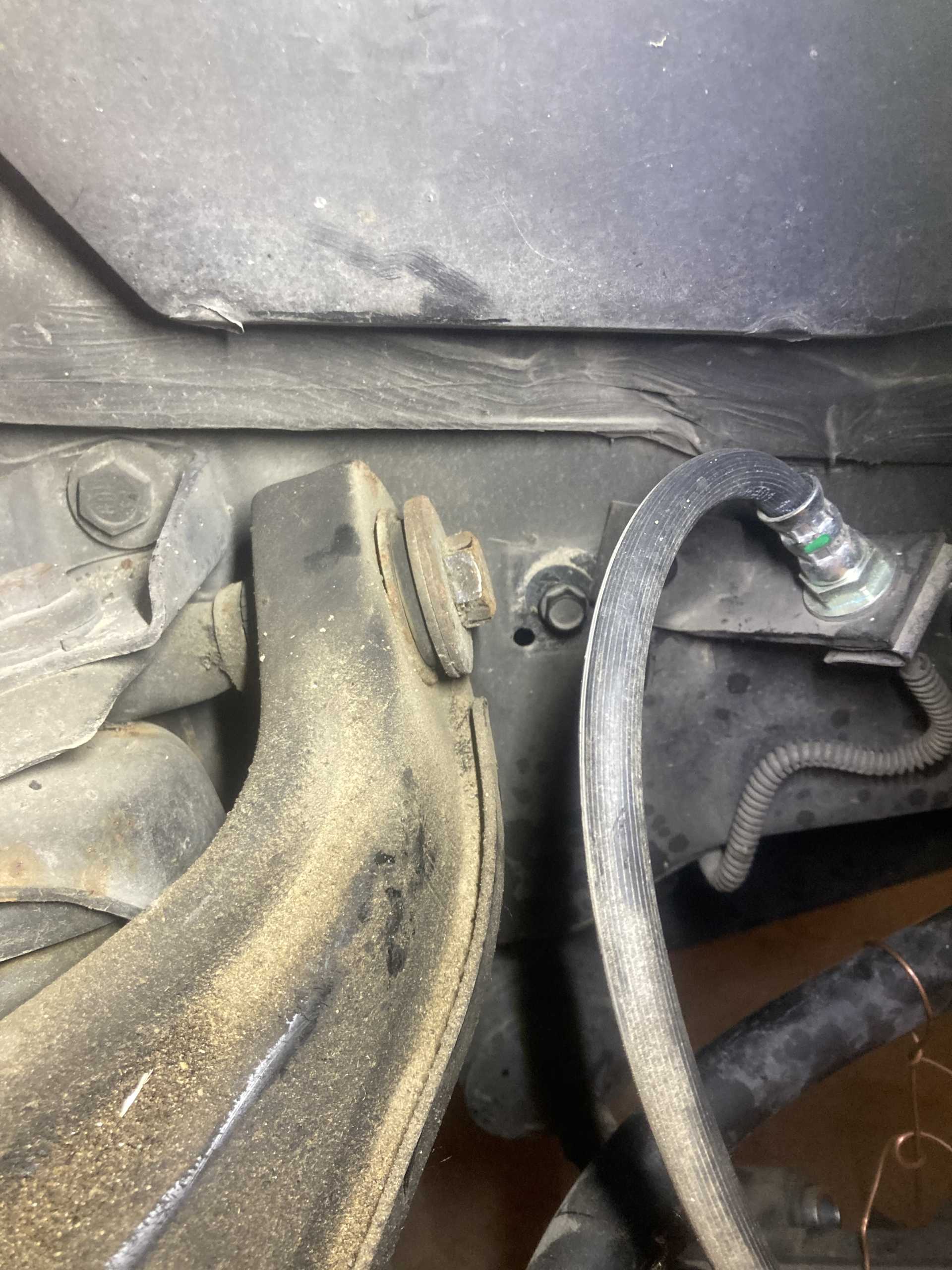

Thanks for your help, I installed the upper control arm, if I try to torque it to 66# it binds and will not move. I used the factory 6mm spacers.
I'm not understanding this, what should move with control arm and what should not ?

The control arm moves by twisting the rubber bushings. Human strength will be hard to move it very far. They are bushings not bearings. The bushing doesn't actually rotate around anything like a bearing around a shaft. it just twists the rubber.

Yes , I understand this now, thanks for the reply.

I forgot to tell you and I hope I'm not to late. Stock rubber bushings need to be tightened with the control arms at or near the normal ride height. The rubber needs to be NOT twisted with the car sitting on all fours. When the control arms move up, the rubber twists one way and when they move down they twist the other way. Their relaxed at normal ride height.
