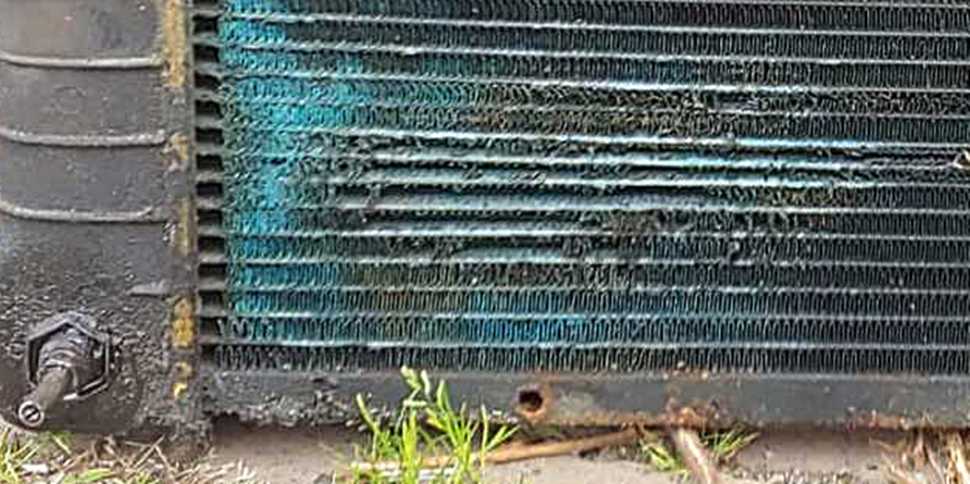

Rain and other outside Water = Polluted Water. You drive on the street then car gets way worse polluted water plus salt or other chemicals to melt ice plus god knows whatever else that leaked or spilled on the roads, P-lots, and more. Road Salt etc can take Months to Never go away in summer then Any moisture Reactivate this crap and spray on your car. That's if the crap isn't already on the car to reactivate.
IOW Even if you claim "I only drive in good weather," the road crap will get at the whole car. And part of why your old rad is toast w/ missing "fins" etc because crap react w/ thin Al fin materiel then nothing to support the tubes. So If the tank didn't fail, the tubes would have or did. Just 1 small section Blown Up from your pic so others can easily see the Fin Rot.

| quote | | And part of why your old rad is toast w/ missing "fins" etc because crap react w/ thin Al fin materiel then nothing to support the tubes. |
Yes. All kinds of crap can speed up corrosion of the very thin cooling fins on a radiator. Which has nothing to do with the fittings on my new radiator so I'm not even sure why you bring that up.

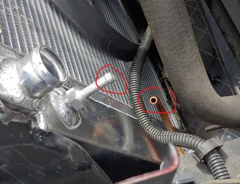

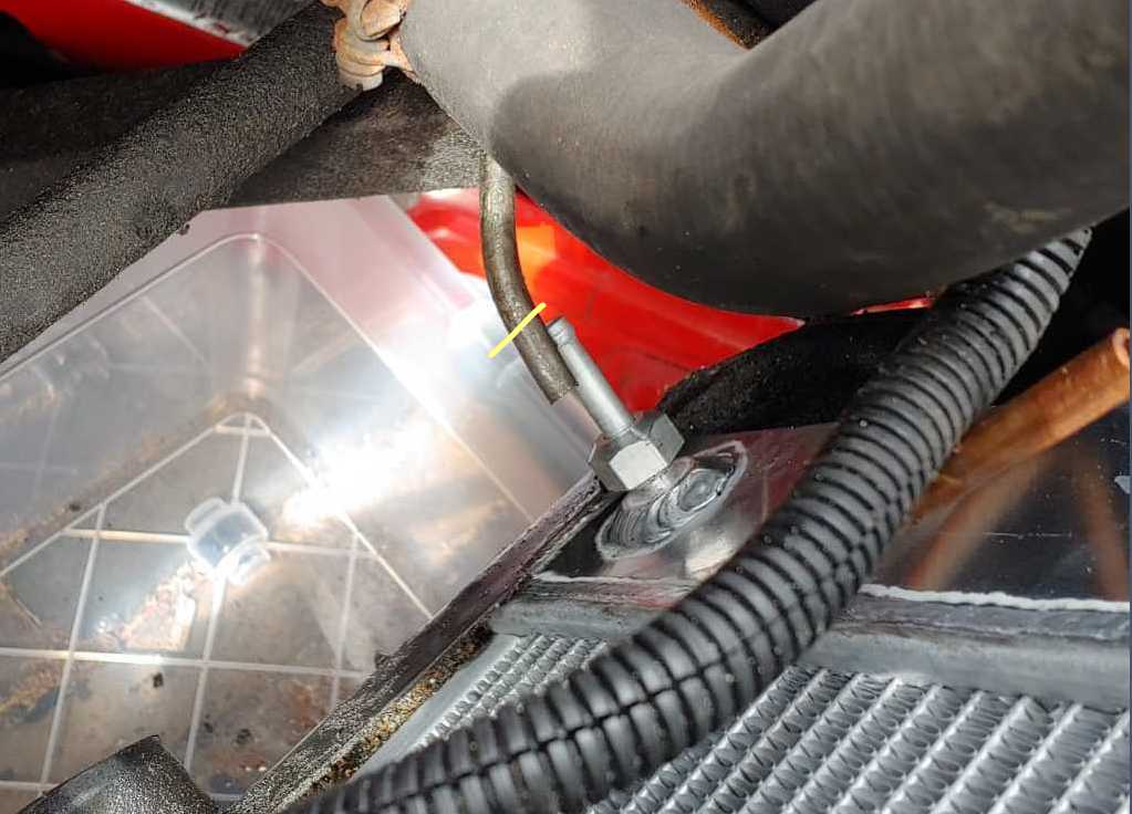

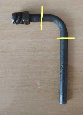

Back on track, the weather is clearing up here so I'm preparing to finish the job. I have three things left to do.
1) Connect lower transmission line That one is easy. I'll just cut the transmission line at the yellow line, then use a piece of transmission oil grade rubber hose to connect the two
2) Connect upper transmission line This one is going to be harder and I have a few concerns about this one. I need to connect these two:

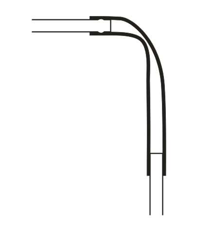

I cannot simply use a single rubber hose, since it will pinch:

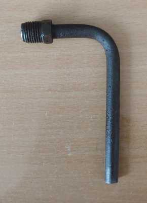

If the radiator would have the proper fittings, I would be able to use the original piece of transmission line:
So here's my dilemma. I can cut this piece up and only use the bend.
But that means I can't use that piece anymore if I ever choose to go back to a radiator with stock fittings. So I will have to find a piece of metal tubing with a bend of the right size instead. So not sure what to do here yet.

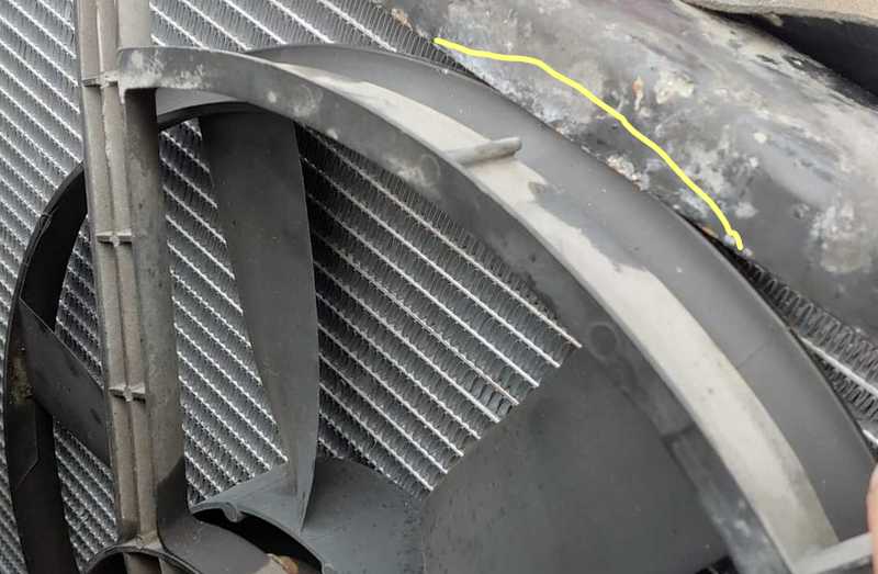

3) Making room for the fan I think I will trim away a small piece of the bracket:
So any tips before I start? 😊
