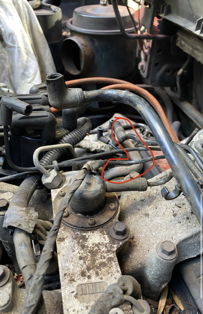

| quote | Originally posted by Rexgirl:
I am also wondering if your cold start tube (#5 in pic) is okay and not leaking? It connects under the throttle body and feeds the intake manifold.
See a pic from a few days ago when we took the plenum off. We checked, double-checked and triple checked for leaks or cracks. Everything around the engine looks real good. Wheres this cold start tube?

| quote | Originally posted by 72and86:
Pretty sure this is it.
also its not a cold start tube its the tube that feeds the engine so that it can idle while the throttle is closed.

As I understood, the tube I indicated supplies air to the cold start injector, so if it leaked a lean condition would happen. But maybe that was incorrect?
I've never heard it described as being there for that particular purpose.
As I understand it, air entering the indicated IAC port below is metered by the IAC valve and then passed through the tube at the back of the TB and into the intake plenum.
"Cold start tube"? Doesn't that tube supply air that's been controlled/regulated by the IAC valve?
