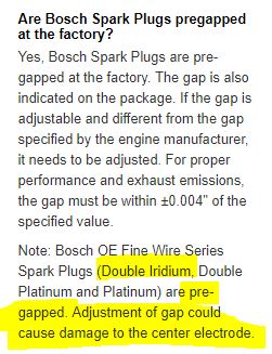

Cyls 1 and 2 don't look good. Looks like carbon fouling. Maybe you got some leaky injectors and are running rich on those cylinders, but I don't know.
I think the Bosch double Iridium are supposed to be preset at a gap of 1.3mm, which is about .051".

I was concerned about the gap too but this is straight from the bosch web site. I am running the Double Iridium plugs.
 While the intake was off, I took the time to clean each injector out .. Per the last owner, there was a time when a hose inside the gas tank caused the fiero to stop running . It apparently got all gummed up . I did manage to get a good jet stream from each injector after the cleaning.[This message has been edited by str8maxn (edited 09-01-2021).]

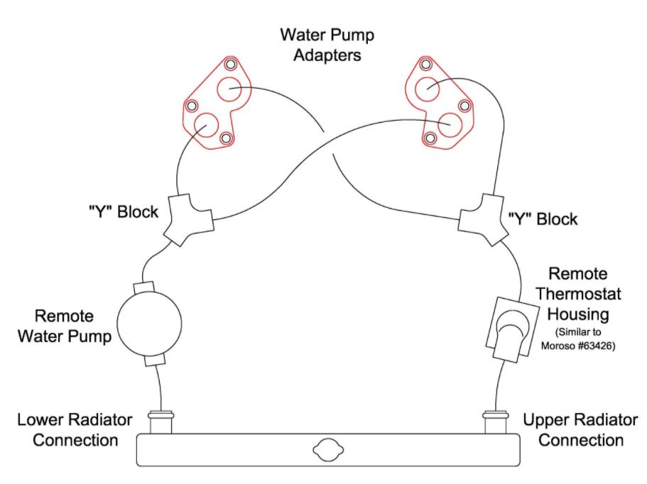

Is this what the routing for a remote water pump should look like?

In short, No.
I'll post a quick sketch shortly.
cyrus88
SEP 02, 07:56 PM
Here's a quick edit of your sketch: (This is with the CSR water pump)

If you got the controller from Germany you will not need a thermostat. The controller will pulse the pump to slow the water in the radiator so the fan can take the heat away. I set my temperature at 150F and it stays there regardless how hard I beat on the engine.
