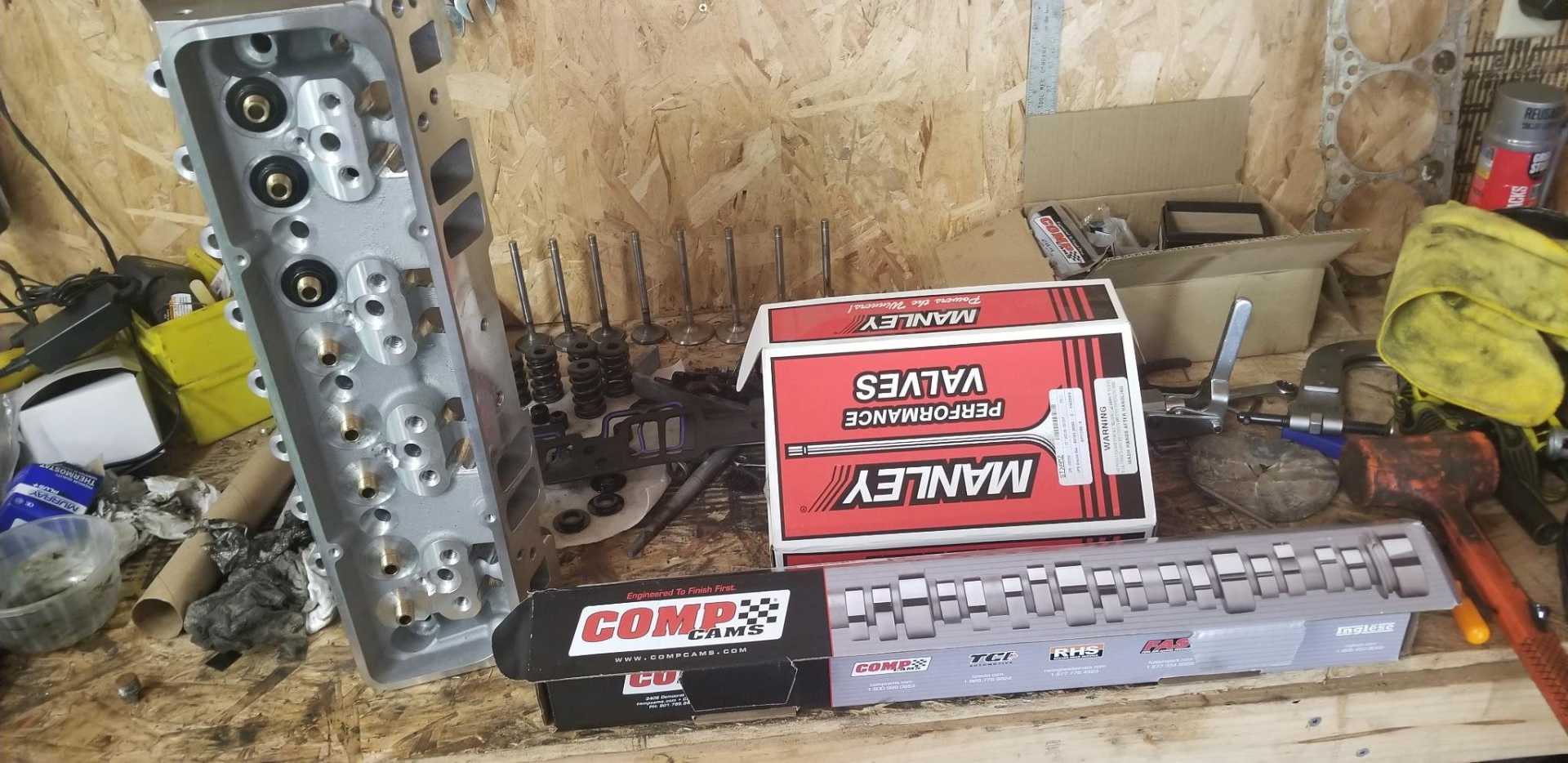

Still waiting on the shortblock to ship out. But parts are starting to arrive.
Because the previous owner ran self aligning rocker with guide plates, the valves were put into a bit of a bind situation. This resulted in the guides being worn a bit funny on each intake valve. I noticed this when I first put the motor back together and just crossed my fingers it wouldn't use oil... buuuut it did. Rather than send these off to machine, I bought new castings. $225 each on Amazon. I'll port the new ones very lightly (mostly just casting flash cleanup). Also bought some light, undercut valves.
I really weighed overcamming the car to soften low speed torque but ultimately decided against it. Since I have a 2D timing table available I'm going to attempt to use that to manage torque in the same vein as traction control on newer vehicles. I also have launch control available on the Sniper and may see what I can make happen with that. This guy should put power peak in the 6000 range. I will run it with the 1.6 aluminum roller rockers I currently have.

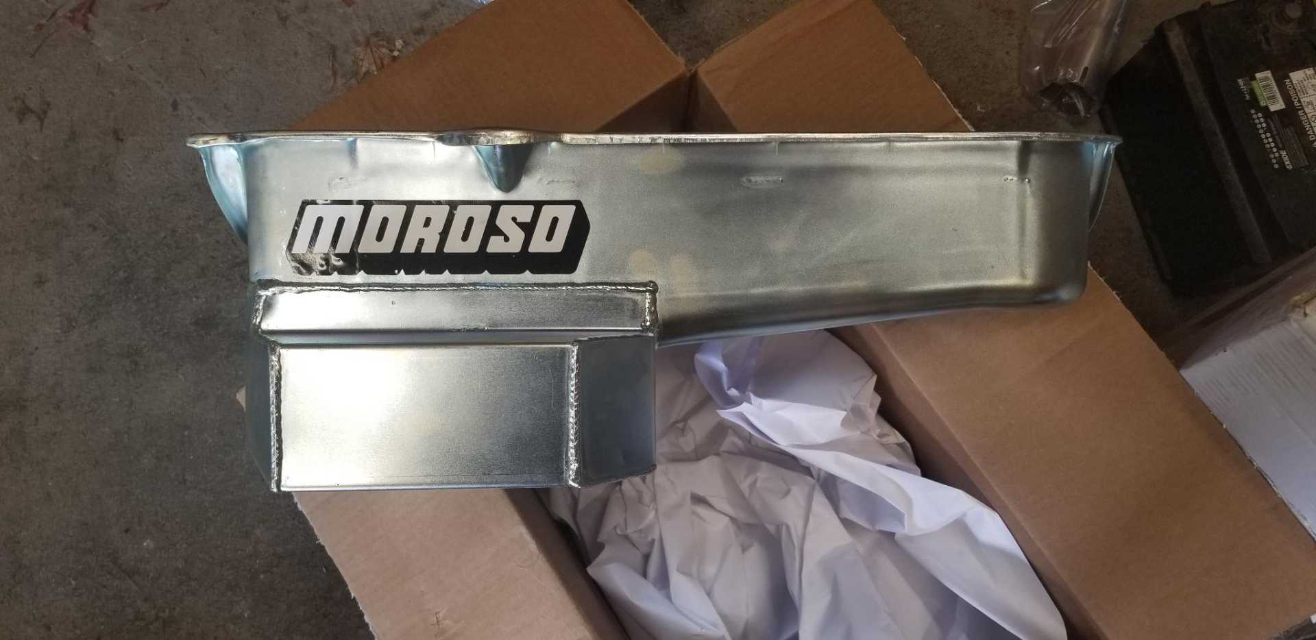

Having this in my hands now, I got the measurements I really wanted off of it, and it will clear the passenger side axle. Awesome! 7qts (+ .5-1 for the remote oil filter) will work nicely with the high volume oil pump I got.

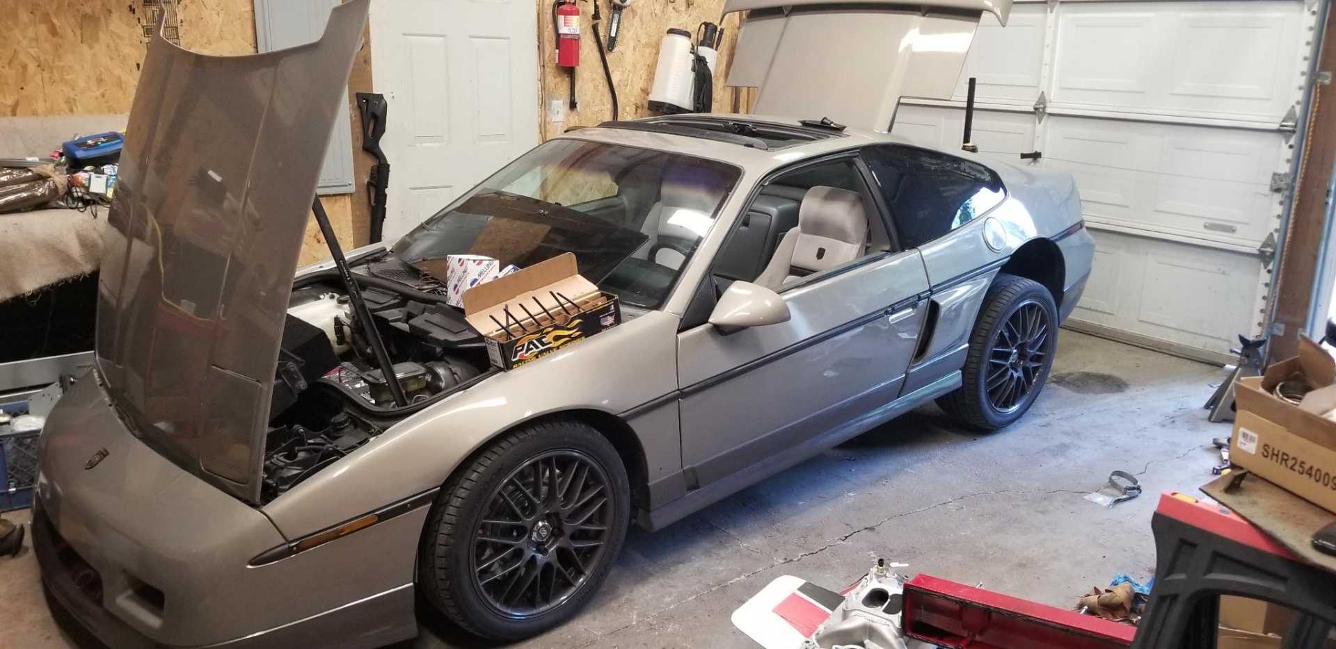

Today was a nice day. I should be driving this.
But I'm not - Because my shortblock hasn't shipped yet.

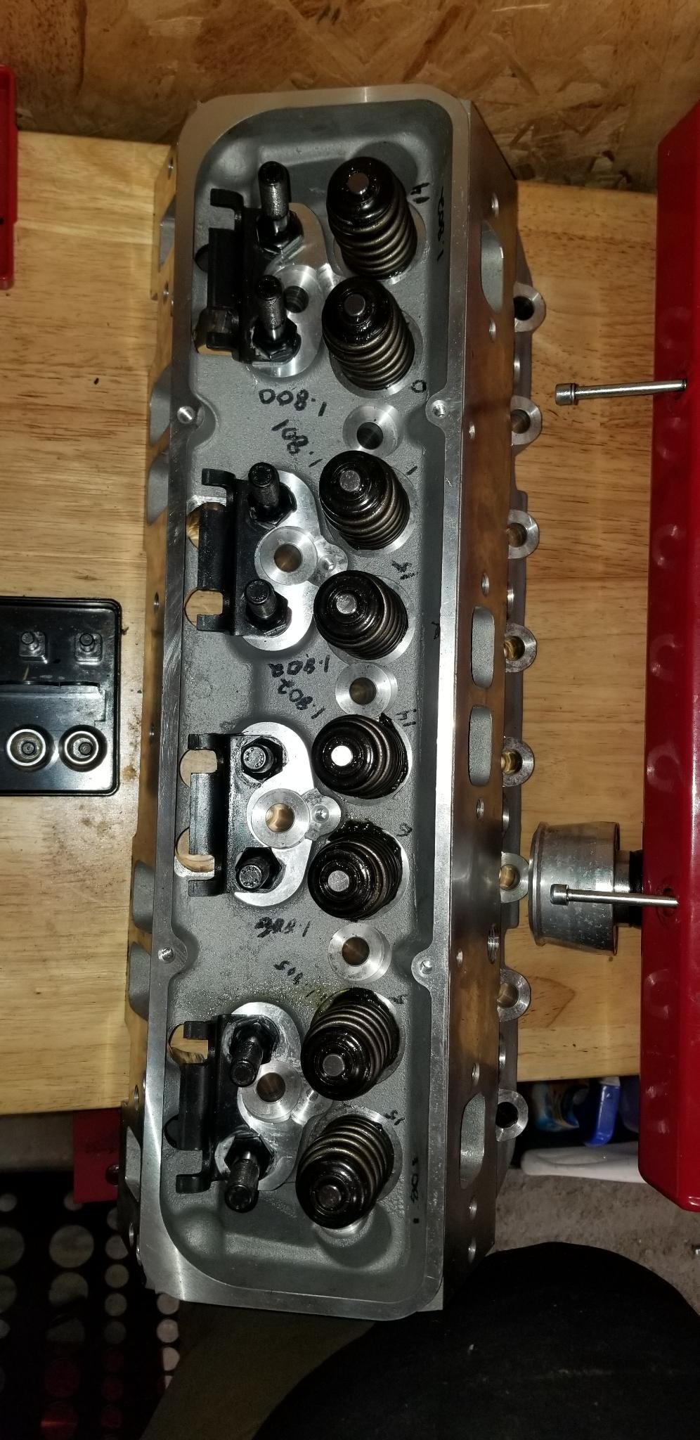

So I finished prepping and putting together a cylinder head instead.
Parts are piling up. Ready to get moving on this thing.
