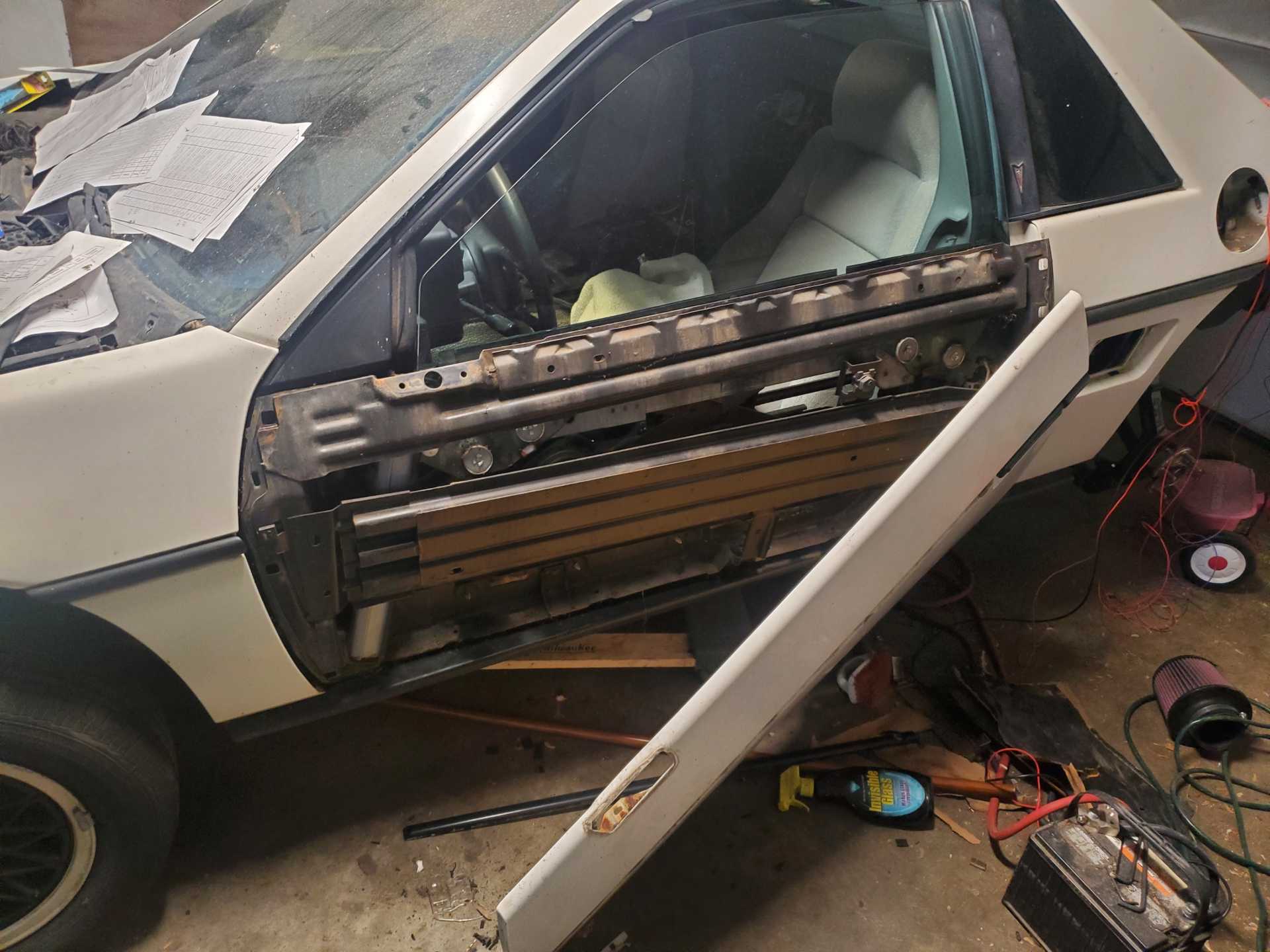

Figured I'd replace my driver side dew wipe while I wait for parts/axles. Sure as hell, all but one of the phillips rounded out. I dont know what they are made of but they were killing my Ti drill bits trying to get them out. So, onky way left was to take off the door skin and get behind them with some needle nose vice grips. I win.

For some definition of "win"?
Now you have to POR-15 all the door metal.[This message has been edited by Will (edited 05-10-2021).]

Haha, if I get what I originally wanted by ripping crap apart, I count that as a win
