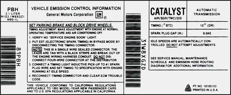

I found an emissions decal for a 91 Camaro 3.1 that doesn't have any vacuum lines or diagrams, whatsoever. Describes how to connect for diagnostic mode by disconnecting the timing lead. I assume that would mean the crankshaft sensor.

The allowed tolerance is +/- 3 degrees, so 7deg barely passes.
I've seen the shop I frequented poke their head into the cabin before checking timing, but I always bring the car in with that cover (and the engine vents) removed. If the cover was still there, I think they're supposed to open it but maybe some would cheat to save time. Is there still an EST wire on the 7170? Maybe some of them would look for that instead before checking AllData/etc, but the emissions sticker does say to use the ALDL jumper.
from the 1988 label that was posted earlier
GROUND DIAGNOSTIC CONNECTOR LOCATED IN CONSOLE (this is ambiguous but it points them at the ALDL)
NOTE: SERVICE ENGINE SOON LIGHT WILL BEGIN FLASHING
The flashing won't happen with 7730, and since it's mentioned here I think it could make some inspectors think the procedure isn't working, so gee I can't check timing you fail, or you have an ECM functional problem so fail, but I guess most of them would ignore that discrepancy and continue.
Timing on the 2.8L Fiero is also hard to read (I think so anyway) so I can imagine many of them give up and just write down a "pass" for the timing. They won't get into the habit of doing that though because an undercover car with incorrect timing is the kind of thing I bet BAR agents would try to catch them with.
If you ever want to tweak the timing, the best way to do it in California is to keep the distributor locked at 10BTC and make your changes at the chip. Changing the "distributor reference angle" value in the chip is effectively the same as moving the distributor, but it won't show up in the base timing. So the safer way of getting the car tested at a slight retard of 7BTC is to keep the distributor at 10, but set "distributor reference angle" to 13. That tells the computer the distributor is at 13BTC so it will add 3 less degrees of advance. It will still show up as 10BTC in diagnostic mode.
