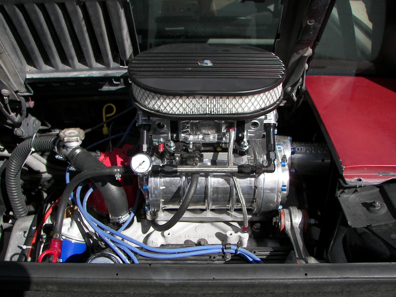

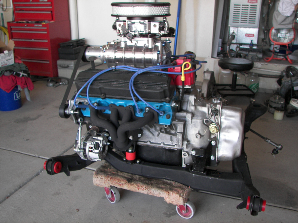

OCT 12, 11:52 AM
Looking forward to your build. This is a pic of mine. Cheers,
Good morning Coolkoolpyle,
John

Coolkoolpyle
OCT 14, 09:34 AM
| quote | Originally posted by Johns 4.9:
John |
What a thing of pure beauty!
The all aluminum V8 engine is exactly the direction I would take if I were doing a swap myself.
Too much weight in the back would undoubtedly create handling problems but this combo I would guess is absolutely thrilling to drive.
What were some of the difficulties installing this engine into the chassis?
Do you have any pictures of body mods you made if any?
Very cool.
