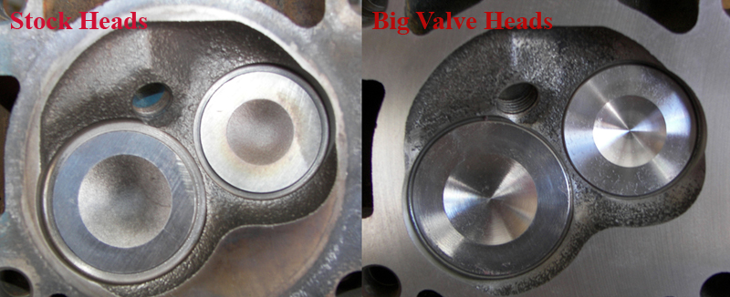

Share some pictures of you head work, please! although it was never a performance oriented motor, i do have a soft spot for "bad" engines made better.
Johns 4.9
AUG 15, 03:00 PM
I've done some head work. 1.94 and 1.60 stainless steal valves. Cheers

| quote | Originally posted by Johns 4.9:
I've done some head work. 1.94 and 1.60 stainless steal valves. Cheers |
John, both valves look about 2mm larger in diameter.. Am I close?

Johns 4.9
AUG 15, 08:53 PM
Stock 4.9 valves are 1.77 and 1.50. 4.3mm and 2.54mm increase. Cheers
