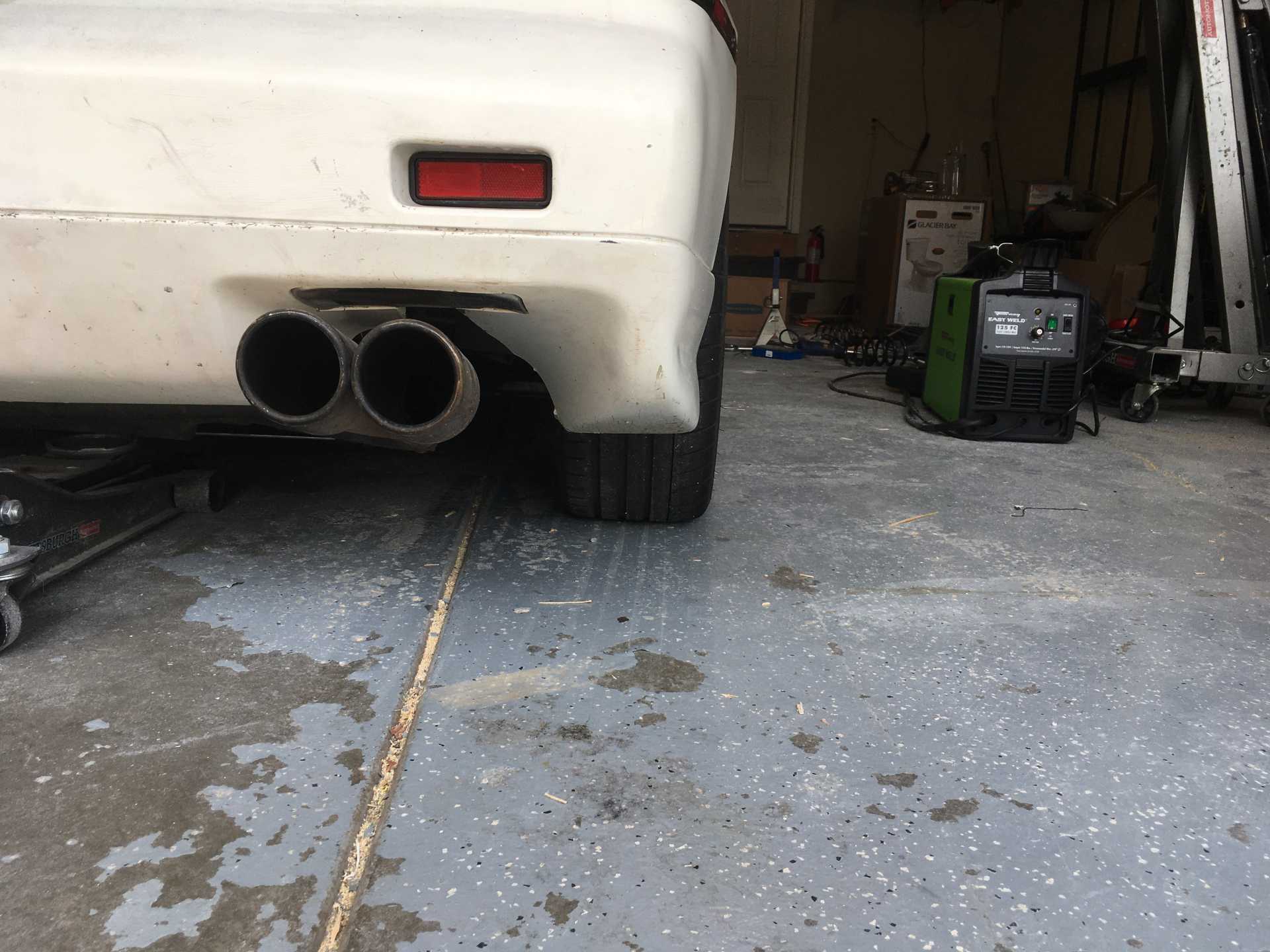

However, this is what it looks like in the air...
Threedog
AUG 15, 01:14 PM
This is what it looks like on the ground

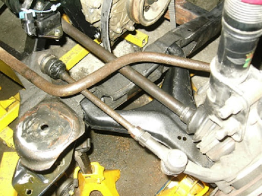

I was wondering the same. If I remember, the arms have either a L,R or LH,RH stamped on them.
ltlfrari
AUG 16, 08:55 AM
I was wondering the same. If I remember, the arms have either a L,R or LH,RH stamped on them. |
Yes, Also there's a tab at he end. The longer ear goes towards the rear I believe (picture stolen from another thread).
