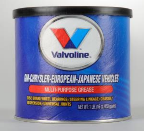

I just realized I might have used the wrong grease to pack the bearings. I used ordinary bearing grease with a dropping point of 375F. I'm guessing that's too low. I'm going to get special automotive wheel bearing grease before I start on the driver's side.
If I decide to repack the wheel bearings on the passenger side (and I'm hoping to get some advice if it's really necessary), I'll have to remove the rotor again. I was wondering, will I destroy the inner seal if I do? Will I need to get a new seal? And what's the best way to clean the bearings and remove the old grease?
RWDPLZ
OCT 02, 08:48 AM
The grease I always use specifically says 'wheel bearings' on the can or tube, and is rated to 400 F, so you might be fine, what did you use?
I usually use this or Lucas Red 'n Tacky
If you end up re-doing it, a bearing packer and a grease gun would flush out the old grease.
