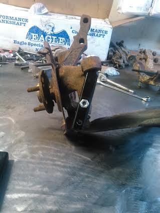

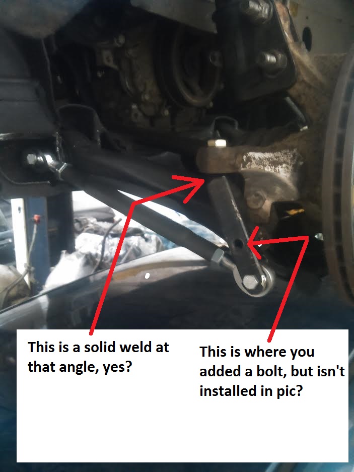

Trying to wrap my head around this as a newb. Thank you for the tutorial and hope I understand this.
1. The top of the tube has a nut welded into it that the bolt through the tie rod hole threads into.
2. The hole was for a long bolt that I used as the lower ball joint pinch bolt for the trial fit. A nut was welded into the end of the horizontal tube so that the regular pinch bolt can hold the tube in place.
The long bolt allowed me to adjust the angle of the vertical tube. Once I was satisfied with the location of the outer toe link hole in reference to the centre of the lower ball joint, I tacked the top nut in place. I then took the long bolt out and welded the pinch bolt nut in place and finished the weld on the top nut.
Here's an end view showing the alignment of the outer toe link hole with the centre of the lower ball joint. The angle was quite close to what I was hoping to see, making for a fairly simple piece.
[This message has been edited by mender (edited 05-27-2020).]
