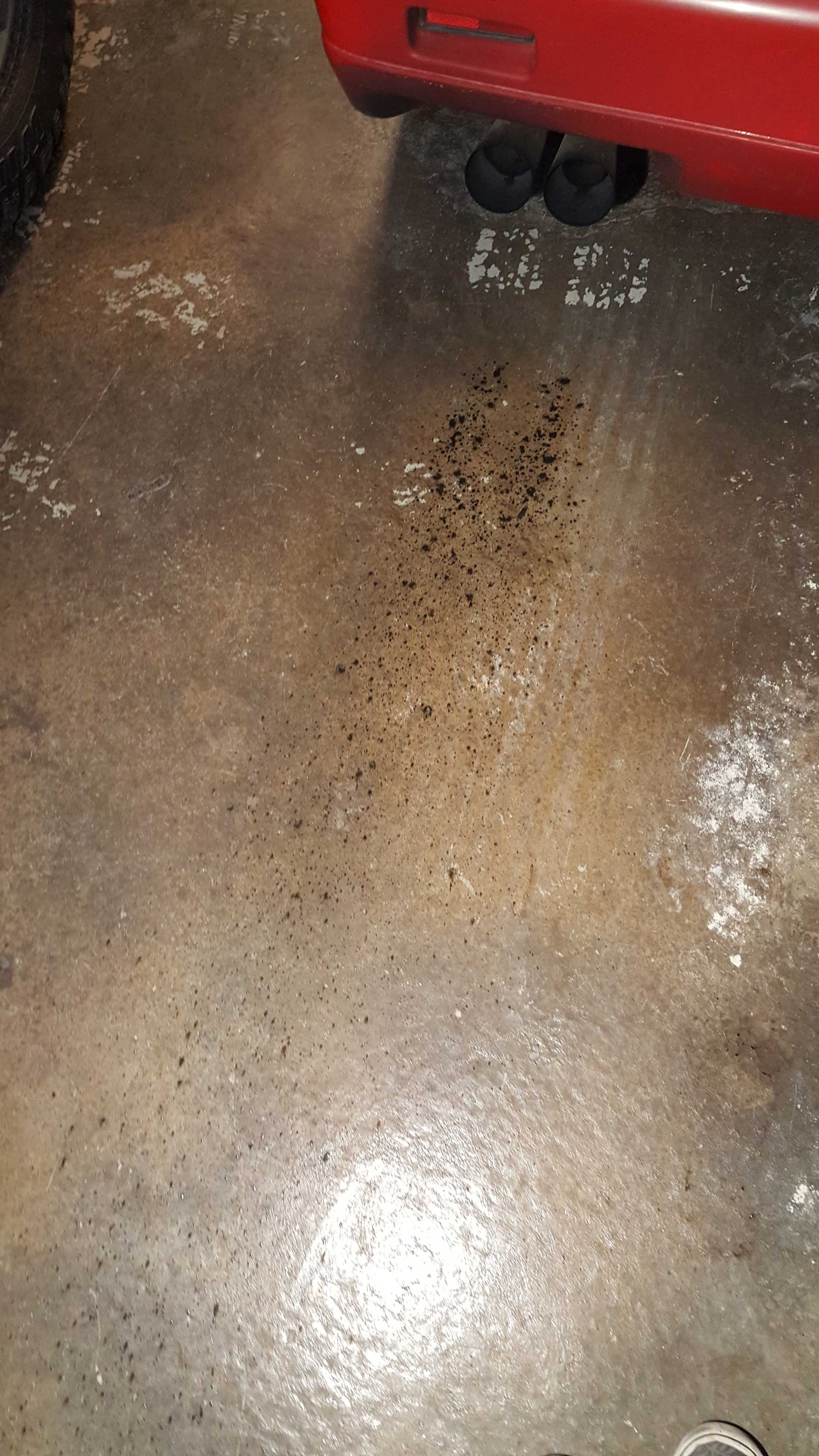

Also don't know if this would help but whenever I start the car it spews this out, cats gonna and it's still doing it?

Is that water, fuel, or oil?
I'd pull the plugs on the trunk side and see if they are fouled with soot. If they are then, it may be a fuel injection issue. ------------------ Mike in Sydney

| quote | Originally posted by Mike in Sydney:
I'm 90% certain it's water, and I'll check those and the injectors tomorrow and let you guys know what I find, also I really appreciate the help with this, wouldn't be able to do it on my own😂

| quote | | I'm 90% certain it's water, |
If it's water, chances are it's condensation . Does it happen every time the car is started or only after it's been sitting for a while and the car is cold? If it happens every time the car is started whether hot or cold then it could be serious. If only when it's cold, I'd guess it is condensation from the atmosphere------------------ Mike in Sydney
Every time car is started
