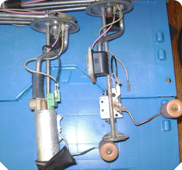

You folks are talking about a short rubber hose inside the fuel tank. I just looked at two of my fuel sending units that are sitting on the work bench. I didn’t see any rubber hose. The fuel pump connects directly to the “gascolator” with a plastic tube on top of the pump and then exits directly into a hard metal line. Was this a different set up on later year Fieros? The cars I’m dealing with are 88s and one 87. All V6.

| quote | Originally posted by fierobear:
Are you referring to the "pulsator" which originally came on all(?) years? From my understanding, replacement fuel pumps didn't require this device... hence the use of the short submersible hose instead.
Found a good description and picture Here.
Yes. Thanks for the info. I’ll read through the linked thread.

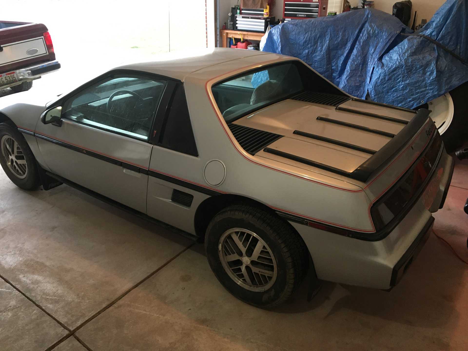

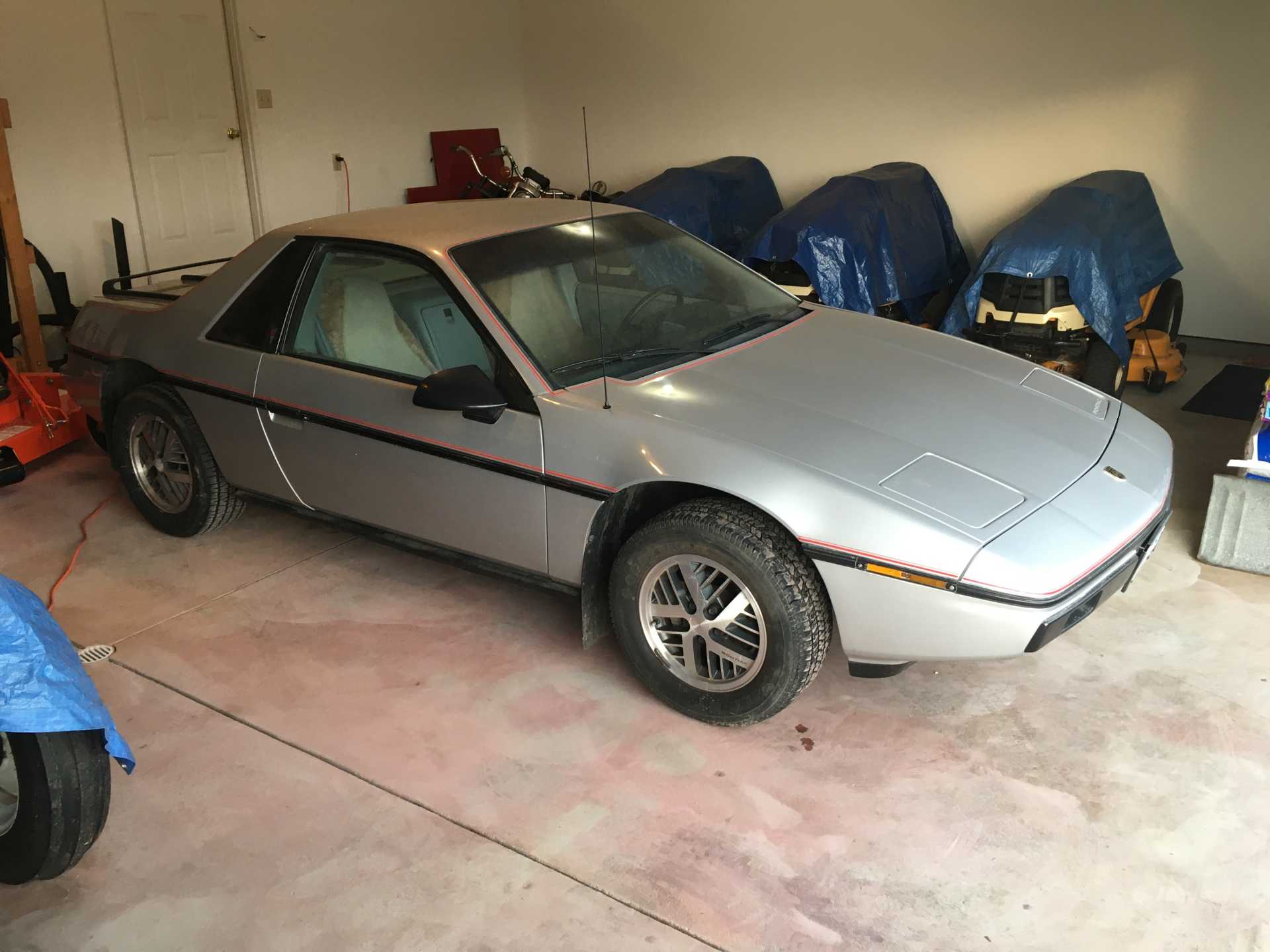

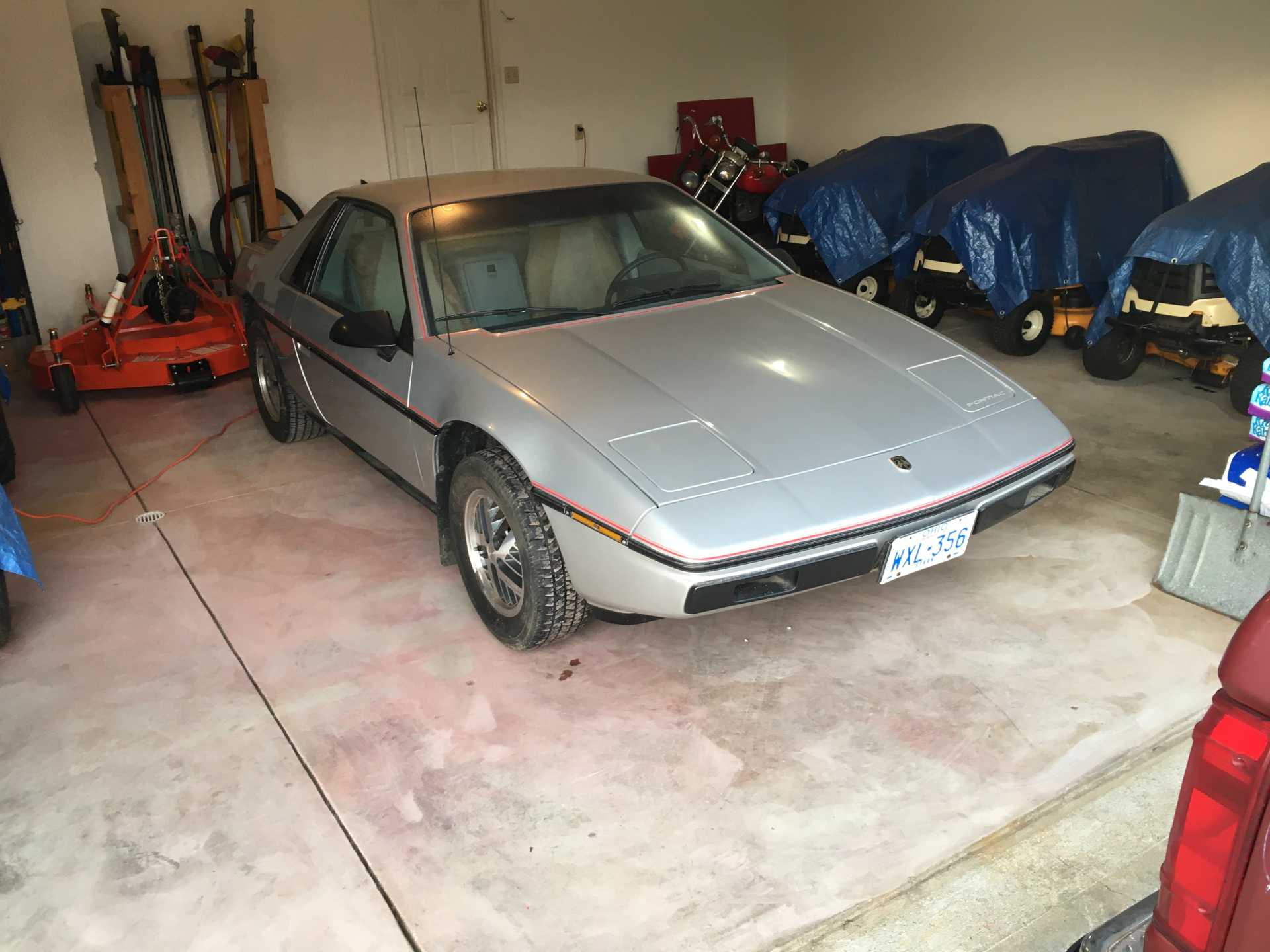

This is my Fiero. There are many like it, but this one has been mine since the day it left the dealership. The front tires are OEM and in great shape. I had to replace the rears as they were not only showing wear, but they were dry rotted, cracked and the RR wouldn't even hold air. I'll keep a close eye on the fronts, just for safety's sake. The poor thing is still filthy. Time to get to work detailing the exterior. Spring is right around the corner...right?!
JAN 22, 05:28 PM
| quote | Originally posted by CampyBob:
Bob, please read what I posted Here. You may wish to re-think continuing to drive on those ancient tires!
The car looks great. I like the pin-striping.
