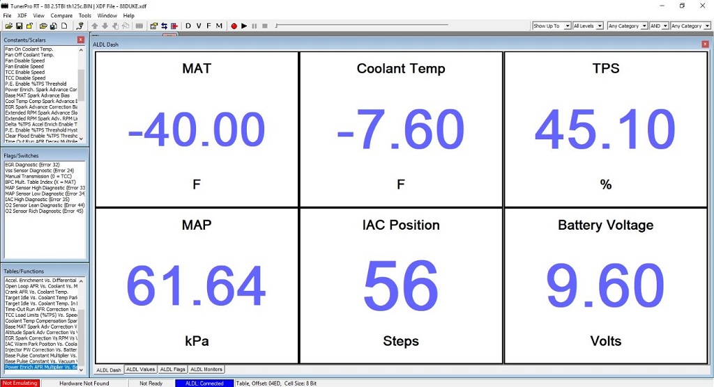

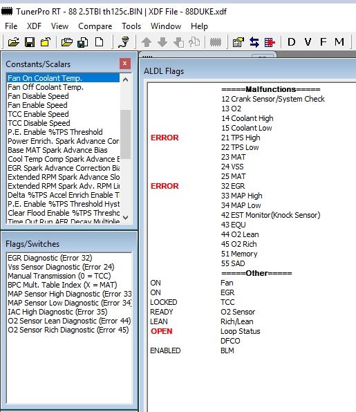

OK, finally got my diagnostic kit & cable. Thought I had figured out TunerPro RT with the $48 definition file, but I don't trust myself and obviously, some of the readings don't make sense. I measured voltage with a DVM directly at the terminals and had 13.6 V! Perhaps some of you can tell me what I am doing wrong. Here is a screen-shot of the ALDL dash and the ALDL flags.
I also have the CSV file.
BTW-Idle is still hunting, matter of fact, getting worse..........thought I was on the right rack.  HELP!

ECM is telling you it reads 9.6v and likely why you have hunting idle.
You read V w/ DVM on what terminals? at battery? doesn't mean much there. Power, grounds to ECM still have problems as I posted above or ECM itself is "bad."
ECM has 2 power feeds. One directly from the battery, other from ECM fuse. Either/both can have problems. To start, Check every wire to the "box" under C500.
I would carefully unplug/plug both connectors on The ECM a few times too. Even tap w/ fingers on ECM and see if numbers change if true then likely ECM is dying.
MAT and Engine Coolant that low unless local weather in cold there but I don't think is -22°C right now. MAT can get colder then weather because is downstream of TBI w/ petrol getting on it but engine mush be cold. Engine hot MAT easily sees 150°F at idle even in cold weather. MAT also gets wide swings of temp as you drive too.
