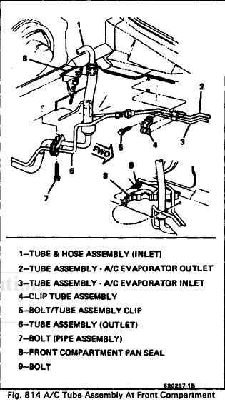

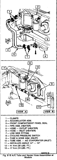

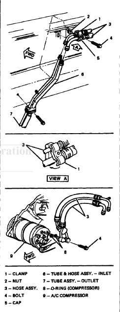

Attempting to count up the hose/pipe connections in the A/C system:
1 - Connections at the compressor
2 - Connections at the firewall below the air cleaner
3 - Connections at he dryer
4 - Connections around the orifice
5 - Connections at the evaporator
6 - Connections at the condenser
Are there any connections or couplings that I missed?
