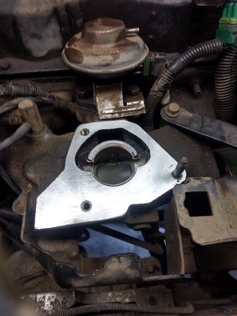

When I rebuilt my TB the entire EGR passage was plugged.
JMTUT
JUN 24, 01:02 AM
This is what it looked like after cleaning.

I think maybe Today I will pull off the TB and look at the EGR tunnel under it. It's Never been Off as far as I know.
