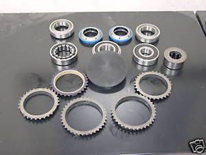

Example:
eBay - MUNCIE 282 FWD FIERO REBUILD KIT for US $89,95
Sellers reply about included parts:
| quote | Hallo pat.moar88,
2 AXLE SEALS DIFF CARRIER BRGS (2) pictured next to seals on each side front output bearing input bearing/seal (for 92-up only) older models - NLA rear c/s bearing mainshaft brg shift shaft seal (not pictured) rings (5) cover
all bearings pictured (6 total)
- mantrans |
Obviously not a complete kit, but anyway it´s a good price I think and sufficient in my case (hopefully).[This message has been edited by Moar (edited 11-02-2015).]
