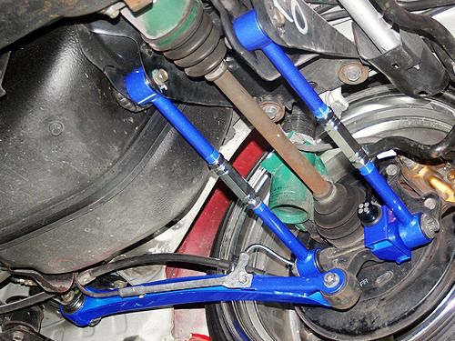

I was browsing the web and found that early wrx sti rear suspension is virtually the same as the 88 rear. What about using the wrx uprights to gain better bearings in the rear? I'm not sure what the wrx axel spline count is, but I'm sure you could mod the fiero axels to work. Other things that would need to be worked out are strut length, swaybar mount, and possibly modifying the trailing link mount. The lateral links look pretty close. Of coarse the bolt pattern would change, but could possibly redrill the hubs back to 5x100. The wheel offset may also change. If I run across one in the junkyard I may grab it too see if this is feasible. Here are some pics of the wrx stuff.

After further reading I have found that the wrx rear bearings are no better then the 88 fiero's. However, 2005 STI's use basically the same upright, but have an upgraded bearing. The WRX has 5x100 pattern hubs, the STI has 5x114.3 pattern. Some discussion here: http://forums.nasioc.com/fo...thread.php?t=1591652

I have also realized that the STI has a small drum brake inside the hat of the rotor and serves as the parking brake. This could be a problem to overcome. Perhaps the whole assembled could be eliminated by using the fiero calipers? [This message has been edited by Bridgetown (edited 02-08-2016).]
FEB 08, 02:20 AM
| quote | Originally posted by Bridgetown:
Is the drum parking brake necessarily a bad thing?
