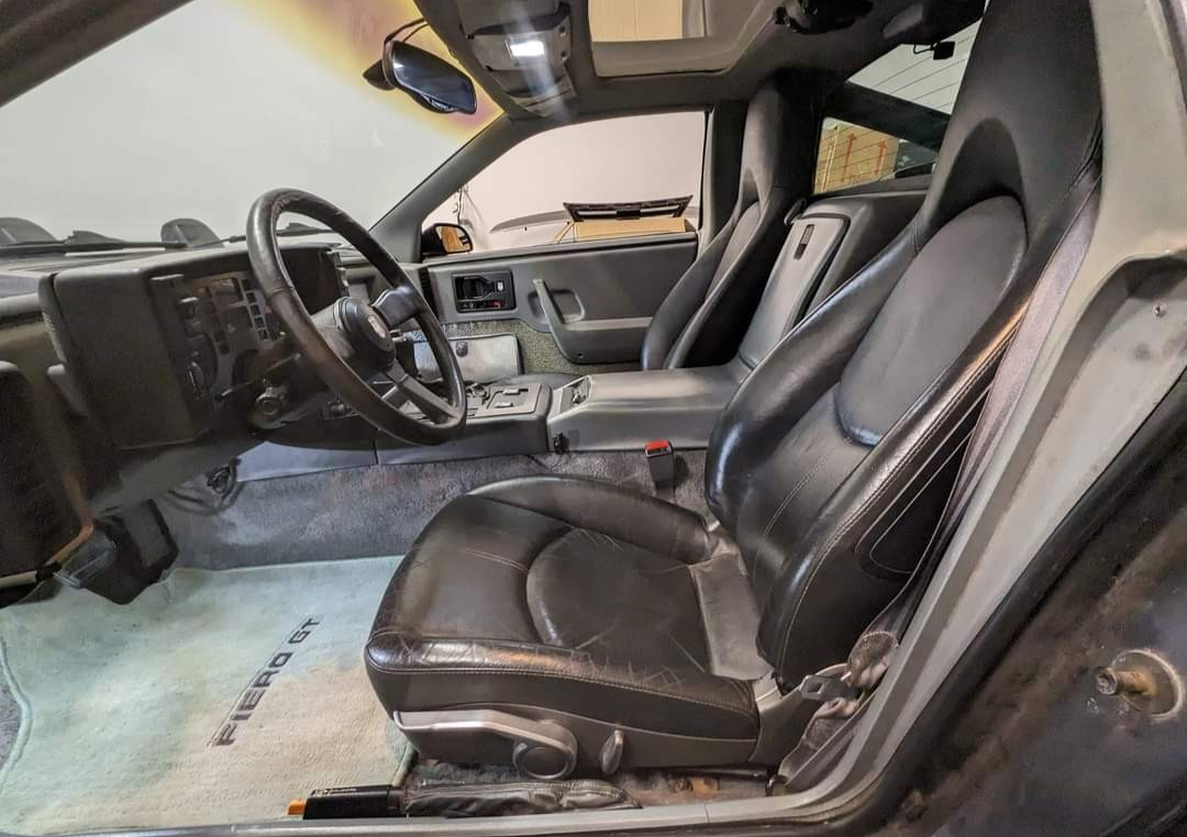

987 seats work fantastic and they are power recline. You get maybe an inch or two of adjustment but it's enough.
