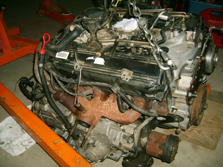

josef644
APR 26, 05:39 PM
Here is a picture of it, I didn't know the number of it,or on any of my two printouts from Fiero Addiction, or this thread. They call it "Engine to Dash Connector Mating Side".
I took the picture from the other guys thread. http://www.fiero.nl/forum/Forum2/HTML/100076.html Joe[This message has been edited by josef644 (edited 04-26-2009).]
Fieroseverywhere
APR 26, 11:30 PM
| quote | Originally posted by josef644:
That is the caddy C225 connector. I used it as a quick connect for the engine harness. I still used the fiero passthrough for the firewall. When pulling my engine out I just disconnect the C225 and don't have to touch anything in the interior. I have a pinout for it though I believe there is also one on the fieroaddiction site. The pinout will only help so much if you decide to use it. You will still have to connect some wires where there are empty spaces (use the pins from the unused wires). It was more work during the install but should save time during maintence and repair. You can also use this instead of the fiero passthrough if you are willing to trim the firewall for clearance.
Option 2: Cut the wires on the engine side of this connector, feed them through the firewall, connect to PCM connectors and C203. Cleaner looking install if that is what you are going for.  [This message has been edited by Fieroseverywhere (edited 04-26-2009).]
