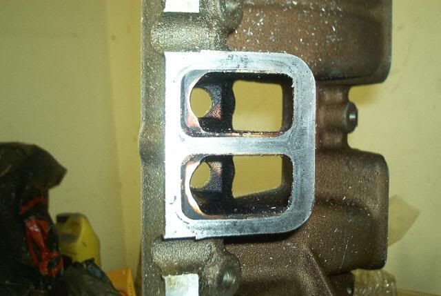

Hudini
JUN 07, 05:33 PM
Personally, I think the lower intake has restrictions. I say that because I measured each runner versus the middle and upper intake. The smallest part of the 3 intake's runners is right where the fuel injector sits. Their is a slight dip in the runner to compensate but still not enough. Here is a picture:

Will
JUN 08, 06:08 AM
Intake runner taper is a good thing. Did you compare to the port size in the cylinder head? GM probably wanted to get high velocity at the injector to improve atomization at low throttle.
I'm perplexed by taking height out of the interface between the middle and upper manifolds... that just makes the attrocious 135 degree bend the air has to go through that much tighter.
