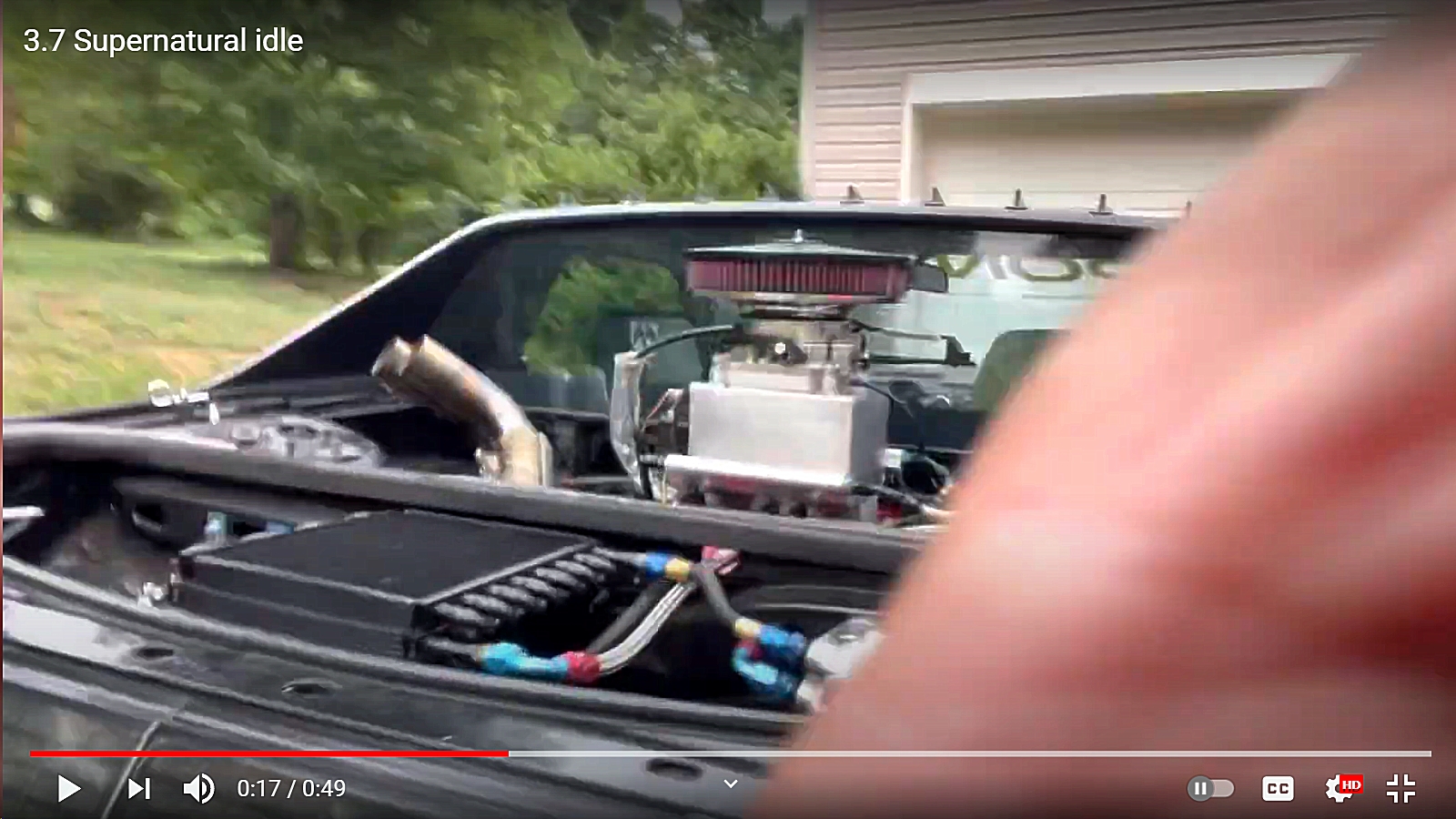

https://youtu.be/j0BYoie0d-M
Idle tuning is done! Only took me one hour or so to get it where I wanted it. My neighbor from around the corner came to my driveway with his grandson clear an argument they had about what was making that sound. The grandpa said "it sounds like a chain saw" and the granson said, "No grandpa, it's a muscle car". So, they had to come to my house to find out. Grandpa was very impressed, "that little thing is making all that sound?" Were his first words when he saw the engine compartment. We chat for a while, they took pictures and I found myself another Fiero fan, the grandson! He wants a Fiero for his first car!

No, turns out grandpa was a racer back in the 60's and he loves tunnel ram intakes. He was really impressed with my intake. The other thing that he was amazed by was the change in engine sound from idle to hi RPMs. I don't know if you've seen the video where I take the car out for the first time. The people I sent that video to had different oppinions about the sound. Some said it sounds like a rotary, others said it sounds like a two stroke, others said it sounds like an F1 car from the 70's and my brother said it sounds like a Group B Rally car from the 80's. The one thing I get from those feedback is what I'm after, one unique engine with one unique sound that no one has.
