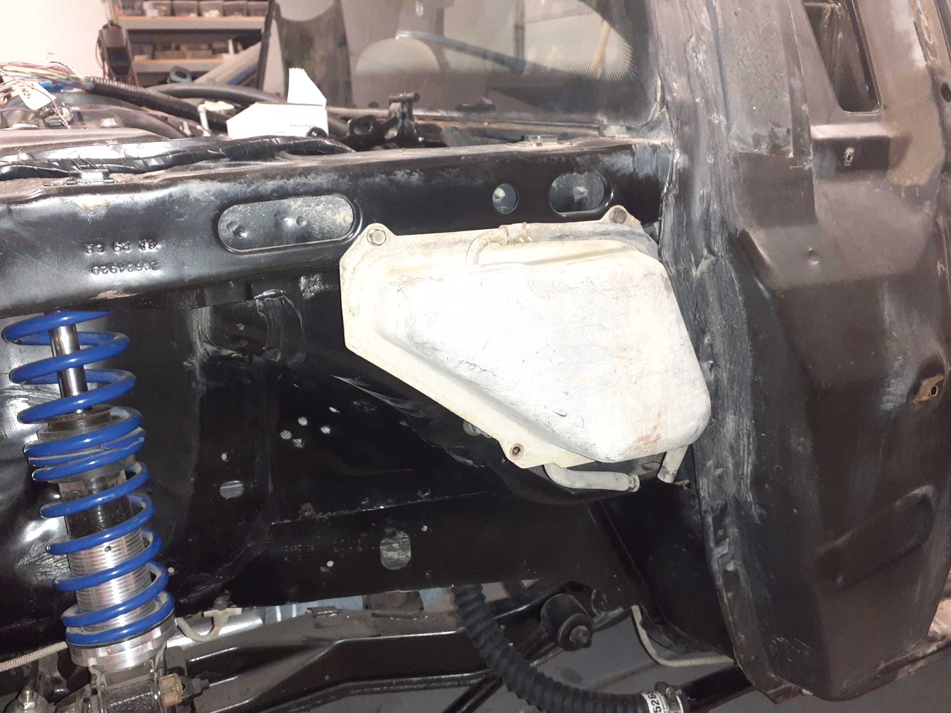

Daryl M
JUL 23, 03:44 PM
| quote | Originally posted by Will:
On '87's and '88's, the vent from the fuel tank is supposed to go to the expansion tank between the right frame rail and the right quarter panel. IIRC, there's another connection on that volume that goes to the filler neck vent and/or purge system. |
Will, is this the tank you refer to the one in the photo? If so, I assume the vent from the tank goes to the bottom fitting and the top fitting goes back to the purge valve. Does that sound right?
Daryl M
JUL 23, 03:47 PM
Will
JUL 23, 04:39 PM
That's the one. I've actually never had a Fiero rear clip off, so I've never investigated it to that extent.
