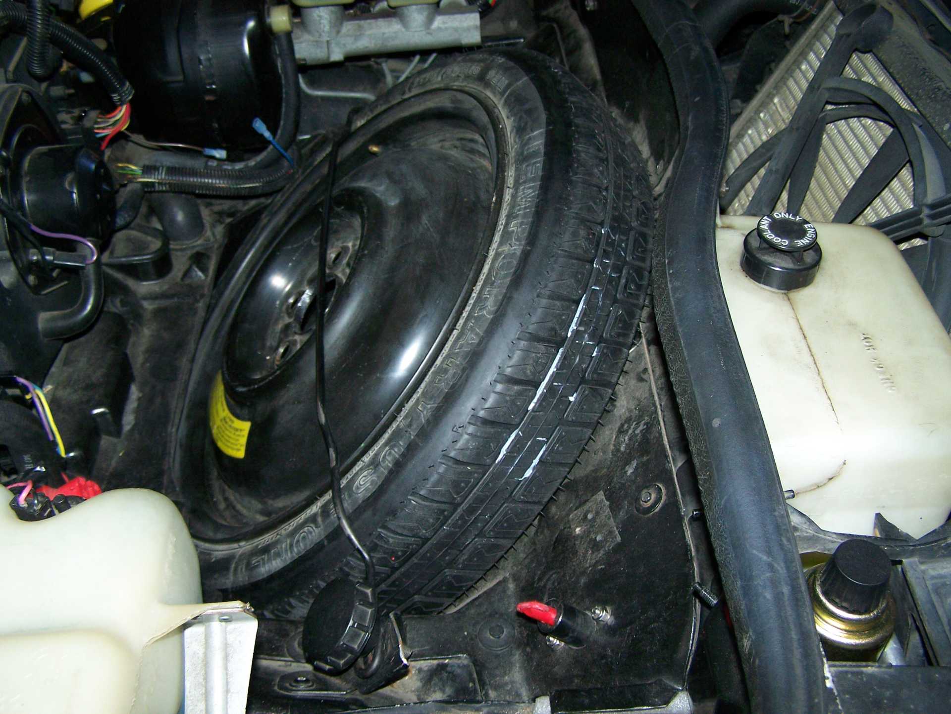

In reading the beginning of this thread, Phil stated that he removed the 12" Vette discs because he didn't want to carry a 16" spare wheel up front. Somewhere I read that a Fiero guy came up with a fix for this situation; The spares from certain Subarus (Around 1996)use a 16" wheel...they will fit over a 12" brake setup. The hub hole in the middle needs to be routed out slightly and the wheel/tire fits in the spare well NOT taking up any excess room. Tire size is 115/70-16....This allows you to have 12" discs and a normal spare.
As an added note, I have my battery mounted up front and the tire fits over it and locks in place as normal.
