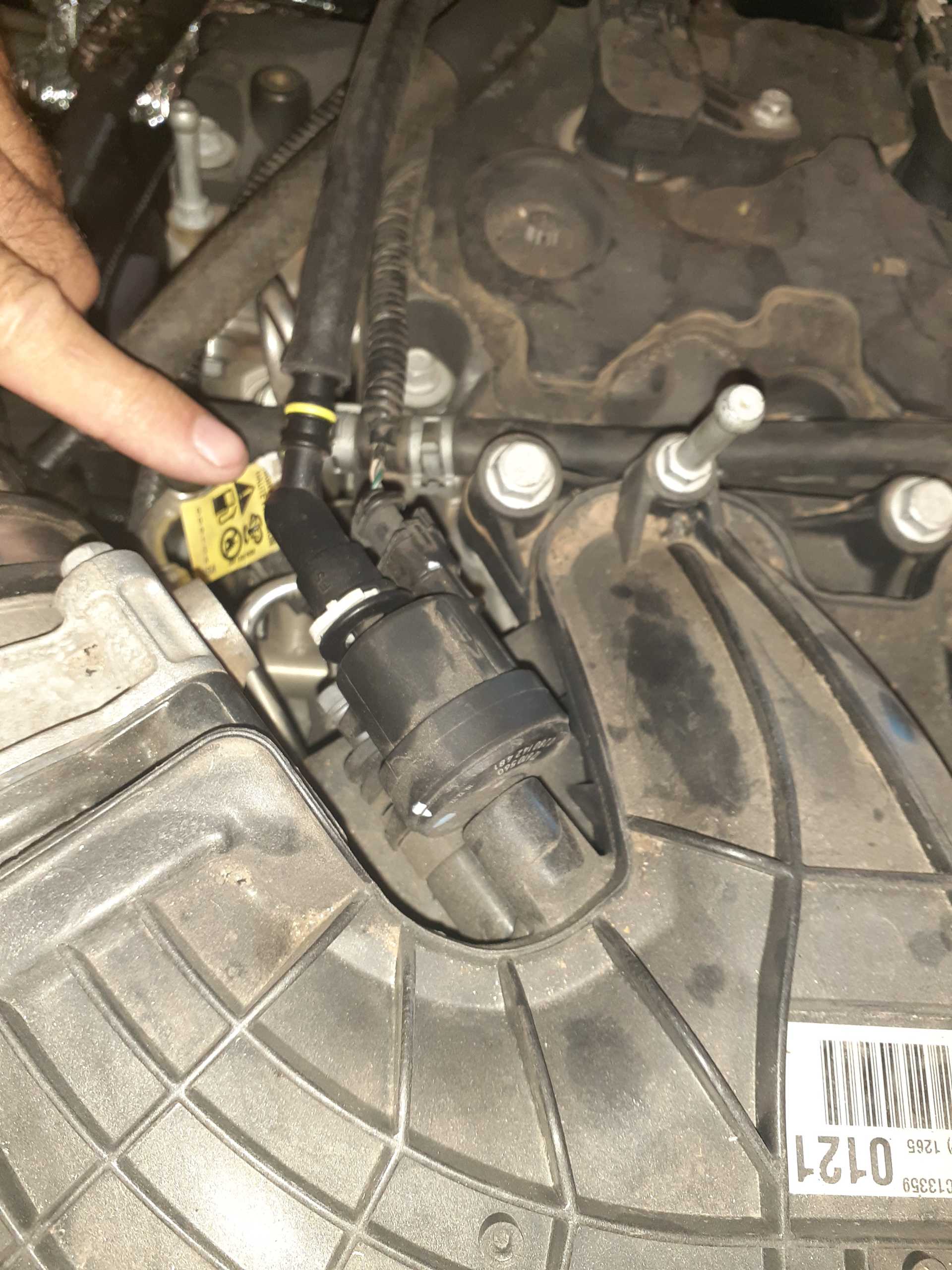

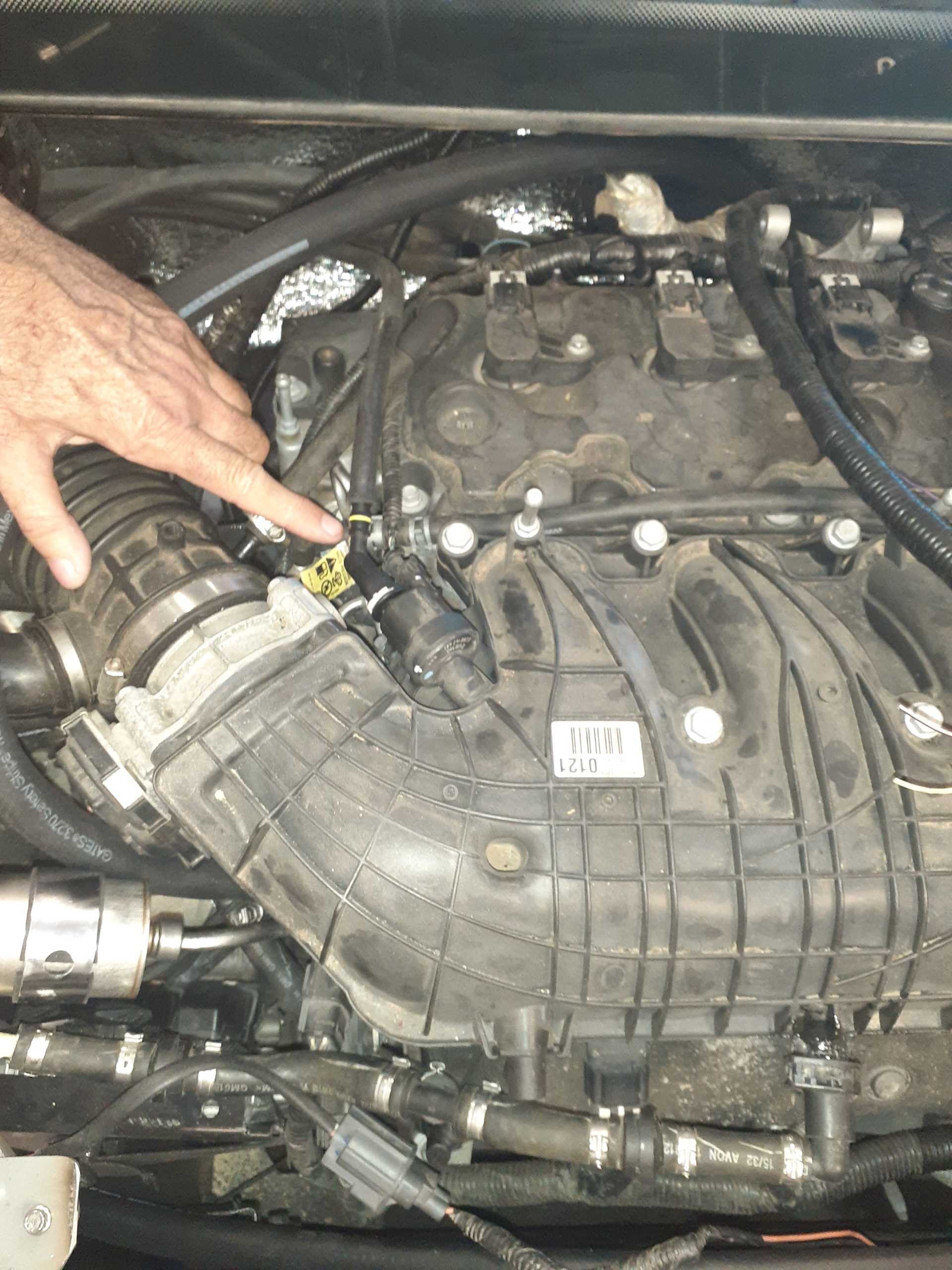

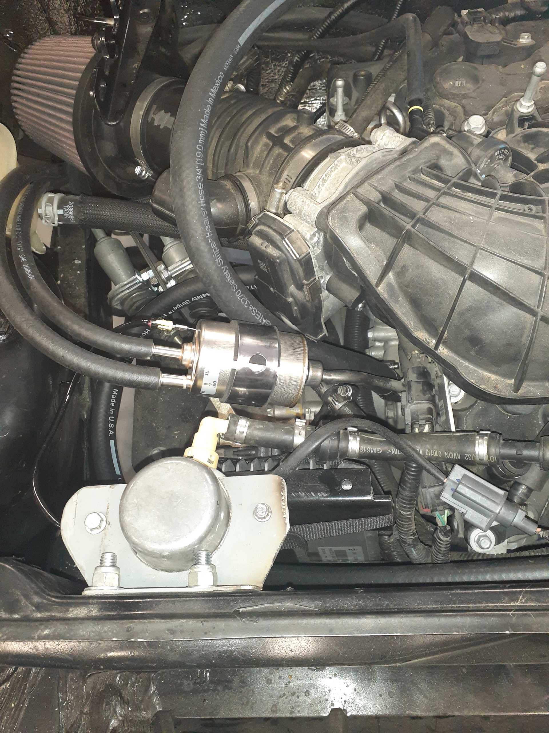

Next question, I am running fuel lines from the tank. I assume the fuel feed and return go to this LS swap filter I got from Jegs, but I am not sure about the tank vent. I'm wondering if it goes to the device hooked to the intake , (see photos)? This is standard on the LFX motor, but I'm not sure what it is or what it does. Any help is appreciated. Thanks, Daryl

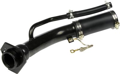

 This is the Fiero Filler neck, the vent line from the tank goes to the small line on the filler neck.

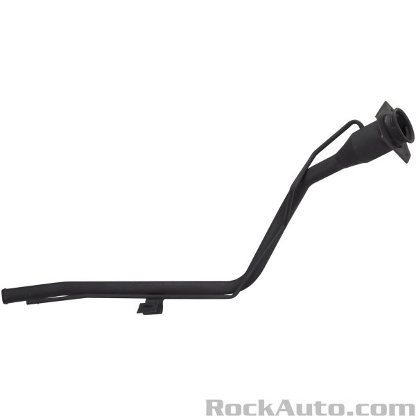

This is the impala filler neck, it too has the vent line on the filler neck. so I am guessing that the vent line still would go to the filler neck and not to the EVAP.
I am not sure how to incorporate the EVAP system in this way, possibly do an EVAP delete? Or possibly try to Tee off the vent line? If you do not use the filler neck vent line it will need to be sealed off so that it is not a vapor release point / spill point.[This message has been edited by ChuckR (edited 07-22-2020).]

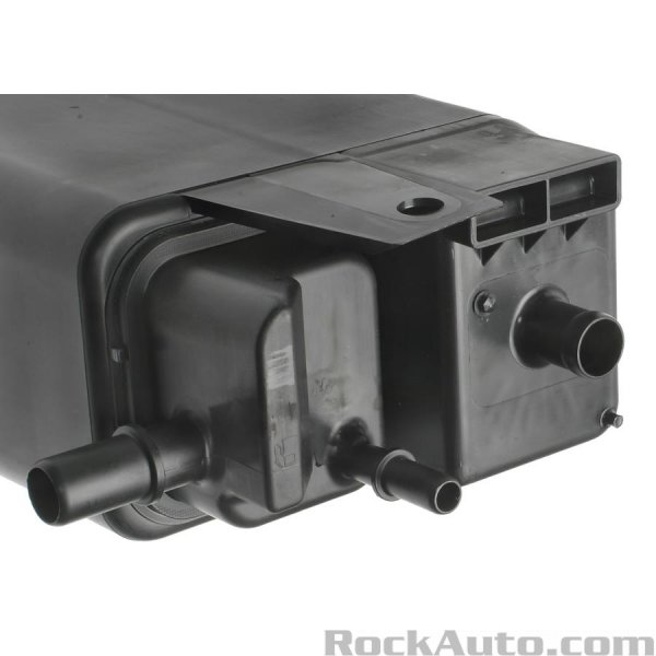

ChuckR I realize that there is a vent on the filler neck, but there is another vent . According to Guru, it goes to a charcoal canister. What I am trying to determine is where it goes from there and if the canister can be deleted and the vent can go directly to the device pictured. I think it is called a purge valve. The second photo shows the vent I an referring to. The first photo is the purge valve.

Yes that is the solenoid purge valve for the EVAP system, it does go to a canister.
I am not positive but the vent line should go in to this, have one line go to the EVAP solenoid, and one line go back to the filler neck vent. This is a guess, but the system needs to be closed. Or like I said above do an EVAP system delete, and when you have the ECU tuned have it ignore the EVAP codes and run the vent straight to the filler neck.
